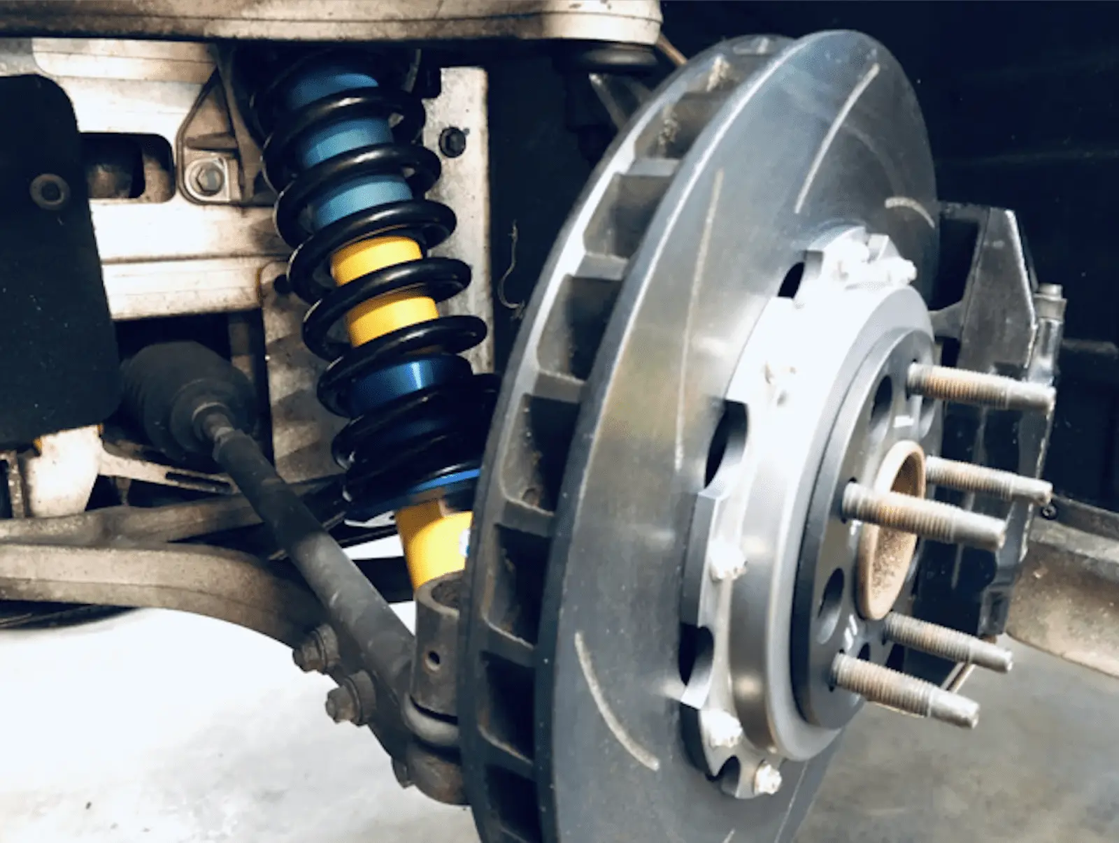

I think he was talking about lowering cup kits. The Evora has the same dampers (in terms of dimensions), so the cups will fit the Emira as well and do the same thing (lowering the car 18mm or so). I think they are also a good option for small money and don't change how the car behaves. It just sits lower on it's standard component. Way better than changing the springs.

The inners don't count when talking about lowering cups ;) They just make the springs have less tension and therefore the car sinks down a bit, until the springs have their tension back. of course the dampers are a bit more compressed then, but that doesn't change the characteristics. At least not to a point that you can feel. We are talking about the blue thing below the spring:
The standard cup would look the same, but is a bit shorter, therefore the spring sits higher, get's more compressed and lifts the car. Those aftermarket cups are good for 3/4 inch or 18mm, I just looked it up. Here is the link: Evora Lowering Cups
The inners don't count when talking about lowering cups ;) They just make the springs have less tension and therefore the car sinks down a bit, until the springs have their tension back. of course the dampers are a bit more compressed then, but that doesn't change the characteristics. At least not to a point that you can feel. We are talking about the blue thing below the spring:View attachment 3444

As I said, it is completely irrelevant how the inners of the dampers are set up, because the lowering cups don't change anything, neither to the dampers nor to the springs. They just put the plate where the spring sits on to a lower position. Due to the weight of the car, the springs will be compressed back to standard compression, but because they are sitting lower on the damper (due to the cups), the car as a whole sits lower as a consequence. The only thing that changes is that the damper is 18mm more compressed. That however doesn't affect it's characteristics, because getting compressed is just what it's thought to do when riding the car. Of course you have a lower center of gravity then. And of course this will never lead to a worse driving behavior, but always to a better one, when nothing else is changed. There sure will be lowering cups made for the Emira as well, probably the same part as for the Evora, but with "Emira" written on it and they are worth considering. They will change less than aftermarket springs and less than aftermarket coilovers.

That's right, but the cups work without the spacers as well. Just another part for better looks ;) And we could get philosophical about how those are changing the cars behavior as well, because they are adding rotational mass and widen the track of the car, but if they are this tiny, you will never ever feel it. Anything below 10mm per side should be no concern.
