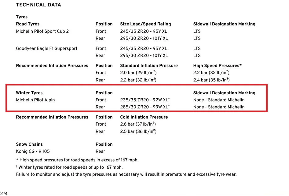

If you need (or are obliged to fit by law in your territory/state) "true" winter tyres then the Lotus recommendation (excerpt from the user manual) is these :View attachment 31886
