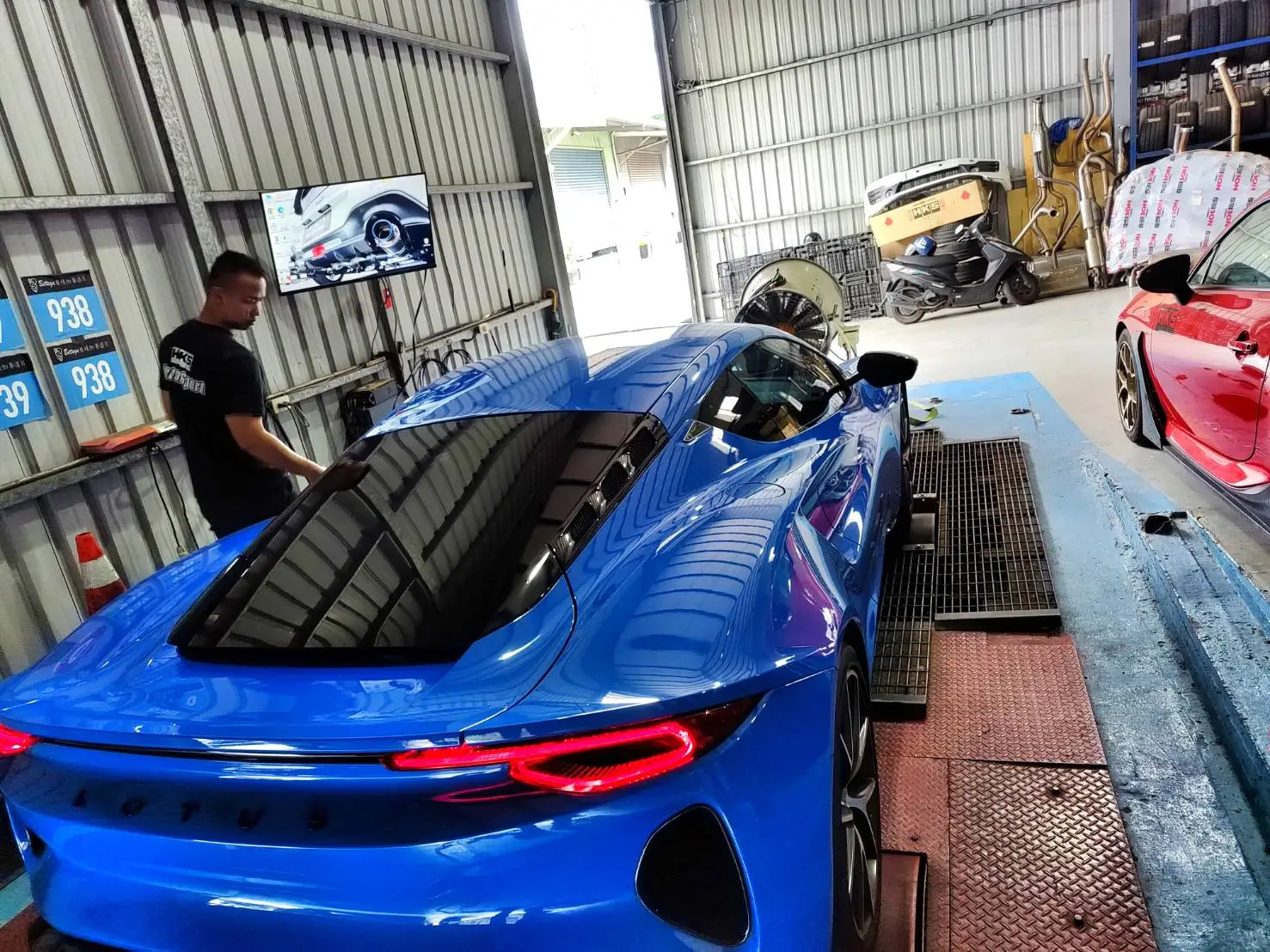

Test Conditions and Background
Test Vehicle: Lotus Emira 2.0T
Ambient Temperature: 20°C
Vehicle Modifications: Completely stock
Testing Location: HKS Performance
Number of Runs: 3

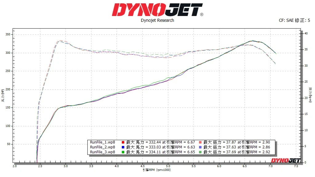

Measured Power: 334hp @ 6670rpm
Dyno Graph: Attached
Test Video
The aim of this test was to evaluate the Lotus Emira equipped with the AMG M139 engine in its completely stock form, particularly to see how well it performs compared to its claimed output of 360hp. Additionally, it was an opportunity to gauge the consistency of the power delivery.

Across three runs, the measured wheel horsepower was remarkably consistent, peaking at 334hp at 6650rpm. The maximum torque measured was 37.87kg-m at 2900rpm. For a stock vehicle, this is an impressive showing. Considering drivetrain losses are typically in the range of 15-20%, the engine’s actual output is likely in the ballpark of 380-400hp, which is higher than the conservative 360hp figure quoted by the manufacturer.
The owner of the performance shop also noted that AMG engines are often conservatively rated, and this test result aligns with that reputation. Lotus has clearly optimised the M139 engine for the Emira, ensuring not just powerful performance but also excellent stability and consistency in its output.

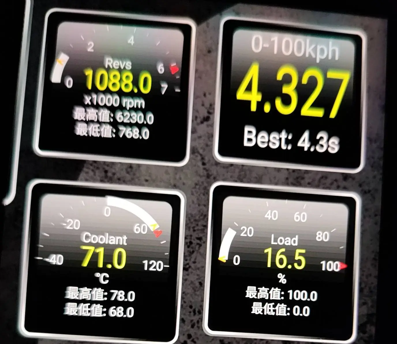

0-100 km/h Acceleration Test
To further evaluate its performance, I conducted a 0-100 km/h acceleration test. Using the Launch Control mode, the Emira clocked a best time of 4.3 seconds, which matches the factory-claimed figure. However, as the tyres were not fully up to temperature, there was slight wheel hop during the launch. With optimal tyre conditions and a warmer surface, I believe the car has the potential to achieve closer to 4 seconds flat.

Nice. Did they give you a version of the graph with the boost curve on it? Usually on a Dynojet there's a sensor they can T into one of your vac lines to give the additional info. On any dyno, actually, but I know for sure the standard Dynojet sensor package comes with one.
I'll check tomorrow
