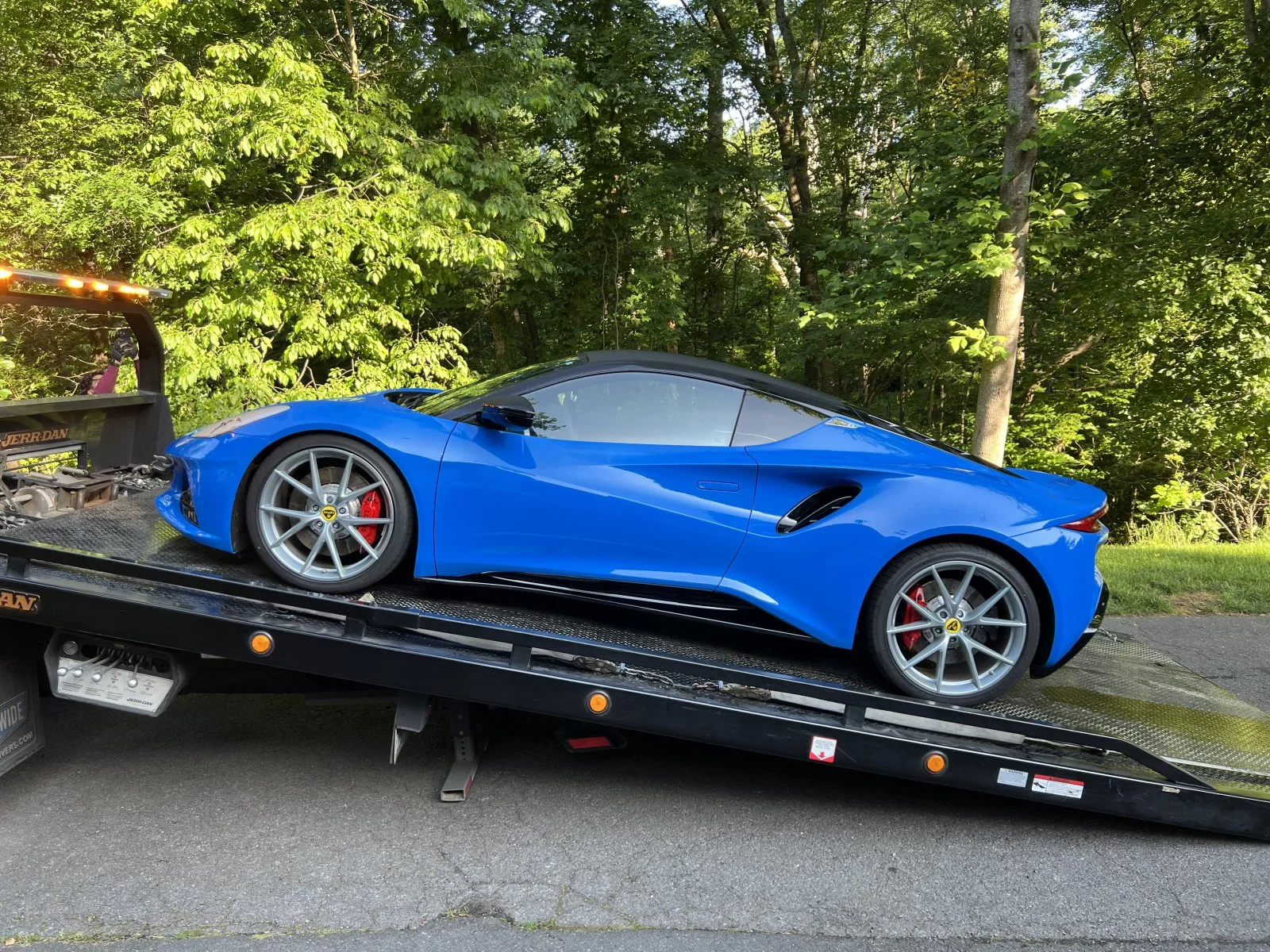

  • #16
My baby is tucked in for the ride back to NJ to get serviced 😢
