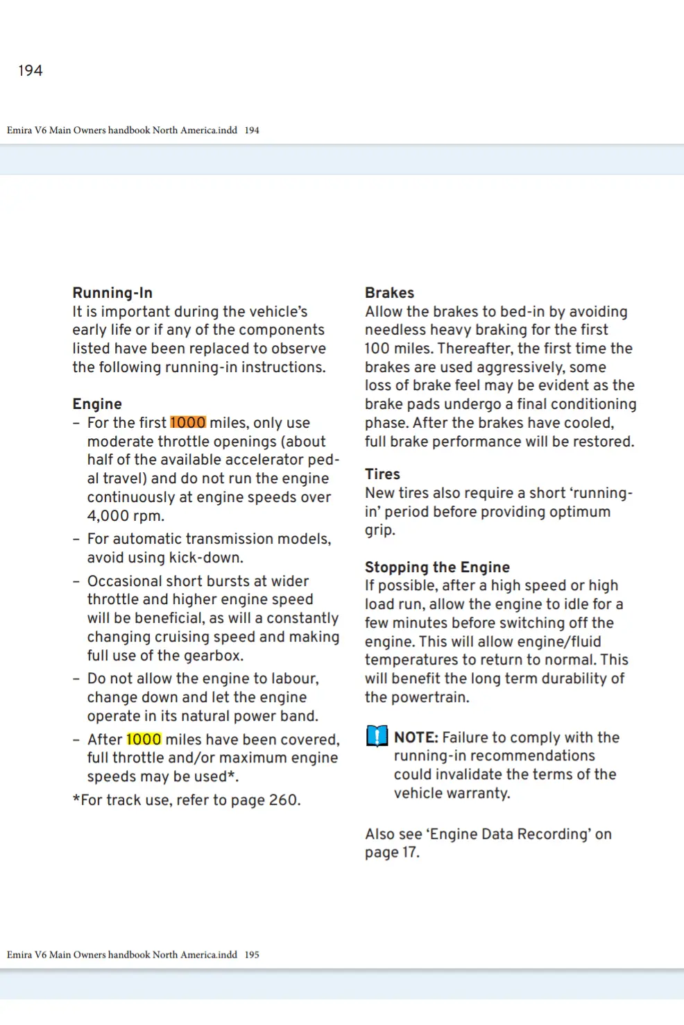

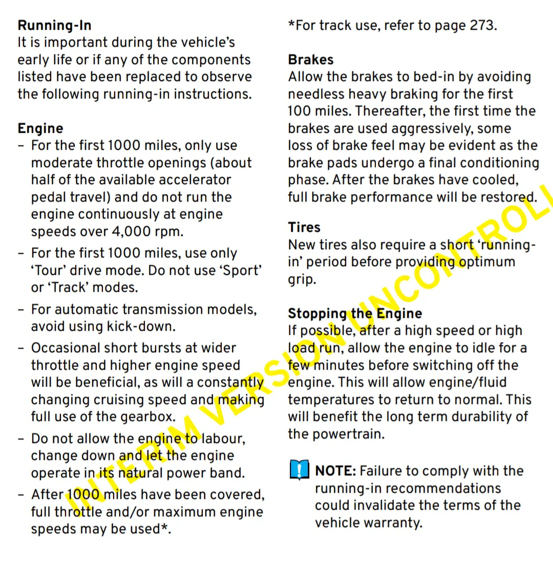

I was told it was ok to use tour and sport but not track. The manual above suggests only tour !!!
It's pretty clear in the manual. Definitely were told bad info. Especially bad when on that same page it says "not following these things could void warranty"
This guidance in the manual is new. Previous versions of the manual did not include any reference to avoiding certain drive modes during break-in.

"...do not run the engine continuously at engine speeds over 4,000 rpm."
"Occasional short bursts at wider throttle and higher engine speed will be beneficial..."
Emphasis mine.
Where did "don't exceed 4,000 rpm for 1,000 miles" come from?
The opposite is true according to the manual.

I have a different manual from manufacturer....crazy.
I have this PDF too with these directions that I’ve been following. If lotus would to deny a warranty claim I am sure lawyers would have a field day with this. Its not like we were given an owners manual with this car!
