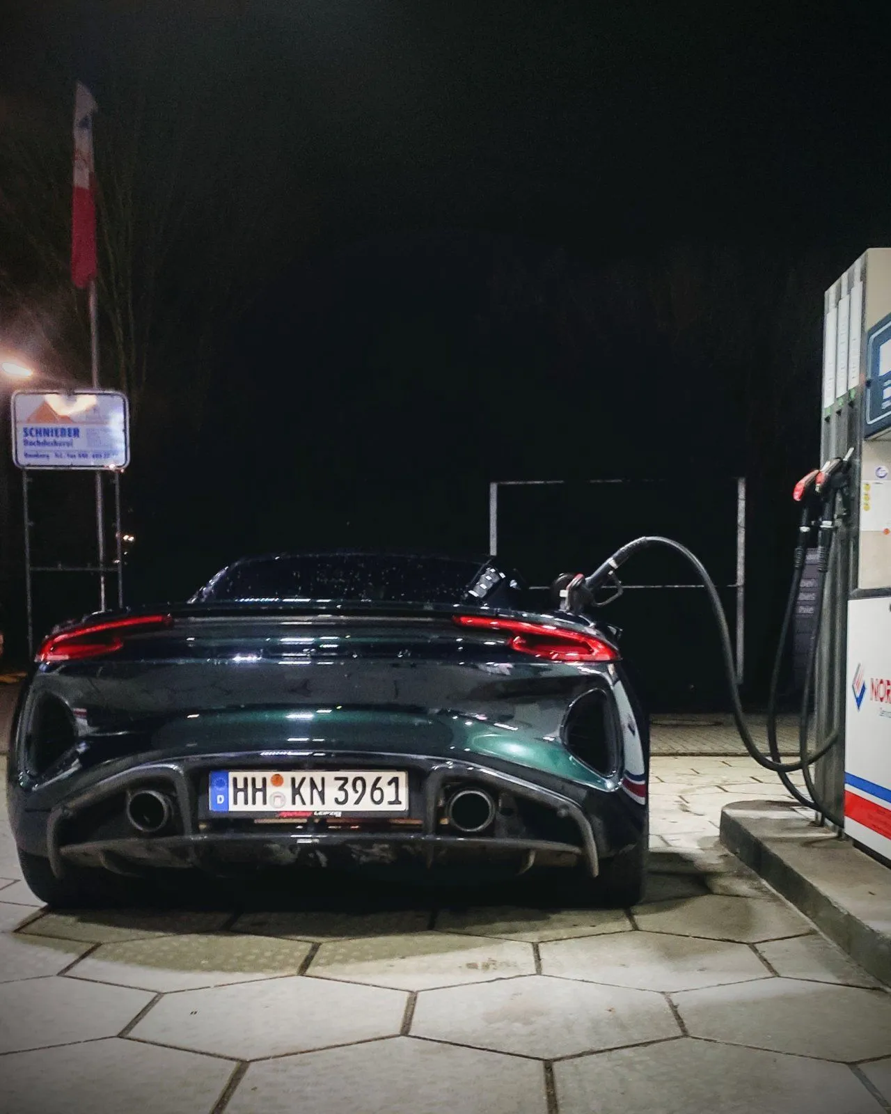

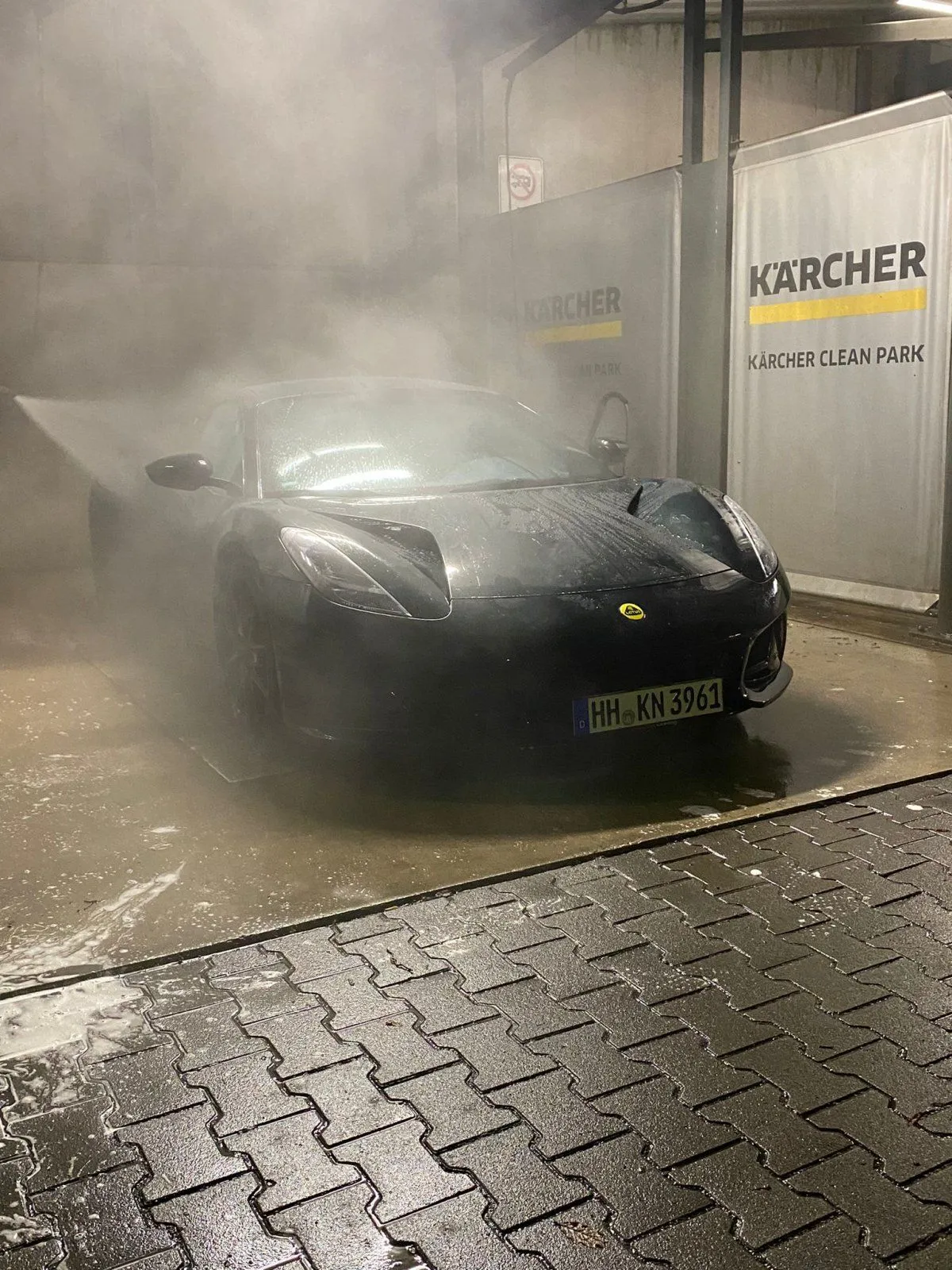

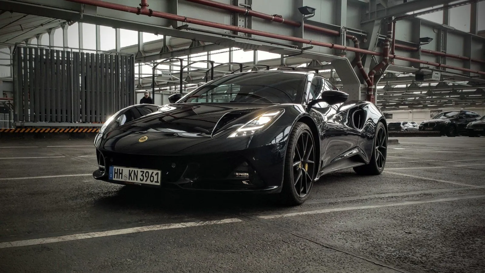

Two quick shots, not that good, but I think for some every picture counts :D
Will get proper shots done, promise :LOL:
