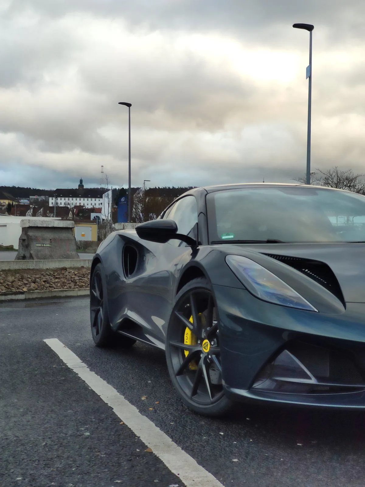

📓 Journals Look at what I picked up today 👀

Not what I hoped to see in my first 1500km.. Check-Engine just came on while driving at some point. I'll let the dealer read it out tomorrow.
Handbook says something with the exhaust system.
Good news!
Shop read it out. The exhaust flap/valve got suck at some point or didn't react as expected. Parts were checked and tested and operate as intended. Guess it needs some break-in miles as well? :D
Apparently it happened to one of their test cars too, hope this doesn't become a repeating issue. They could weld that thing open if you ask me 🤫
