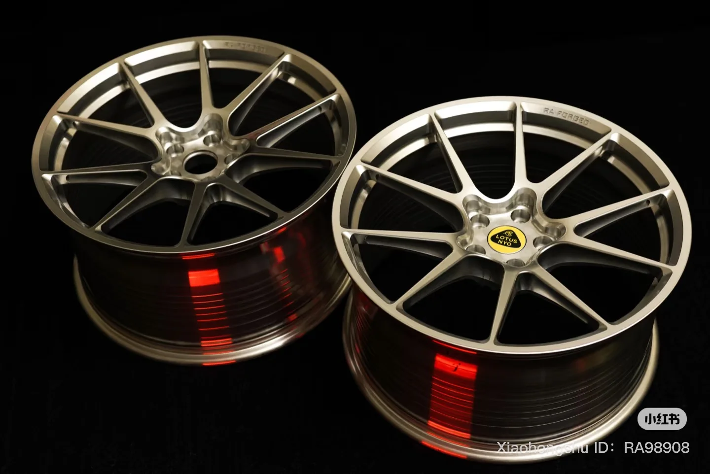

Being the wheel whore that I am, I'm going with Forgeline. @kitkat tell me I'm wrong.

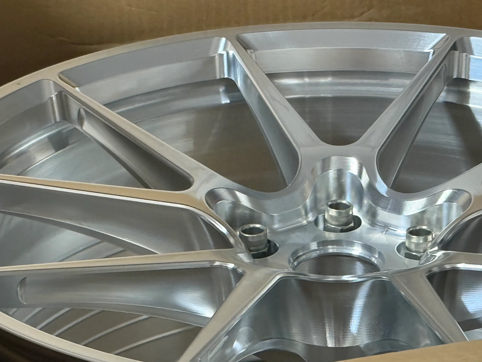

That’s what they’re based on — Forgeline GS1R — but they’re actually from RA Forged in China.

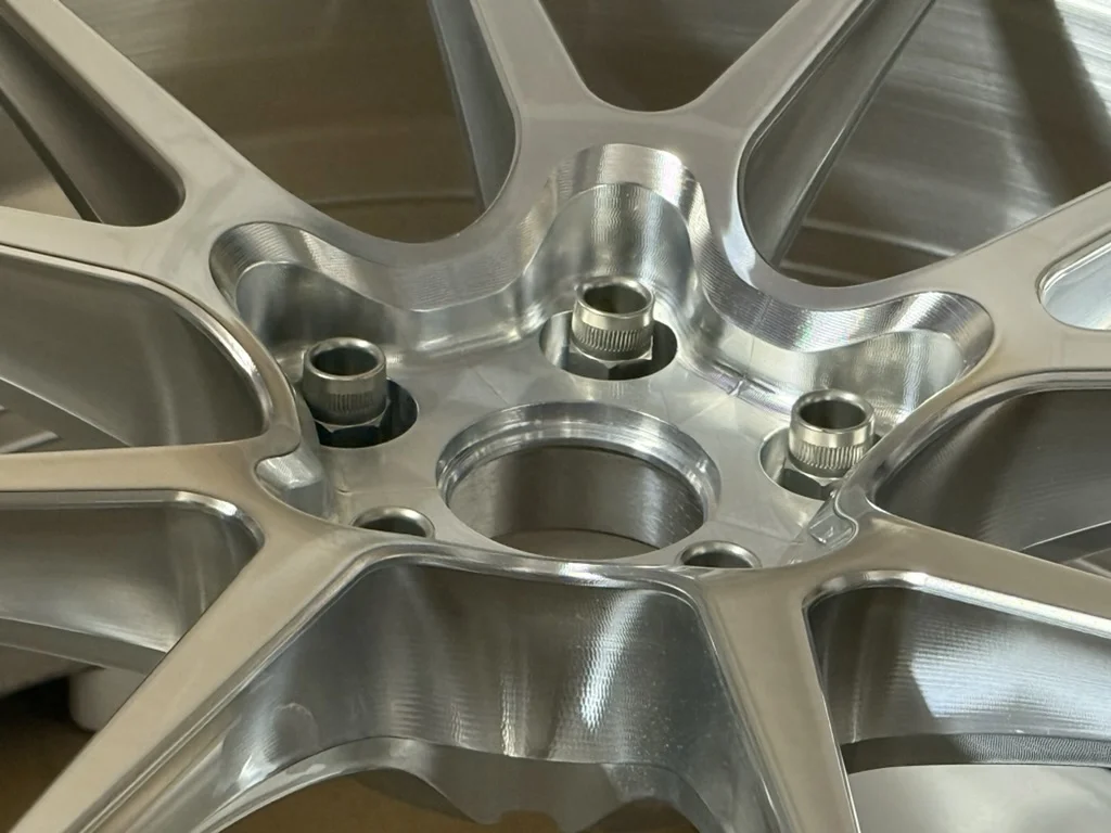

I had them design a version of the wheel with a balance of concavity and lug pocket depth in the rear and a flat face up front with a lug pocket maximized up front all to clear brakes. They nailed it and gave me 4-5 mm clearance to the brake edge as indicated in my diagram.
20x8.5 ET 45
20x10.5 ET 39
6061-T6, came out to a 15.92 lbs reduction over stock wheels.
Price was around $1500 DDP (delivery duties paid) plus shipping costs ($250 sea or $650 air).
I’ll be working on some magnesium 18” track wheels next.

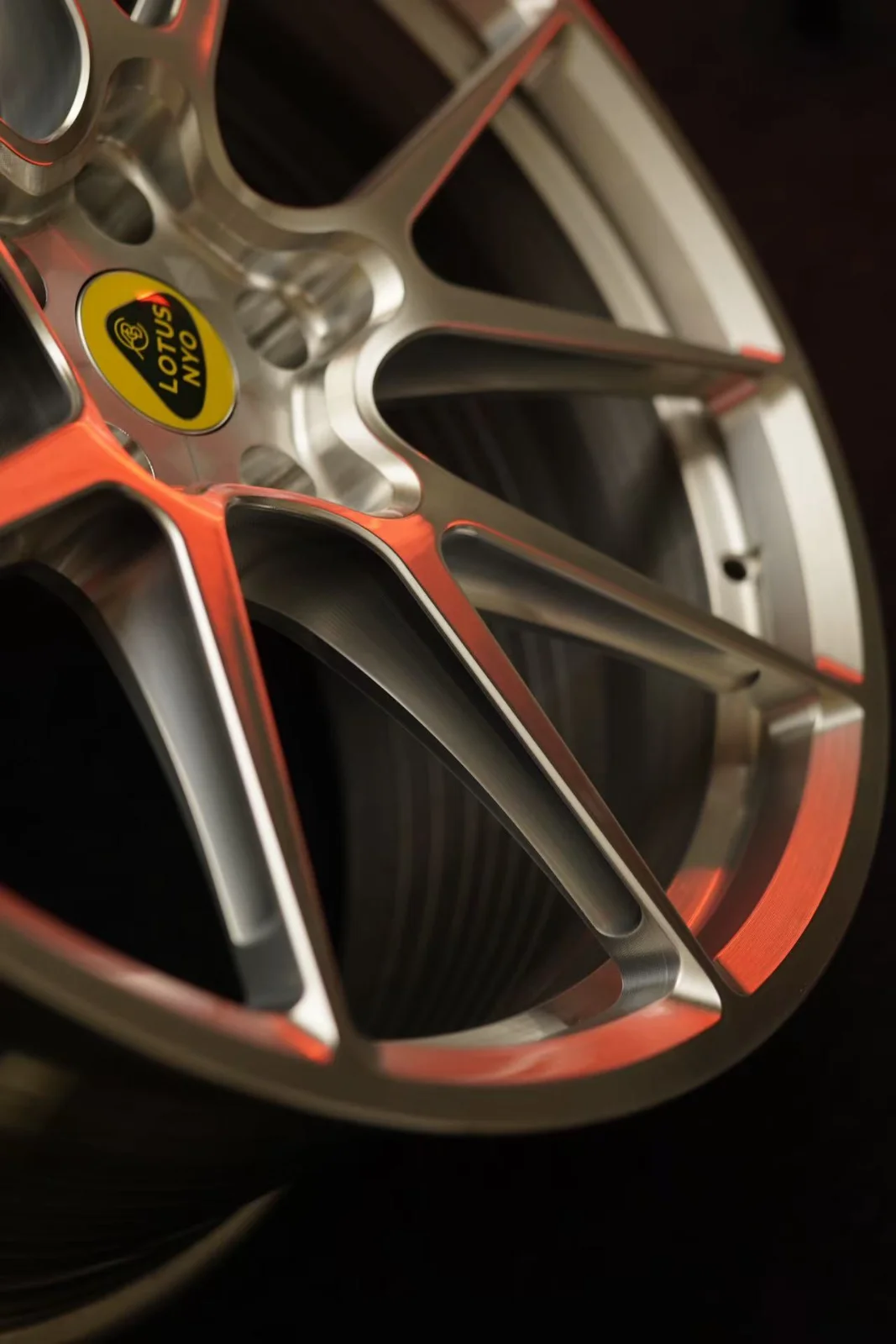

The finish on these is pretty unique, the spoke sides themselves are as machined and the face is diamond cut -- and then the whole thing is cleared. Don't think I've seen anything like it on the market before, what attracted me to them.

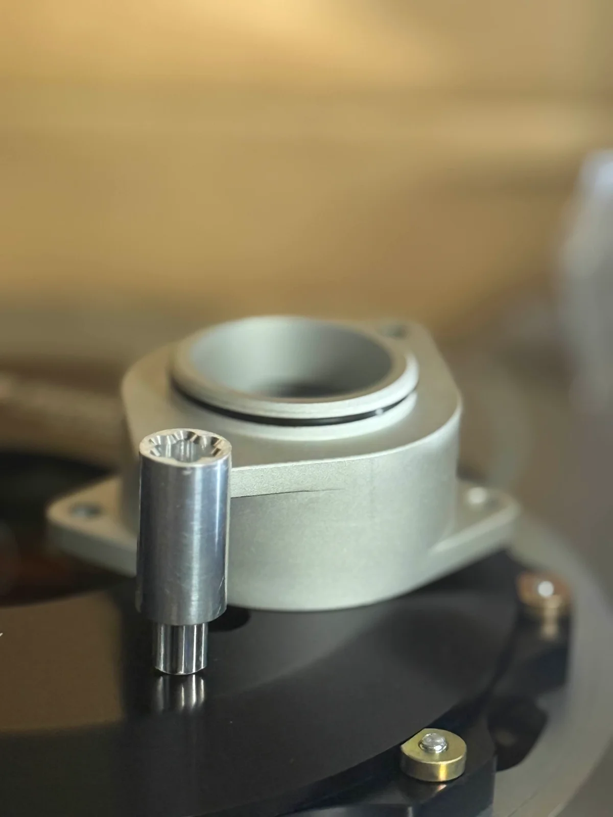

Parking brake relocation kit CNCed prototype arrives tomorrow and I will be test fitting it and from there Suntory will be making a batch of them and selling them.

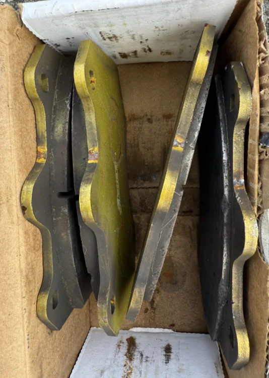

This is what my Rotora race pads looked like after 2 track days. The drivers side was almost gone and I've never seen this type of wear on one side before. Piston was not stuck because I changed the pads back to stock at the track. Dropped of the car at the shop today so they can figure it out.
Has anyone ever seen this and what can cause this? Car always went into limp mode after around 7 laps, but it was over 95 degrees. So I went off right away and drove it 5 minutes to cool down. Turned off ignition and then limp mode came off when I restarted. The bad valve controller was changed, but the bank 2 oxygen sensor will be replaced this week. I hope when it's changed that car will stop going into limp mode. Has anyone else tracked a V6 with paddle shifters and gone into limp? mode? The dealer says some customers have tracked, but they had manual V6s, and no one has gone into limp mode.
I have tracked a v6 auto, didn't go into limp mode, temps were in the 70-80's, didn't do really long sessions but it's road Atlanta and its looooong back straight. I also had a bad bank 2 02 sensor as soon as I drove off the lot. :( Changed it before track day.
