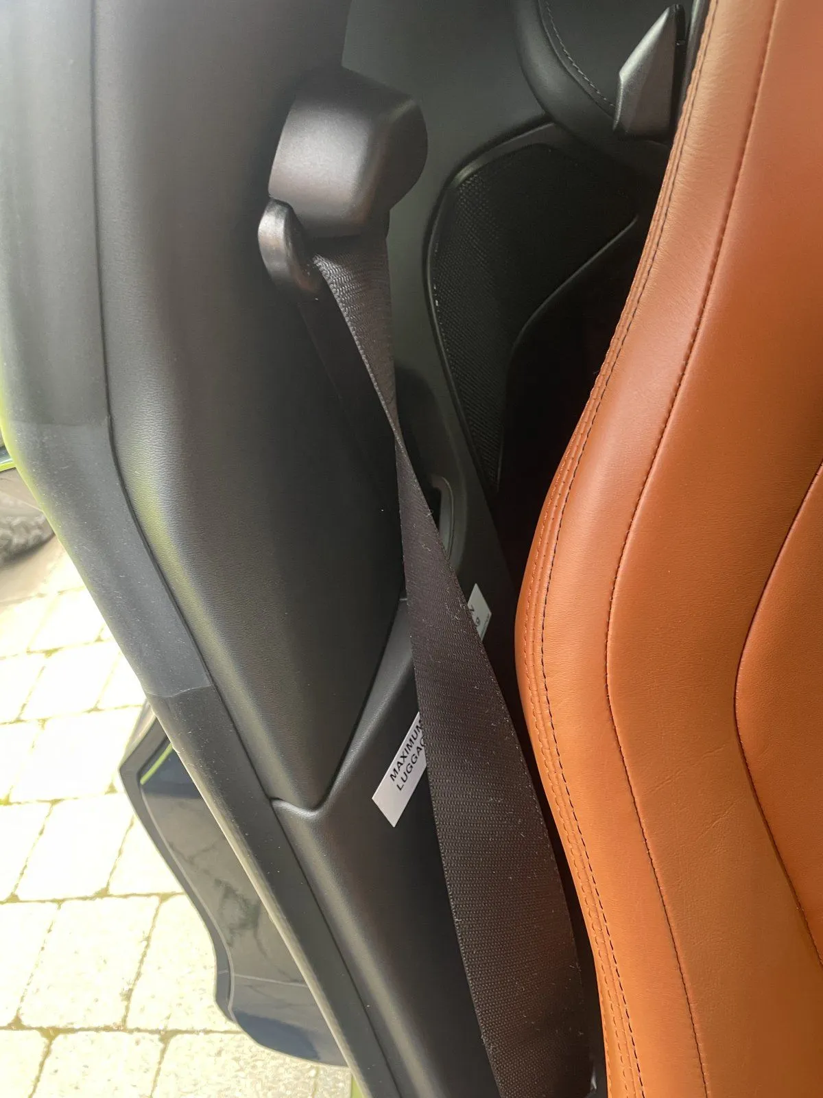

The seat belts are normal and meant to be twisted. I had this conversation with the dealer too and they’re all like that. It’s actually quite useful because the seatbelt rests on the seat side bolster nicely. I’m sure the brakes will bed in and improve. Also depends on the last car you’ve just driven too.

Agree on the seatbelts, no other car has seat belts that way. Also noticed the tag on the seatbelts (near the base) face outwards which suggests that it's the wrong way round. Someone on the forum mentioned that it's an easy DIY fix though.
Dealer confirmed it is meant to be like this. Rightly or wrongly, why is it twisted? There must be a reason. Im just curious, doesn’t bother me as long it is correct. By the way, the label faces inwards at the base of the seat.

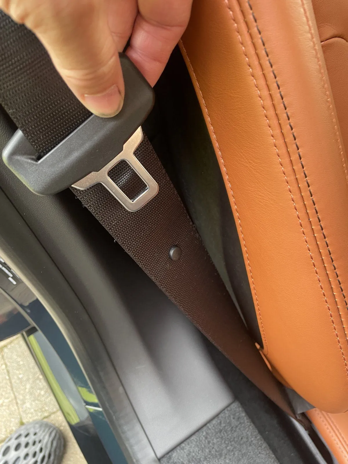

IF you lay the seat belt over the side of the seat like that, it looks nice, but the belts are NOT supposed to be twisted. Apparently it's set that way for convenience, but there should be a slide keeper on the belt that lets you keep the blade up higher on the belt so you can reach over and grab it. I can't tell from the photo, but is there a keeper just under the blade?

Ah so that means the one I saw was genuinely twisted? Haha I am confused now as the one in the picture also looks twisted to me.
There is a keeper on the belt. It’s like a little plastic button that stops the blade sliding down the belt.
This may be something to do with Lotus evolution. If you look at an Evora it also has the twist but I think that’s to do with Evora having a slider bar at the bottom to allow access to the rear seats. This seems to have carried over to Emira but obviously there is no slider bar on that.
Despite the twist looking not quite right, I have found by ignoring the aesthetics, it works perfectly fine.
Im finding it’s twisted when clipped up and the twist ends up on my shoulder or chest which isn’t the most comfortable! Not the biggest issue but just wouldn’t want it like that in a crash.

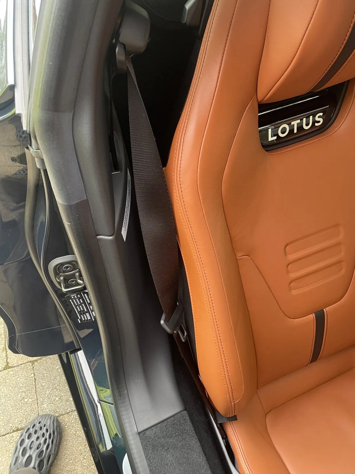

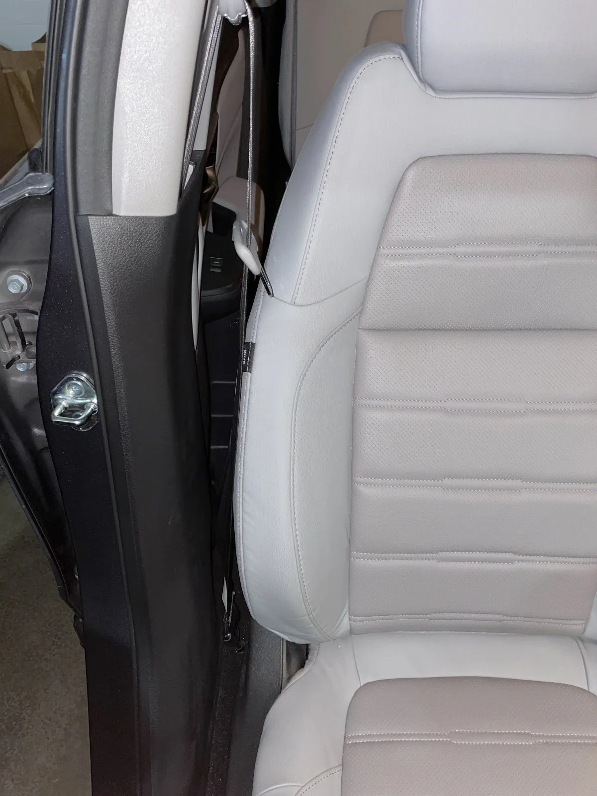

I don't know what they're smoking at the factory or even the dealerships, but that twist is absolutely not supposed to be like that. Here are photos of 2 vehicles in my garage; same side of the car as your photos.
Honda CR-V:
As you can see, the belt is flat coming up out of the B Pillar, and remains flat all the way down to the fastening point at the bottom.

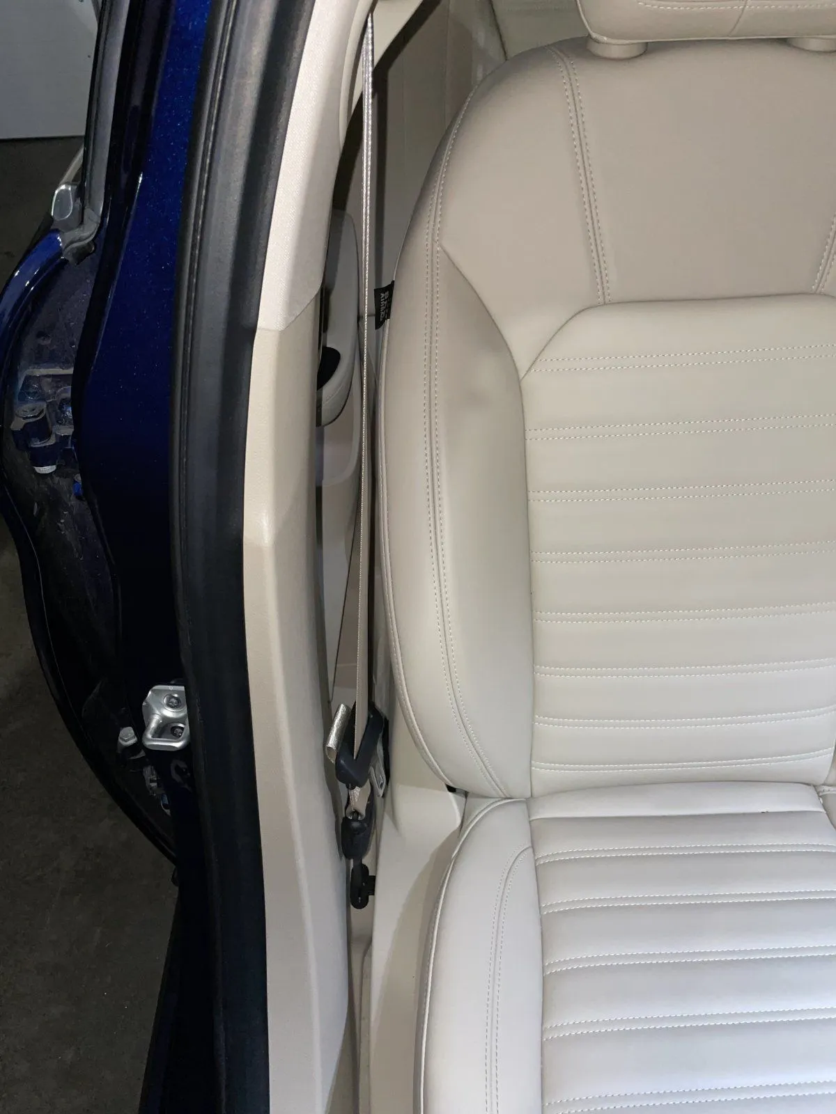

Alfa Romeo Giulia:
Belt is flat coming up out of the B Pillar, and remains flat all the way down to the fastening point at the bottom. You'll also note that fabric flap coming off the belt behind the blade? That's supposed to be pointing outward, away from the seat.
Now look at your photo:
Compare this to the photo of the Alfa. The cloth flap on the bottom should be pointing away from the seat, and believe it or not, the blade on your belt is on backwards; it should be pointing away from the cloth flap, not be on the same side.
The belt should NOT be twisted like that. It's fixable; undo the belt at the bottom, and turn it around so it's flat all the way down, AND remove and reinstall the blade the opposite way it is now on the belt, so it's pointing away from the cloth flap after you turn the belt around. The blade should then be pointing towards the seat like it's supposed to.
I don't understand why Lotus is doing this unless they got an odd batch of belt assemblies. This should be something that's obvious, but at least it's fixable.

Totally agree with you, I can fix it myself but I don’t want to in case in the event of an accident, they may say I’ve modified the seatbelt. I want Lotus to acknowledge the fault and fix it even if the dealer said it’s normal. Maybe I need to ring customer services and ask why?
Is there any way of getting Hethel to acknowledge the issue or at least post an official confirmation that they designed the belts this way? This is a very basic safety issue.
Whoever has access to Hethel, preferably someone like Scott, show them the pictures I posted. I don't know if every Emira is coming off the line like this, but they need to straighten these out.
