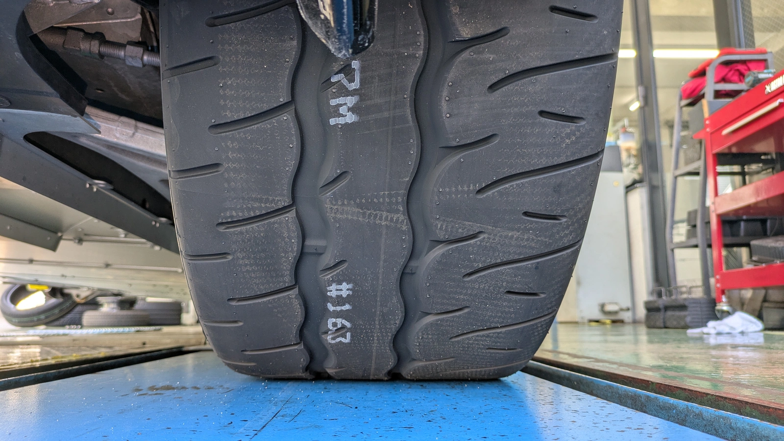

Just got the AD09s fitted and drove about 10km home. Feels fine for city driving, even quick 90 degree bends :cool: New rubber is always better than 2 year old brittle tires, and I know I would be more comfortable in the rain with these. However, the braking on dry summer asphalt feels softer than the Cup2s and will need getting used to. As such, this may not be the best choice for track use since the Emira is a fairly heavy car.
Advan Neovas were my favourite tyres on my Elise - doing many track days I got through a lot of different brands to try out. Advan Neovas were grippy but at the same time really progressive giving you plenty of warning and room to play. But they are quite soft and do wear quickly especially on track - I could get through a set in 2 track days at Anglesey.
Whilst I do also really like my Sport Cup 2s I'd be really interested in how these stack up long term on your Emira - especially if you do use them on track.
Edit: You probably already know this but just in case you didn't realise, these AD09s are W rated - so only warrantied up to a top speed of 168mph.

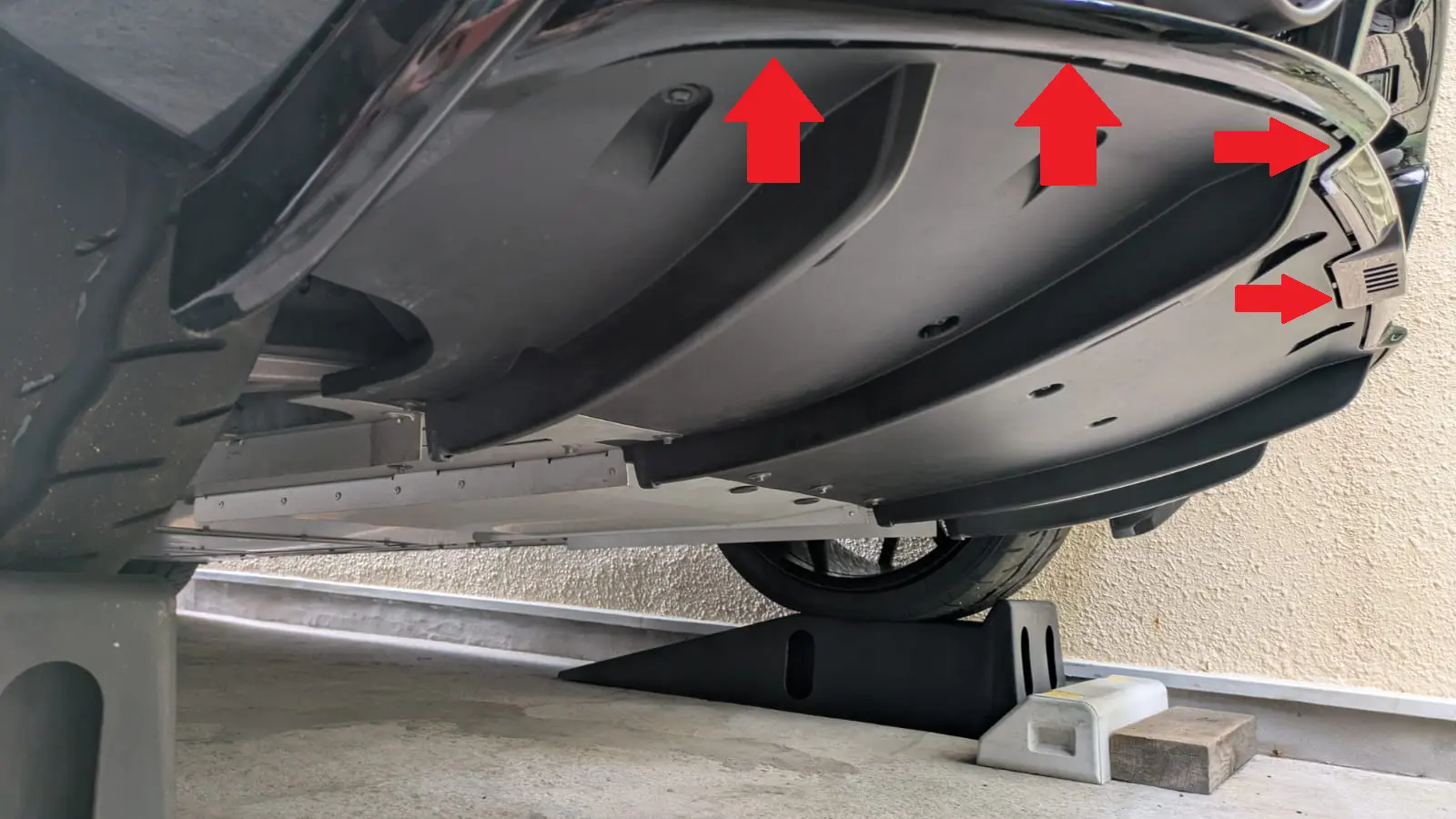

犯行に使われたものと同型のコンクリート製大型タイヤ止め。
こいつには近づくな!!!

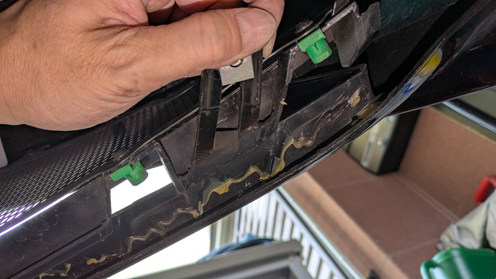

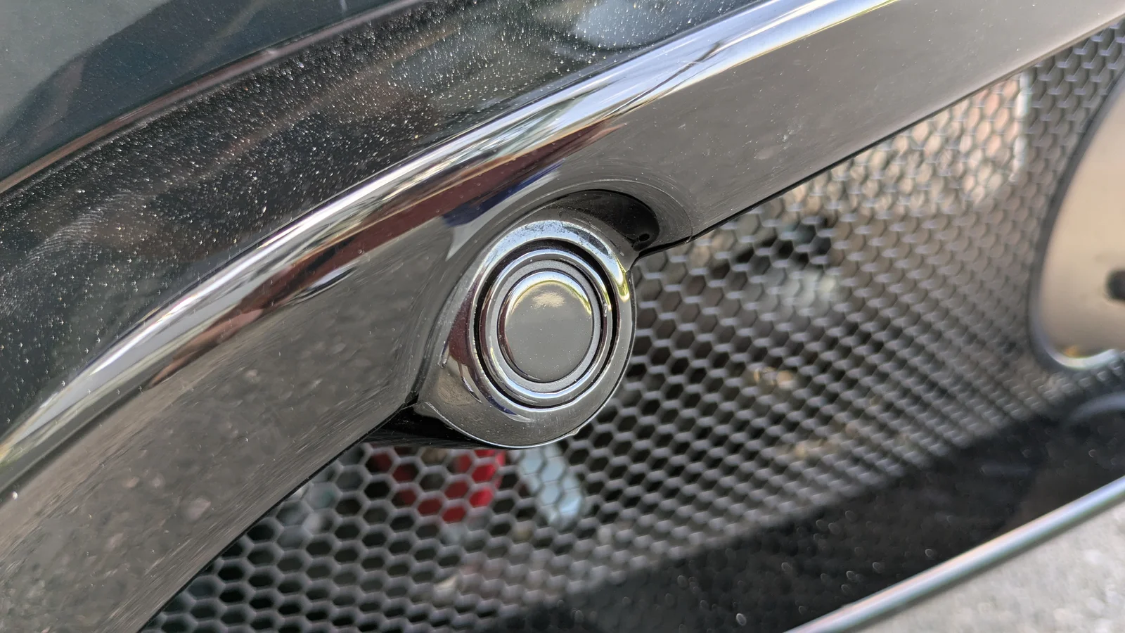

The mesh part of the lower rear bumper (including parking sensors and exhaust tips) is just glued into the gloss black trim. Once this bond is broken, you will need to find a way to reattach the whole thing, or get a new assembly and have it painted...
リヤバンパー下部のメッシュ部分とピアノブラックの部分は接着されているだけなので、一度割ってしまうとちょっと面倒です。板金屋さんって接着もやるんでしたっけ?
ちなみに、LCI 経由で
  • 部品交換だと70万円弱
  • 修理・再塗装だと40万円弱
  • 修理のみだと... やってみないと分からない万円
です。

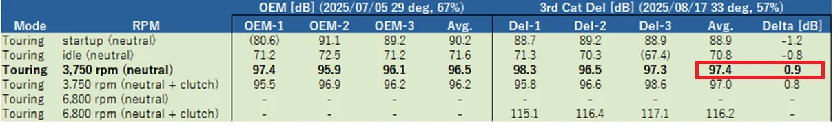

I know, I know... Measurements taken on different days under different conditions, but here are the results.
測定条件がビミョーに異なったりしてますが、ノーマル触媒と GRP 3rd Cat Delete パイプの比較をしてみました。近接排気音値が基準値 97dB を少し上回っているようにも見えますが、検査場での検査環境や手順を考えると誤差の範囲だと思います。
It was hot today, so the engine was already warmed up when starting. This resulted in lower RPMs during startup and idling. Please disregard these numbers.
