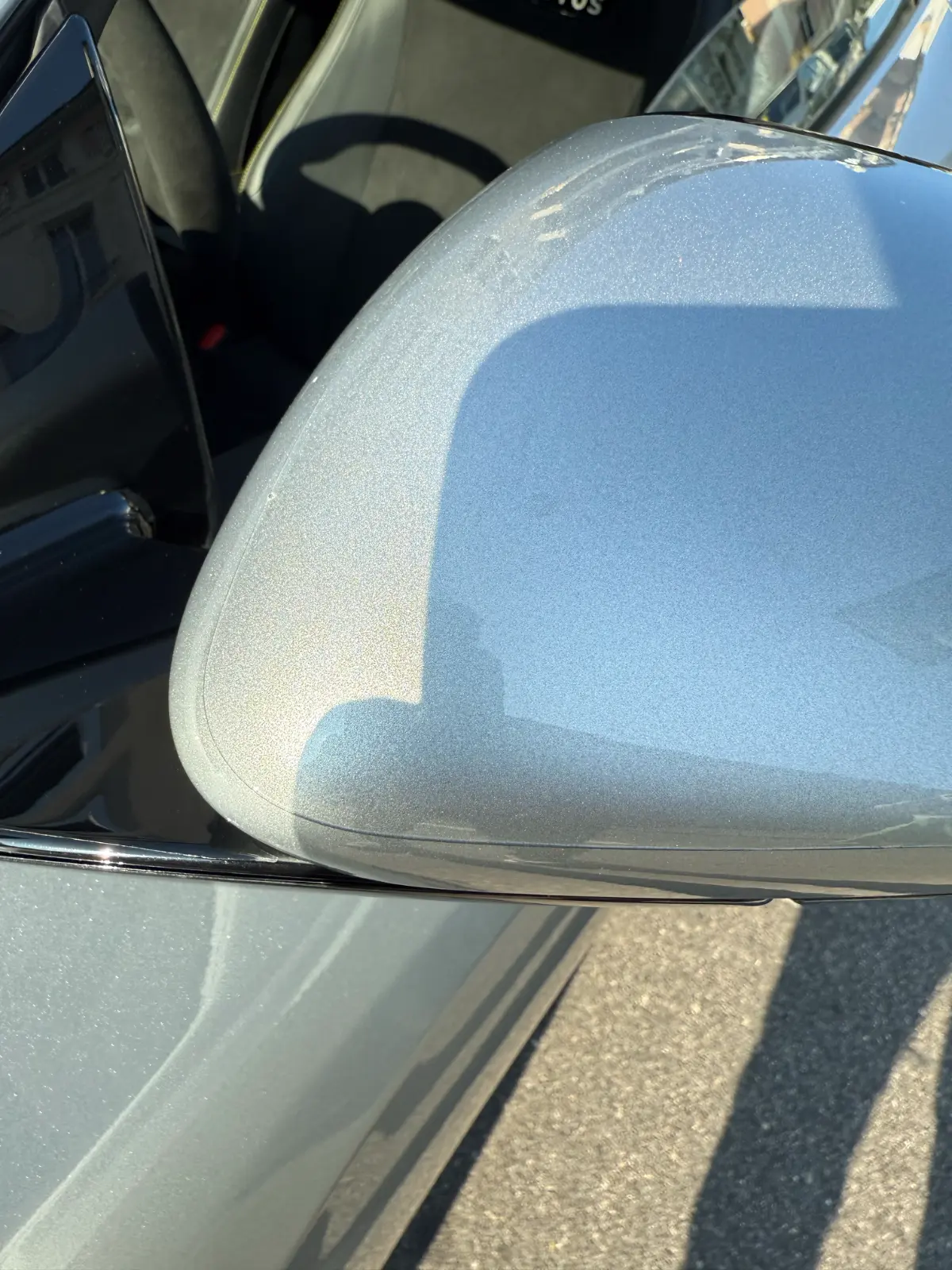

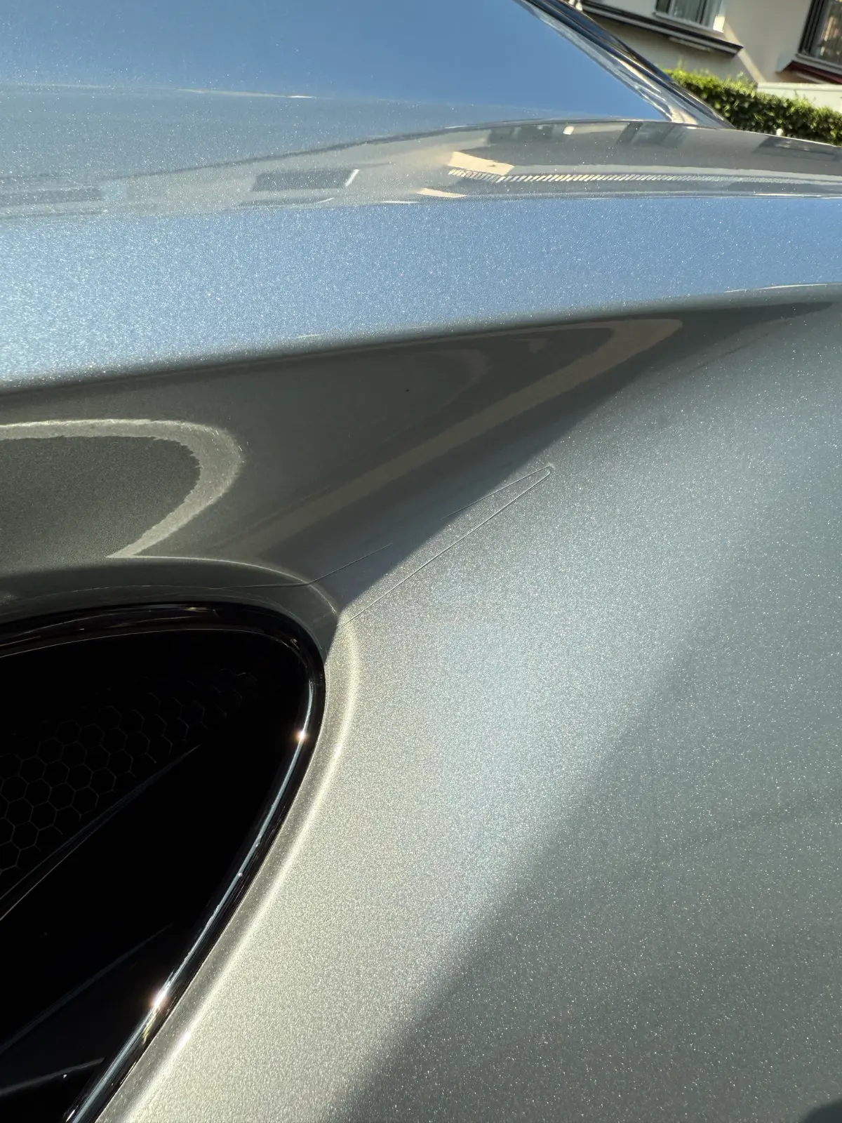

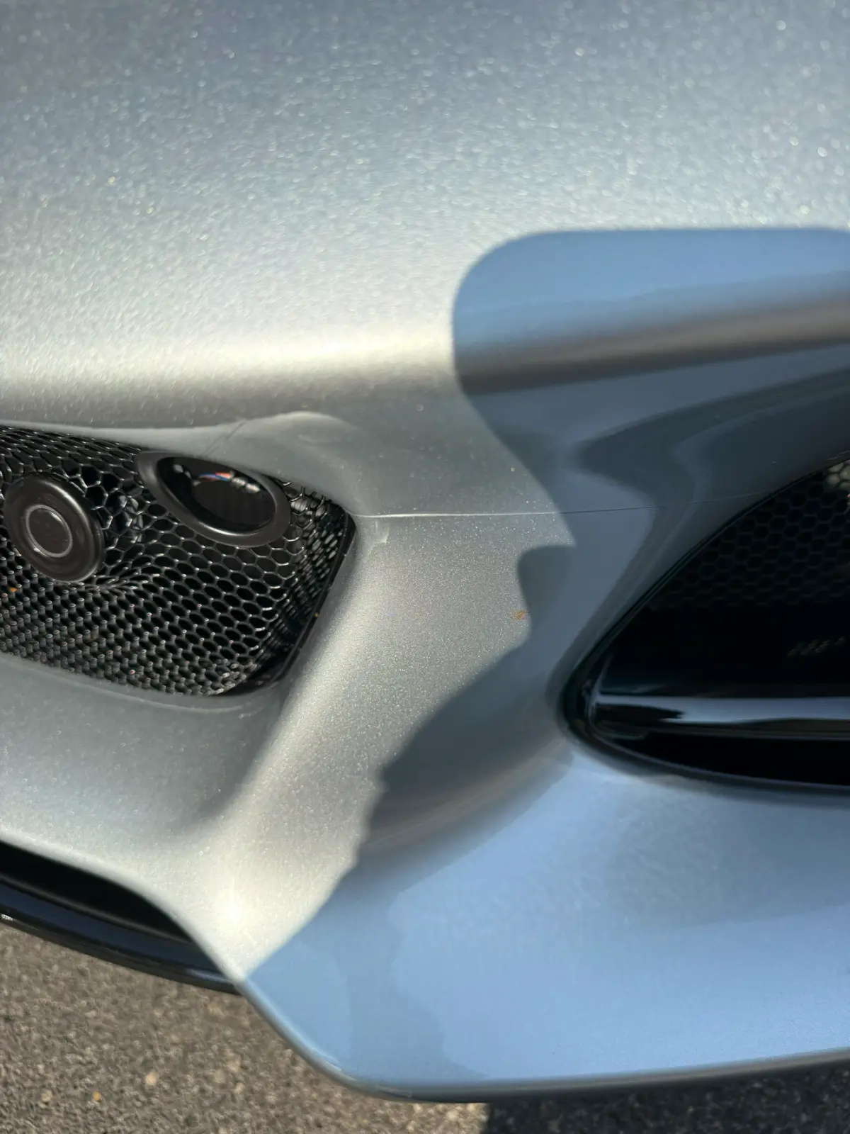

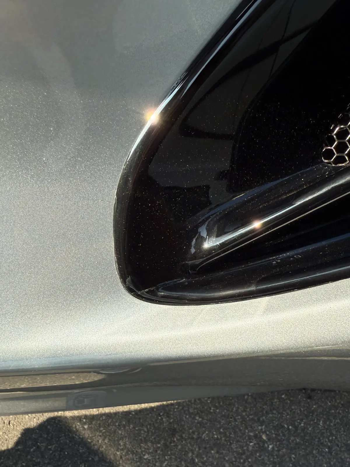

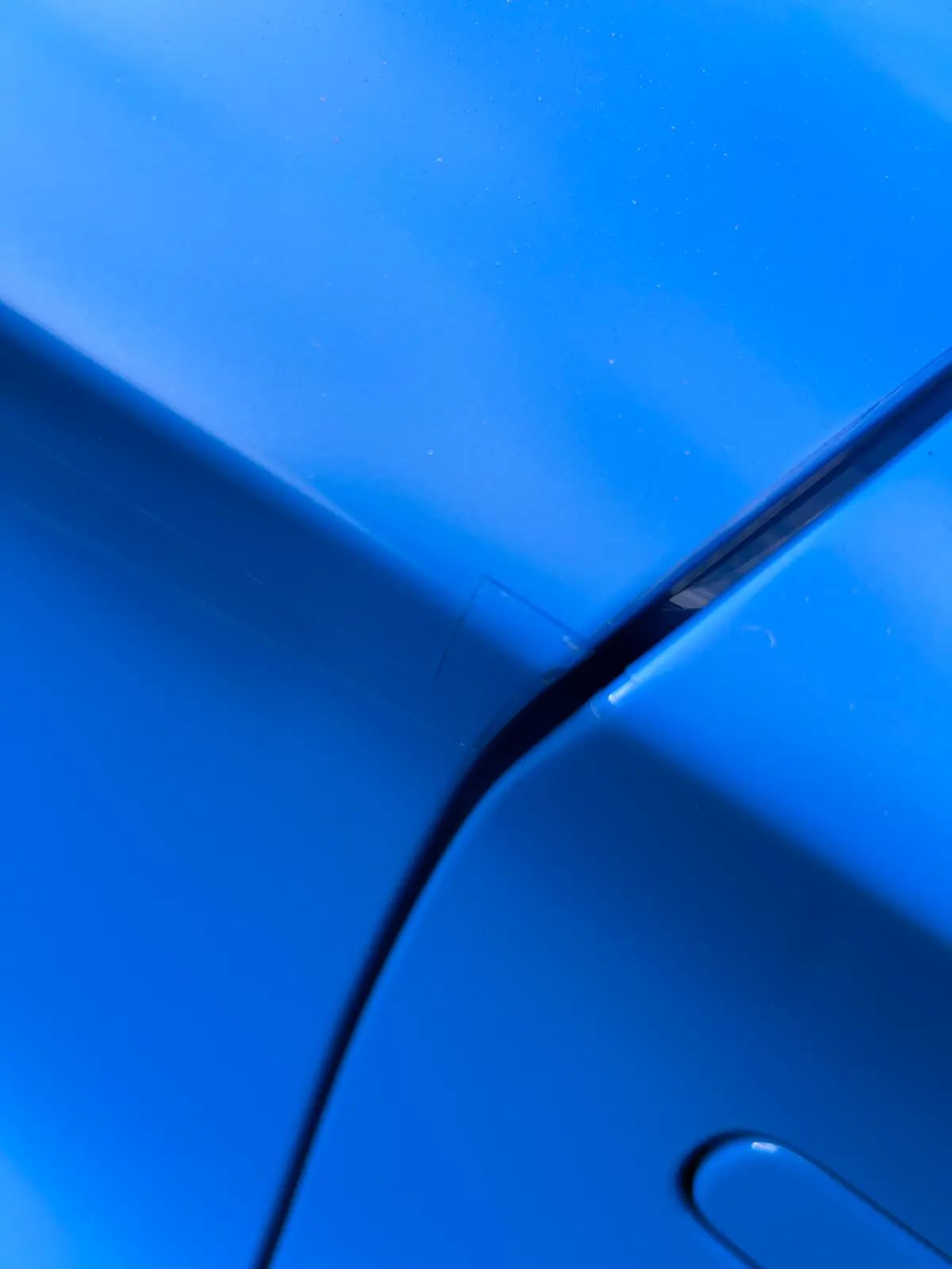

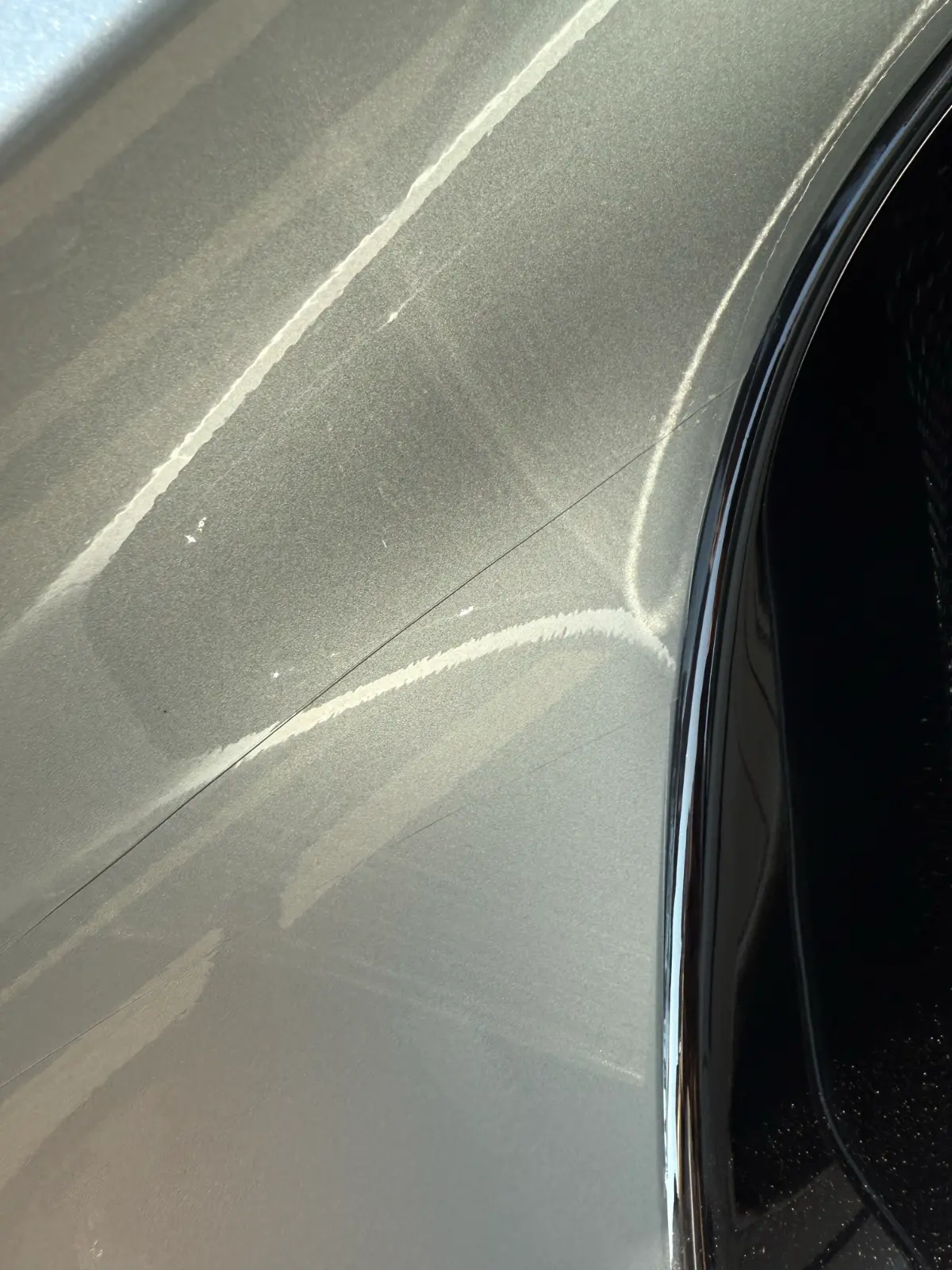

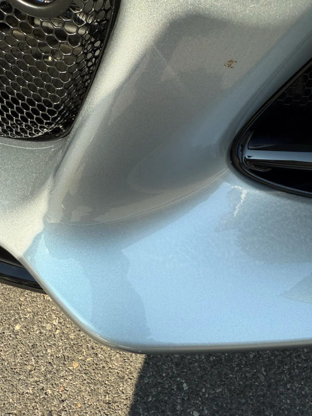

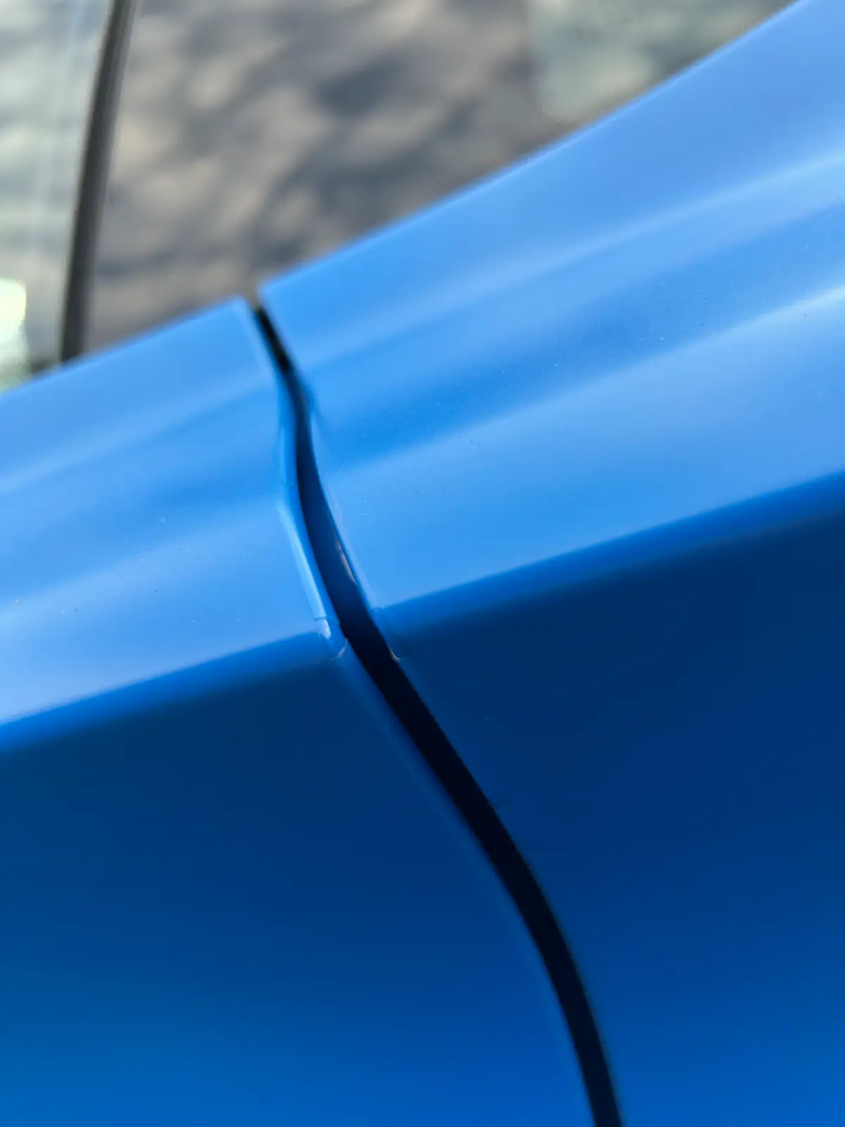

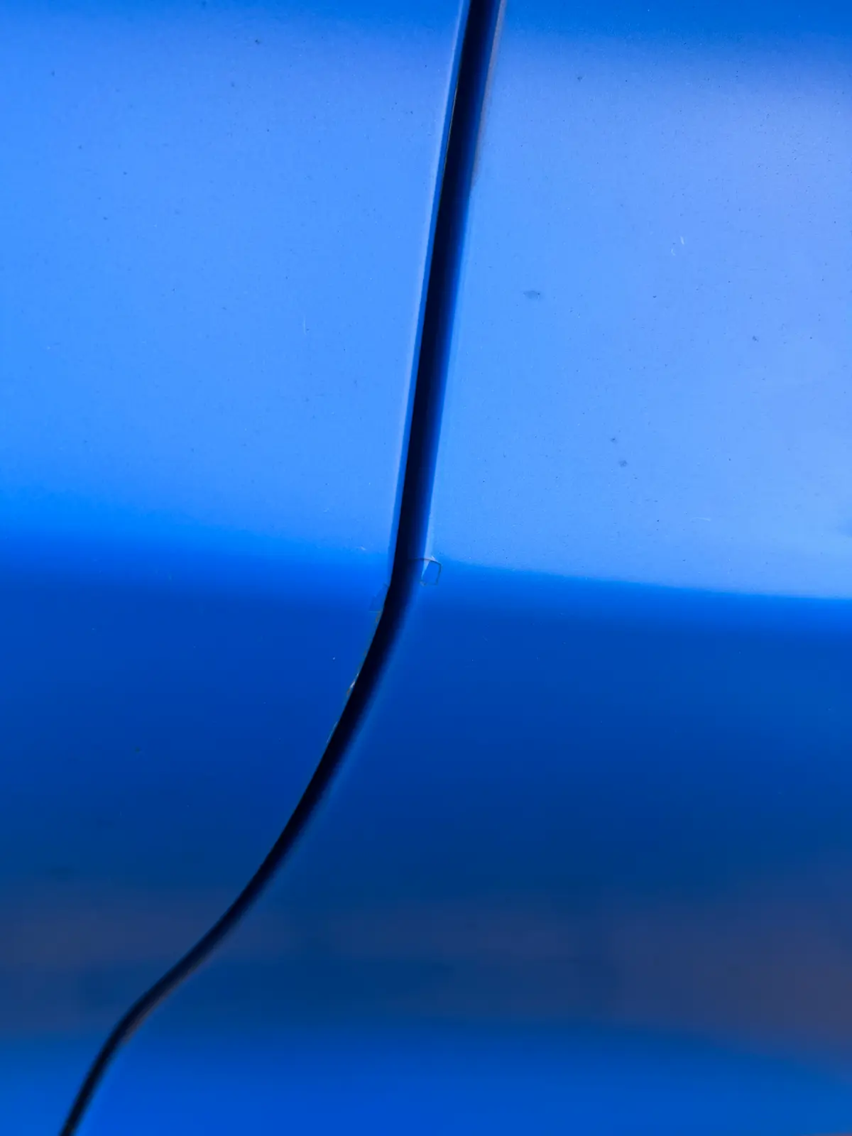

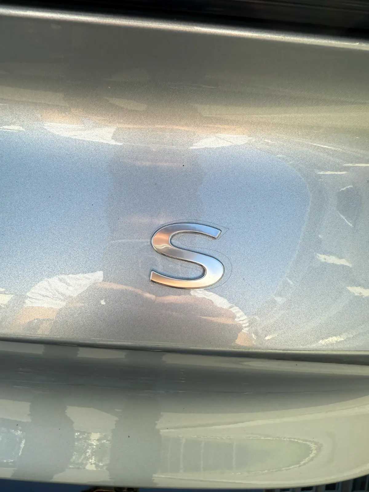

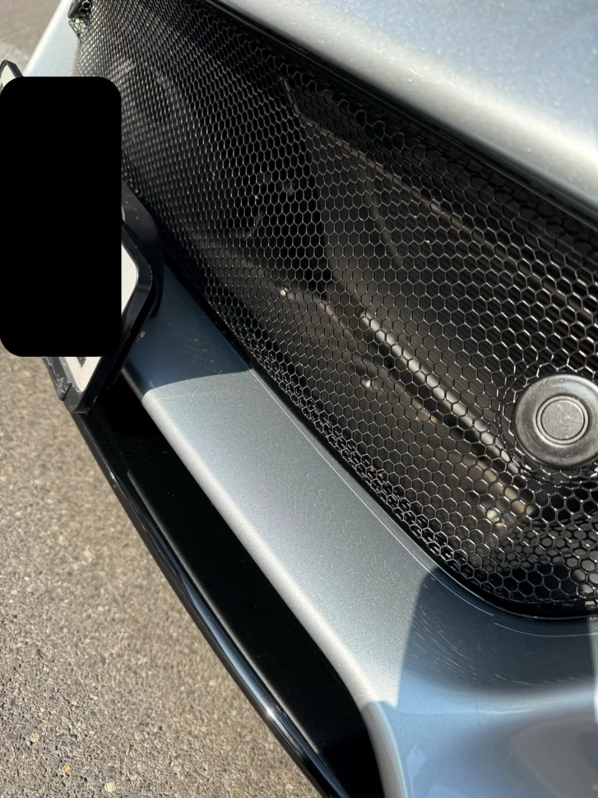

Hi all,

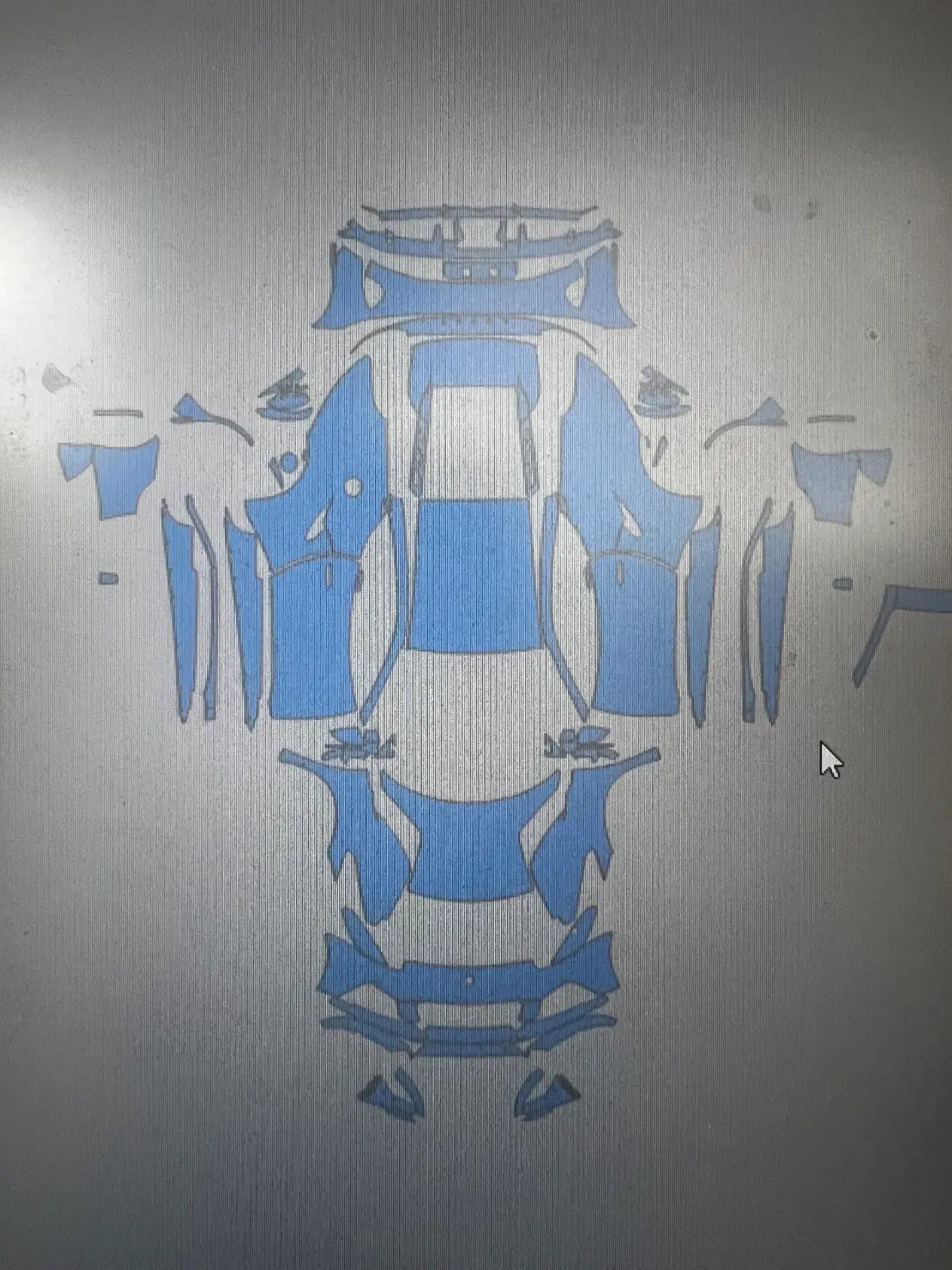

I'm not sure what to think about this PPF job, it's my first ever. The installer mentioned that he used a slightly over-sized template that they had cut with a plotter, XPEL Ultimate Fusion film. The main thing that bugs me is that there's seams all over the place, the front bumper's are even slightly mis-aligned, and same for the Lotus logo under the trunk. I'm not sure if my expectations are unrealistic, so looking for some guidance from you guys.
If you're wondering, I paid almost $9k, which in Switzerland (where it got done) is typical for "premium quality" fully-body PPF for a car of this size, at least on the French side of the country.
Any feedback appreciated!

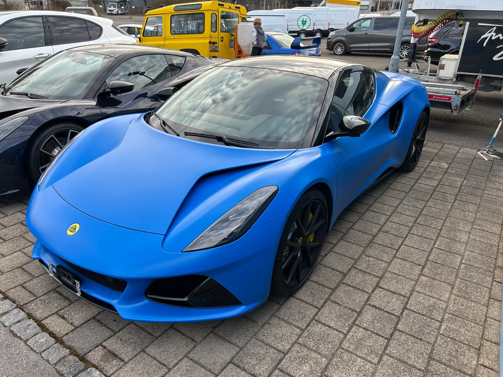

Where did you get it exactly? It looks like the same template that was used on a car on my dealers lot in switzerland. When I asked, dealer stated about CHF 7k, which equals to $ 8.5k.
I was wondering the same thing and to be honest it didnt look like a very good job considering the costs. I think yours is about the same what I can say from your photos.

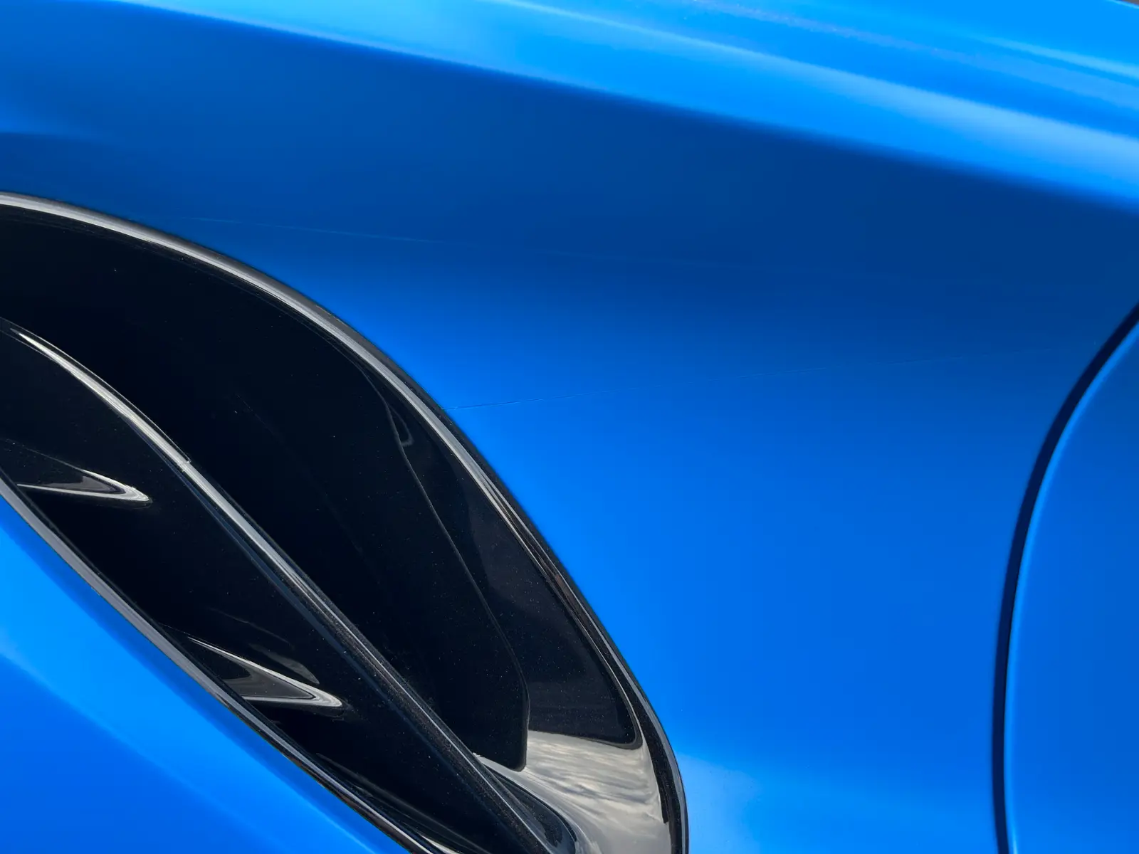

Not sure what is going with the mirrors, but the seams / relief cuts near the vents (and the buttresses on the rear hatch too I'd wager) are a bit of a bummer with the Xpel template. I have the same, but I haven't found them too noticeable when the car is clean. By all accounts, this is a bit of a pig of a car to wrap.
Where I think you're really going to be a bit sad longer term is around the lettering / badging... I had my installer remove them and stick new ones on top of the film so there would be no edges 😬
@Foxy87 That photo is in Geneva right? Looks like where I get mine serviced. I paid almost the same for mine, and 100% sure it's the same template. My installer was Car Spa Geneva.
> Where I think you're really going to be a bit sad about longer term is around the lettering / badging... I had my installer remove them and stick new ones on top of the film so there would be no edges
@ADC Yeah I think you're spot on, I wasn't too happy with all of the seams but the mis-alignment with the badging (and perhaps the gaps in the front bumper as well) is quite unacceptable in my opinion.
That‘s my car at Lotus West. The PPF is precut xpel.

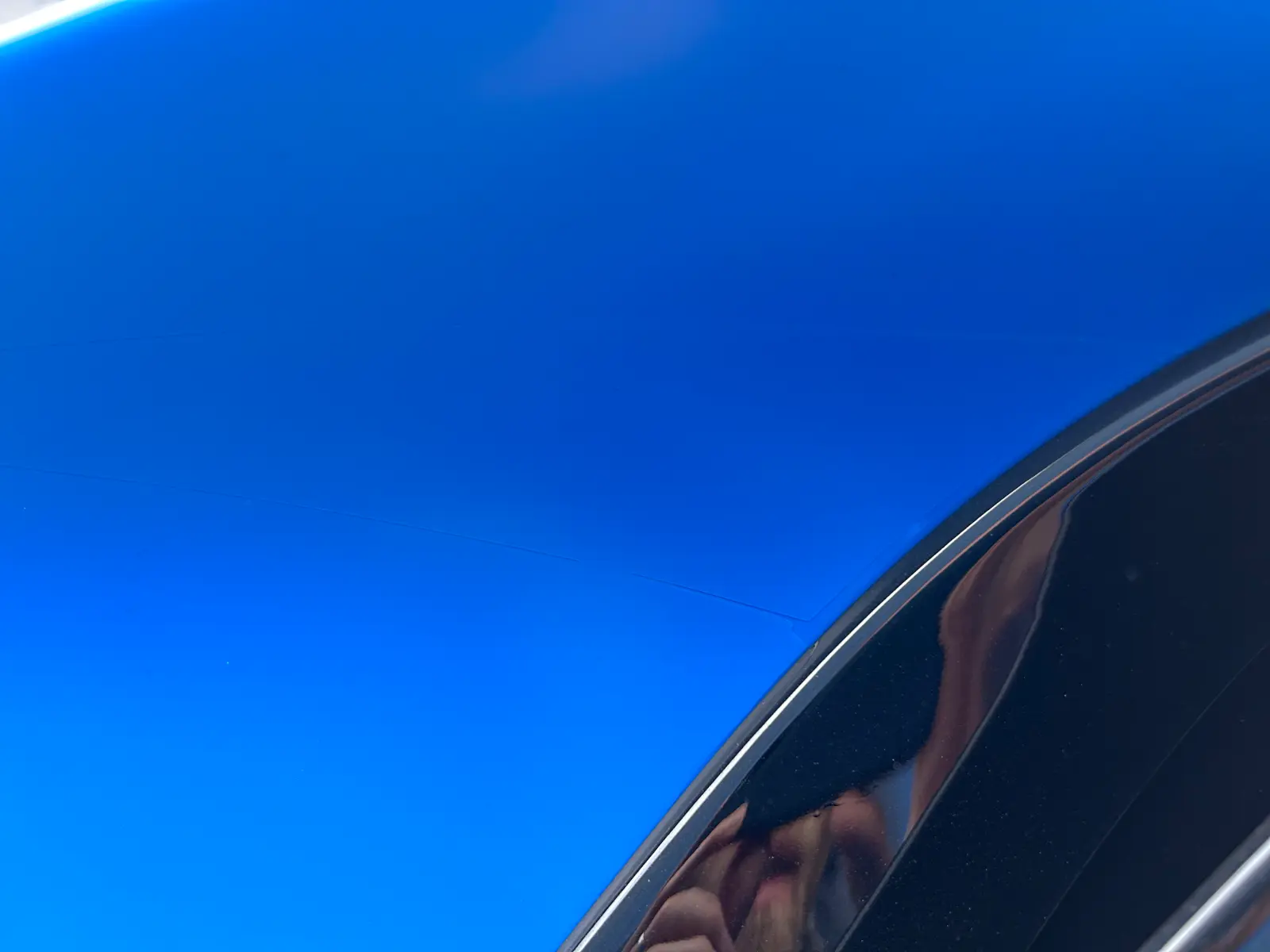

Nahhhh that is a poor PPF job. A good PPF job you should barely be able to see any edges at all. Sure their may be some relief cuts, but many of those edges are 1/2 inch from the edges. Dirt will get caught in there and look even worse unfortunately. I’d try to get it fixed by the installer by not using pre cut PPF
First you need to compare the job done, to the original deal made. If you were told they'd use a template, plus expand its dimensions so they'd have extra material to wrap around the edges and avoid tell-tale lines, then you didn't get what was promised. On the other hand, if you were told to expect visible edges/lines, then the job isn't so bad EXCEPT the poor job with the lettering or any misalignment or any gaps (especially the front which is most at risk), are unacceptable. So regardless of the deal made, it's not a great job in those areas and they should be redone IMO.
I'm also wondering about the thickness of the PPF used. Perhaps Xpel Ultimate Fusion only comes in one thickness (?). If not, my detailer warned me that thicker PPF is harder to install and can be a problem: it's more difficult to work with, on edges and tight spaces/corners. I suspect for the price you paid, it's not the thicker variety, so that's likely not the reason for the issues shown in some areas. Good luck resolving this.

In fairness to your supplier, that looks like the standard Xpel template. If you want them to custom-cut and remove trims/parts to avoid those seams, you should expect it to cost more.
Nice. How satisfied are you with this PPF Job and how much did you pay? I was just a bit irritated about these cut out on the edges. Seems like they will catch dirt and grime.

No, these pics were taken at the lot Lotus West St. Gallen.
At the end of the day, remember that PPF is sacrificial. It is meant to protect the paint, that’s it. The ppf job looks as it should if they are using a template. Would you rather them make the cuts on the car and remove more panels to be more seamless? Up to you
My ppf looks similar to yours, xpel or template. Main difference though is i had my installer remove the lotus badge on the back and apply back on top
If you are looking for them you can always see seams in ppf. Its impossible not to have them on an Emira. That said my installer did a pretty good job hiding them when possible. he also did a multi piece setup to avoid the big relief cut by the vent. I also had them remove the lettering. im not a fan of the letter cut outs. If i were to do it again I would have them do black ppf letters under the clear ppf for easier cleaning.
If you got a good deal and knew you'd be going with a precut template, it is what it is. It will protect your car. you won't notice it at normal distances. it will pickup grime that you need to carefully wipe off the edges to avoid the film lifting.
A better job will be custom (not template) and wrap all the edges so that it's invisible. I think 99% of ppl jobs will have the vent seam due to the shape and it's not that bad. apart from the vent seam, mine is invisible because all the edges are wrapped. but I did pay for a premium install to get that.

I am happy with it. I did partial car wrap and PPF on my Exige myself. Especially the PPF was a pain in the a… Since a still wanted to protect paint of my low mileage Emira it was clear I wanted it done professionally. And I didn‘t want them cut on my car. So precut templates were ok for me. I was expecting to see some seams but you really need to get very close to see them. They did the cutouts after a couple weeks when the workout some little imperfections. The film wasn‘t attached good enough on this edges and corners, they did the cutouts to protect the film from lifting further.
