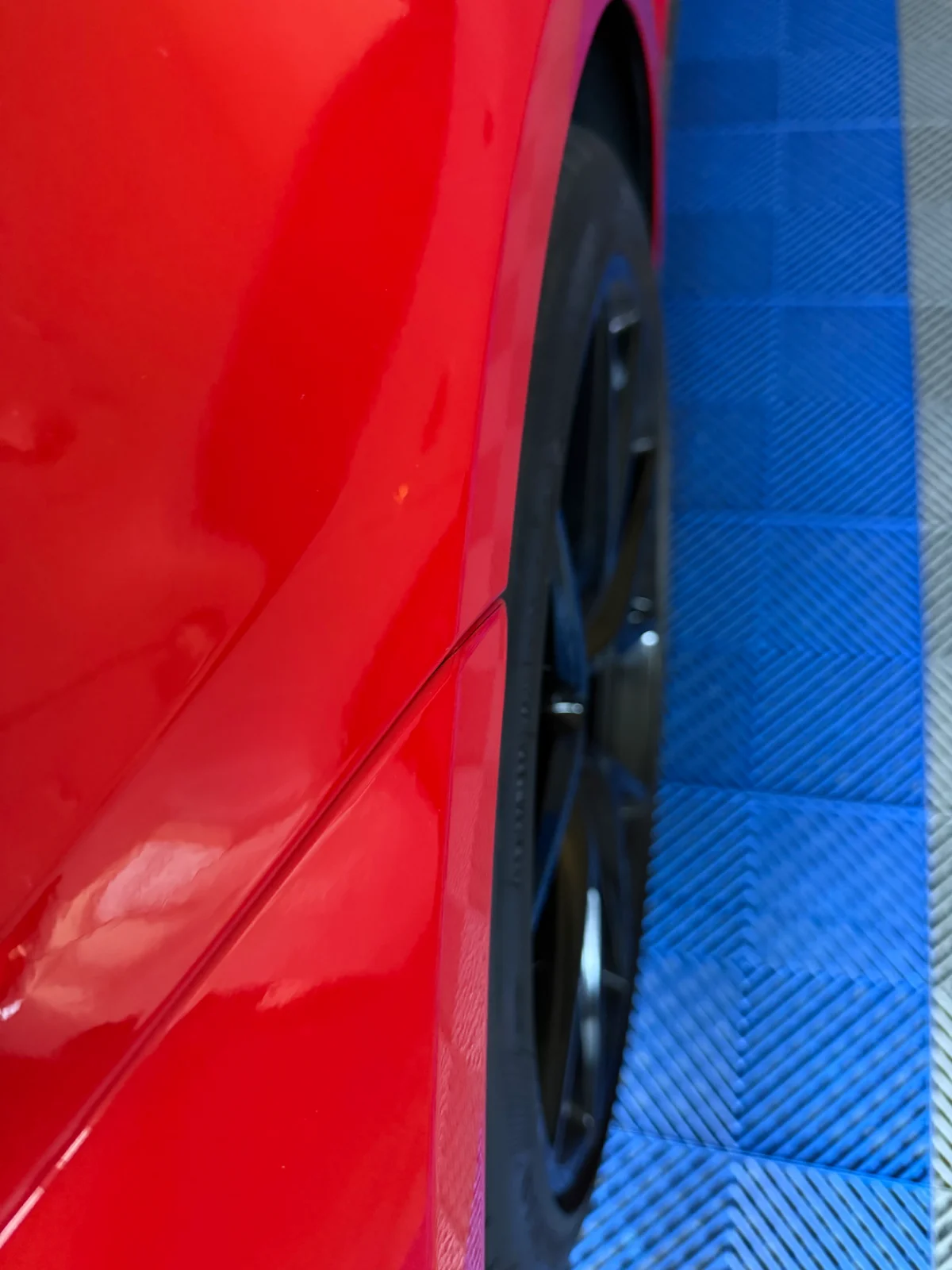

Mine was like this too, with drivers side bumper and wing rear wing not aligned and sticking out about 5mm, it would push back in flush by hand but would eventually pop back out again. Dealership said it's just how they are and it can't be fixed. But then when I had my door replaced for blistering, the body shop fixed it and it is now perfectly flush (even though the bumper is not next to the door). So it is adjustable and fixable.
Have we reached a consensus on this? mine has it too: View attachment 68320

same with my 2023. One side is fine the other you can try and push in but it just resets back to sticking out a little bit. With the issue's i've had, it's least of my worries!

Hi again Folks,

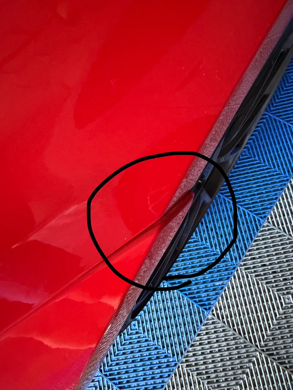

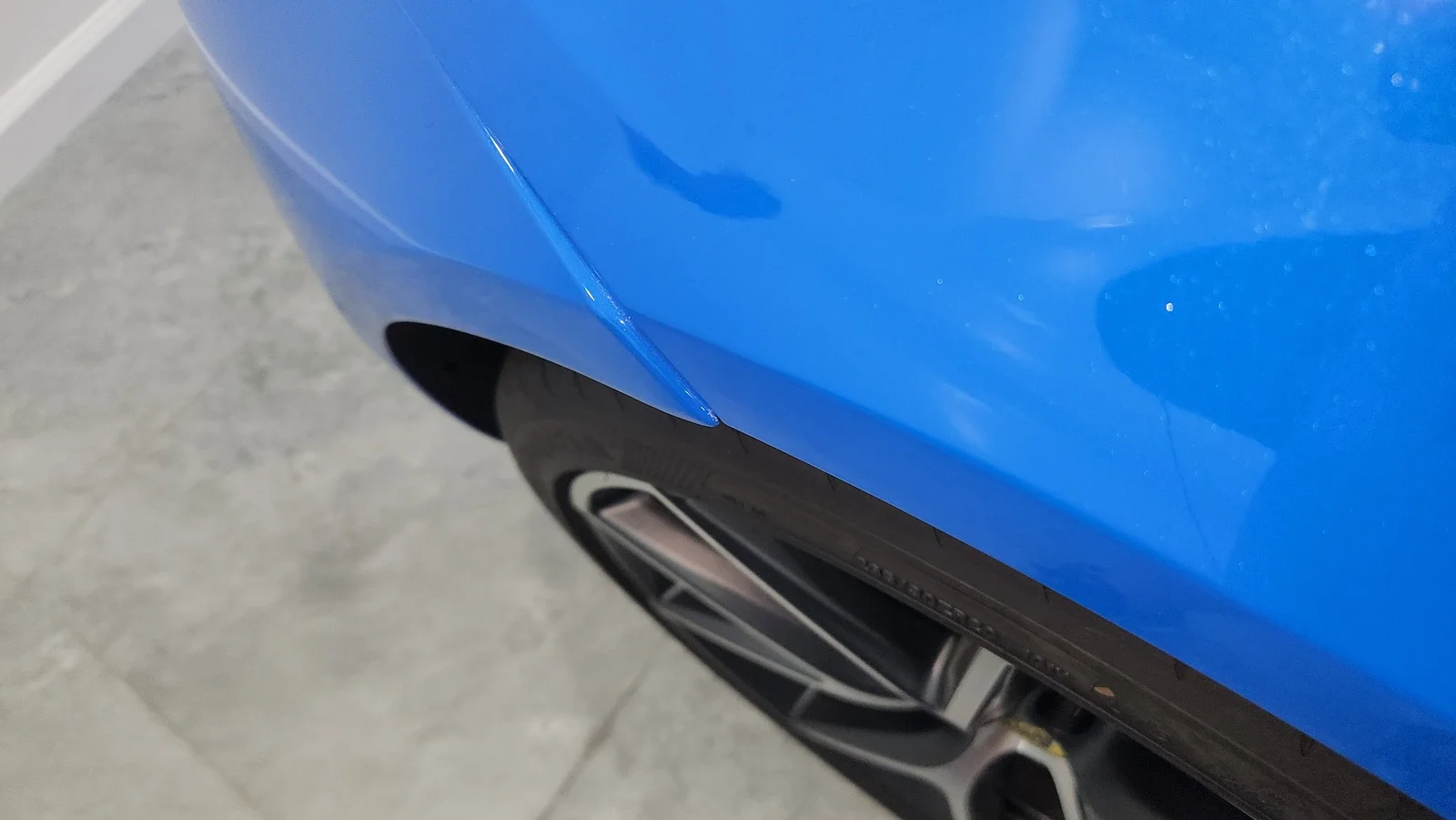

I got around doing this today. When I removed the rear wheels and liners, unfortunately I found that there is a lip in the top edge of the bumper but none on the fender's side (pointing to it on pic 1 ). Needless to say, my initial idea of joining them together with a U-clip couldn't work. I also found that the shown hex screw in Pic 1 which is meant to help secure the bumper's seam edge to the black block, even when tightened, still allowed a good amount of slack play (this is why I was getting a squeaking noise when I pressed on the bumper).
What I did instead, was that I aligned the bumper and fender, drove a small hole between the black block and the top bumper lip and placed a screw to secure them together as shown in pic2. I also placed a small piece of foam tape between the black block and the fender. I'm happy with the outcome as now, the 2 panels are perfectly aligned (Pic 3), and the bumper edge seam feels more firmly in place. Hope someone finds this helpful.
I asked a body shop to see if they can fix mine. They just used Toyota’s TSA fix “shim it with pads since there’s play”
I went to the dealership for this bumper issue. They said that the shims installed outward too much. There are pictures before and after.
