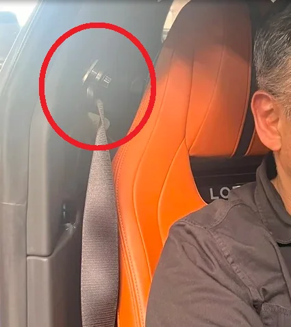

Will it allow the use of the plastic seat belt mount point covers, or do they have to stay removed? All the pictures so far show exposed hardware near the driver's head.

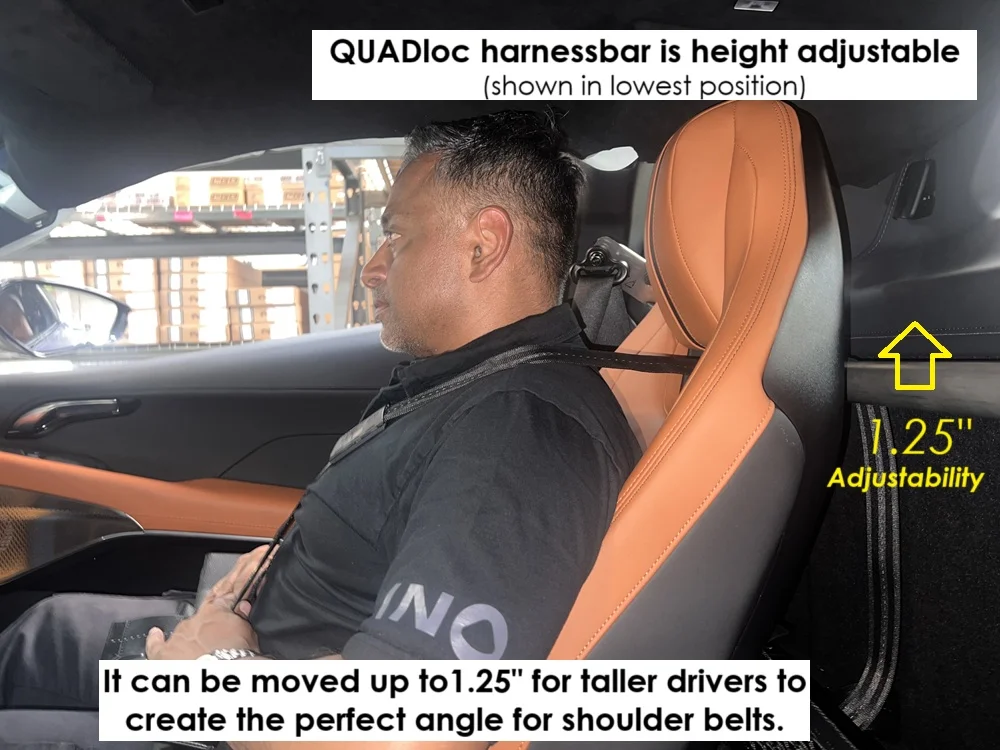

Installing a harness is our next step now that the bar design is complete and in production. The QUADloc offers slight adjustment so you can position the bar higher or lower. For most drivers, the belt angle will be at zero or horizontal. I will get pictures soon.

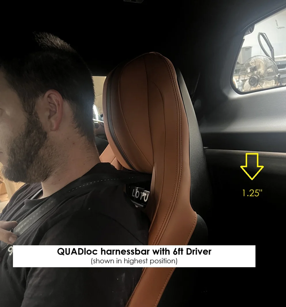

We confirmed the height adjustability - approx 1.25". This will allow ideal shoulder belt orientation based on a persons torso length.
Note the position of the bar vs the rear trim on the above two pictures. You can clearly see how much the bar has moved from the lowest to highest positions. Based on Schroth's recommendations, I believe the low position will likely work for the 90% of us.

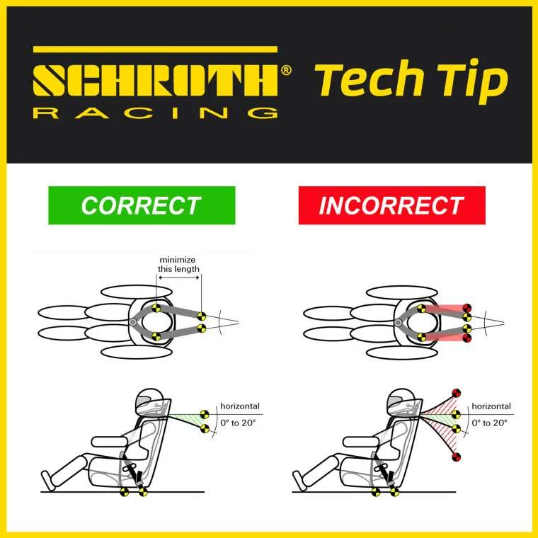

See Schroth recommendations here:

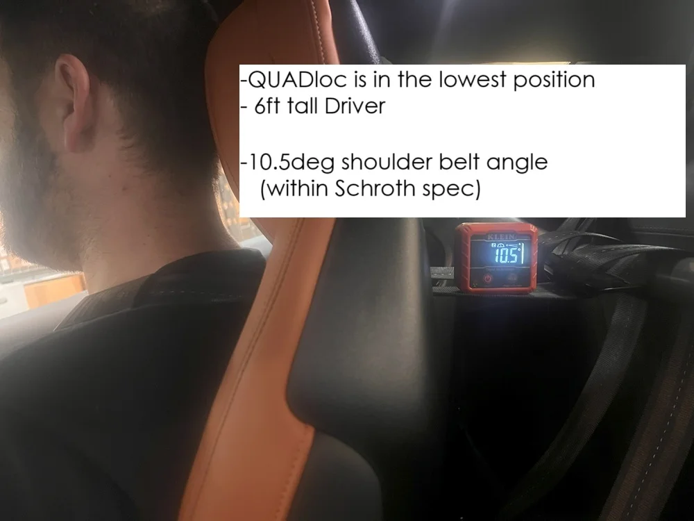

With our 6ft Driver with the bar in the lowest position. The belt angle is at -10.5deg. Within Schroth's spec. If we raise the bar, this angle will be reduced even further.
