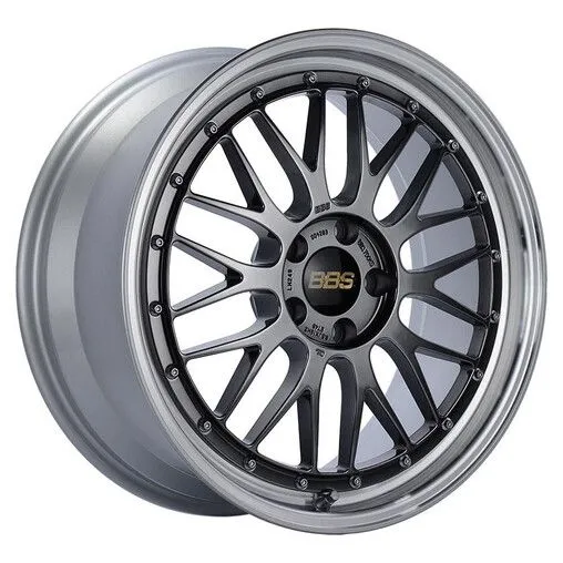

This turned out to be a real bear. I thought "No problem, I'll just switch out the Lotus wheels." HAH. It turns out the hub and calipers stick out so far, and the offsets are so high, that I had to literally take the wheel apart and modify it quite a bit just to make it fit. The wheel center has to be almost as far out as the rim edge to clear the caliper. For this style of wheel, you'd also need a pretty good sized spacer, unless BBS decided to make one specifically for the Emira.
