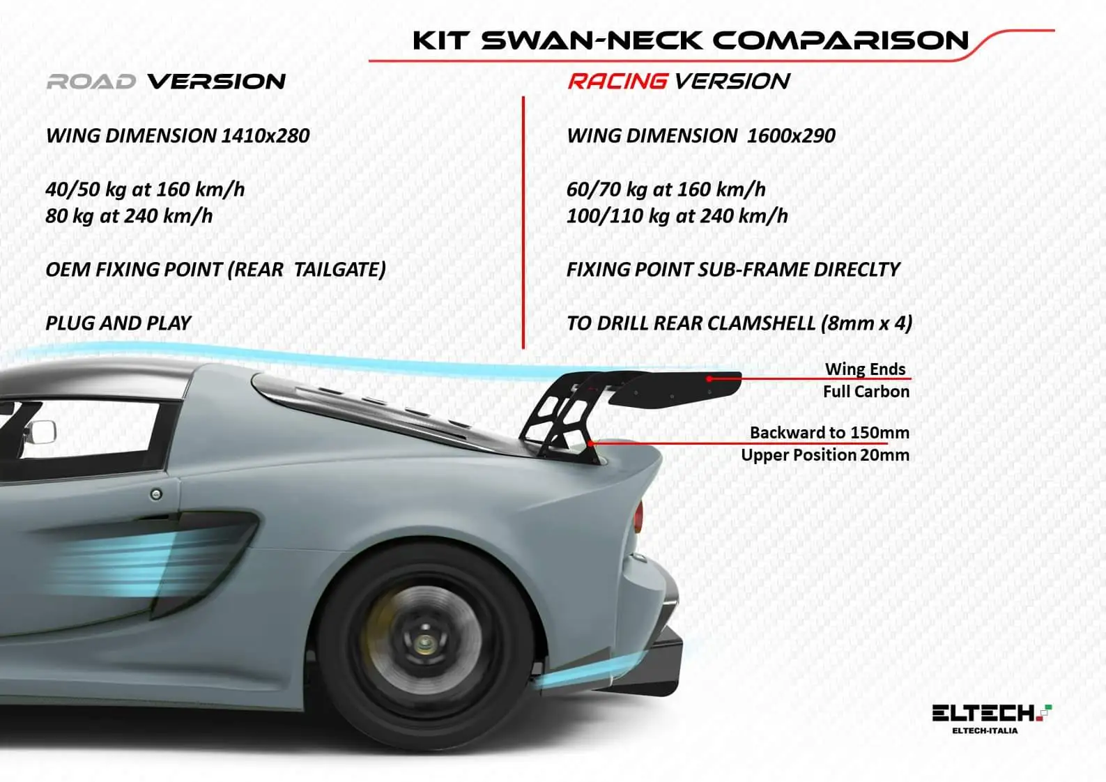

@Speedy Emira very good thread.
This is the company from Italy that has performance parts:
They have data we are looking for, but I don't know if they have parts for Emira:

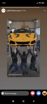

Good quality. 💪😁

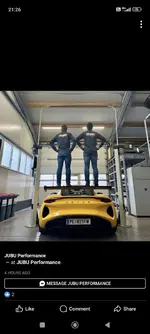

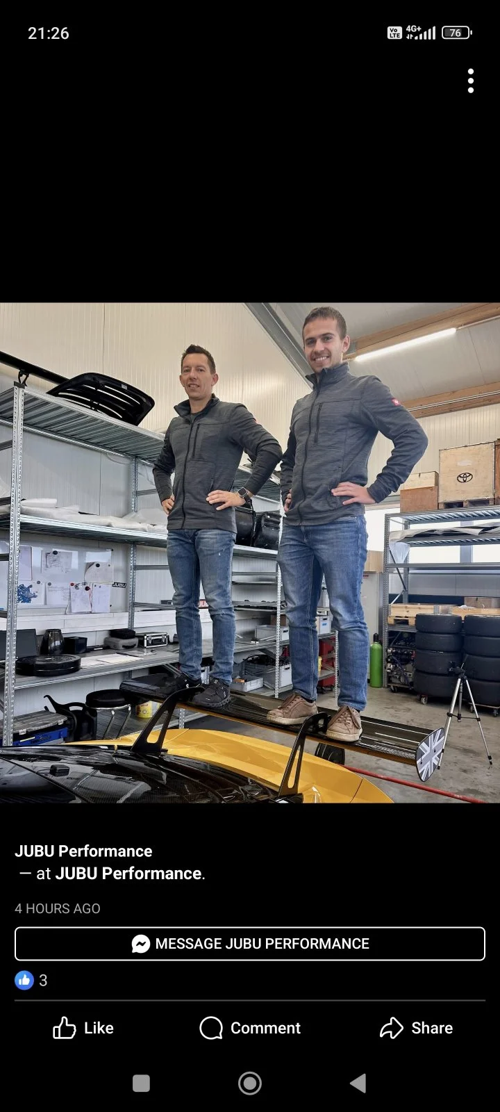

OMG!!! 💪🤓
Here is a very impressive video showing the strength of the JUBU front splitter. If you had any other type would you dare do that even on your own?
