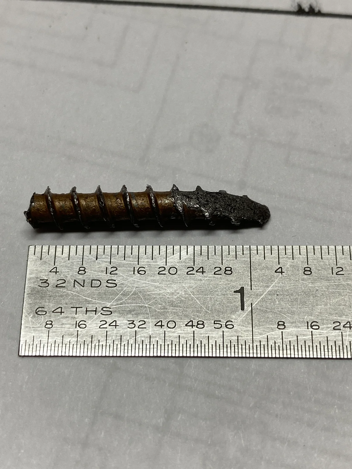

Ok, so I extracted it and this is what I found. The smooth shiny side was flush with the tread.

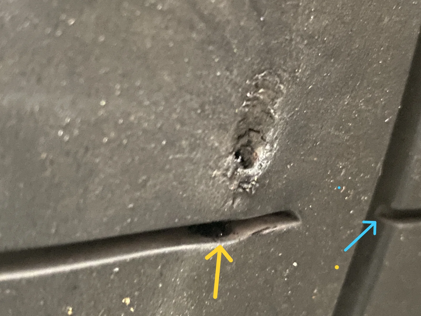

It went into tread sideways, went through one of the side channels and kept going into the other side of that channel. You can see the hole in the side of the side channel here (yellow arrow).

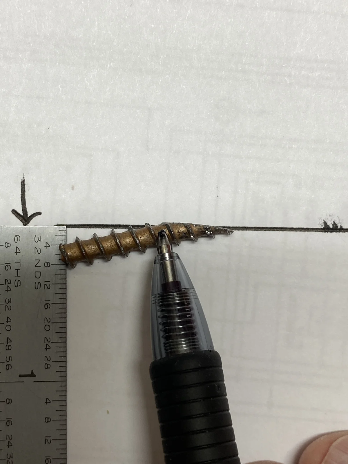

Not sure how deep it went but no loss of air yet. There was likely a slight angle which I’ve tried to estimate here. From this it appears the very end could have been down 8/32 from the surface.
My main tread is currently measuring 6/32 and the side channels are measuring 4/32, so I’m a bit concerned. Should I be? Also this thing left a decent gouge in the rubber. Is this a concern? And since I likely can’t patch if it’s not all the way through to the inside, can this (should this?) be repaired some other way? (Non-tracked car, occasional spirited drives). Really want to avoid replacing the tire but want to be safe.
Ok, so I extracted it and this is what I found. The smooth shiny side was flush with the tread. View attachment 81122It went into tread sideways, went through one of the side channels and kept going into the other side of that channel. You can see the hole in the side of the side channel here (yellow arrow). View attachment 81123Not sure how deep it went but no loss of air yet. There was likely a slight angle which I’ve tried to estimate here. From this it appears the very end could have been down 8/32 from the surface. View attachment 81124
I like the measurement! If it were me I would take it to beckers and ask for their professional opinion. I’ve had a nail removed where it never punctured the tire and they said I’m good. They don’t charge me anything and it never caused a problem. Another time they patched and also no problems. Id rather get a professional opinion than guess. they are plugging tires all the time.
Tire holding air properly; only tread rubber outside of bands violated leaving a small “tunnel”. Consider packing/filling tunnel with something like liquid FlexSeal to keep small area from chunking and for piece of mind. Tire structure probably not compromised. Interested in result if go this route……………….

I’ve reviewed your post more thoroughly and now noticed you are not seeing a loss of air. Consider spraying some soapy water on that area and look for bubbles. If you took it to a tire shop one of the first things they would probably do is dunk your inflated wheel & tire combo in a tub of water, if they don’t see any bubbles they may just call it good to go.

No worries and thanks for coming back with this thought. I forgot to mention in my previous post that after I extracted the screw, I did a soapy water test and observed no bubbles. But I did so with the damage at around the 4 o’clock position, (due to a car in the way behind it in my driveway) so the water didn’t have a chance to sit and puddle. May repeat this test with the damage at 12 o’clock and also check the pressures again tomorrow.
So it sounds like if I’m not losing air, that may be a good indication it didn’t penetrate/damage the belts. Would that be cirrect?

@GrahamClark_60-68 Your post #34 notes “belts”- bands/belts , referring to the layers of material, kevlar, steel, fiberglass, etc that are the “carcass” of the tire over which rubber applied as tread/sidewall. I note on my Michelins, soft tread, many small rocks/pebbles will imbed in the tread, sometimes mimicking a nail/screw head. When plucking them out, small “divot” remains-belts not vioilated. Your sideways screw damage would not concern me.

I can’t determine the extent of the damage over the internet.
Consider going to a tire shop you trust so they may look at your tire in person and give you their opinion.
To look for belt/cord damage, the tire would need to come off the wheel to provide a look at the inside of the tire.
