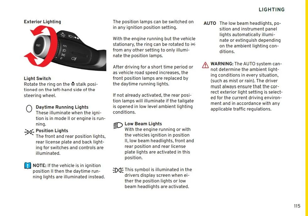

Likely DRLs. Here's the page from the manual:

How very confusing. Rather there not be a light on the dashboard just for DRL’s. The green position light is always on regardless.

Yes very confusing, I'll speak to my dealer/agent!and see if they can find out.
Does the RESET button work?
The whole section under '0 daytime Running Lights' from the handbook is hard to understand..
Do the rear lights come under DRL's definition too? As 'after after short while driving' the position lights still stay on. Every other newish car with DRL's including Evora etconly use only front ones if I remember correctly.
Anyone able to explain all this better to me please? Maybe Volvo/Geely use the same system in other cars.
