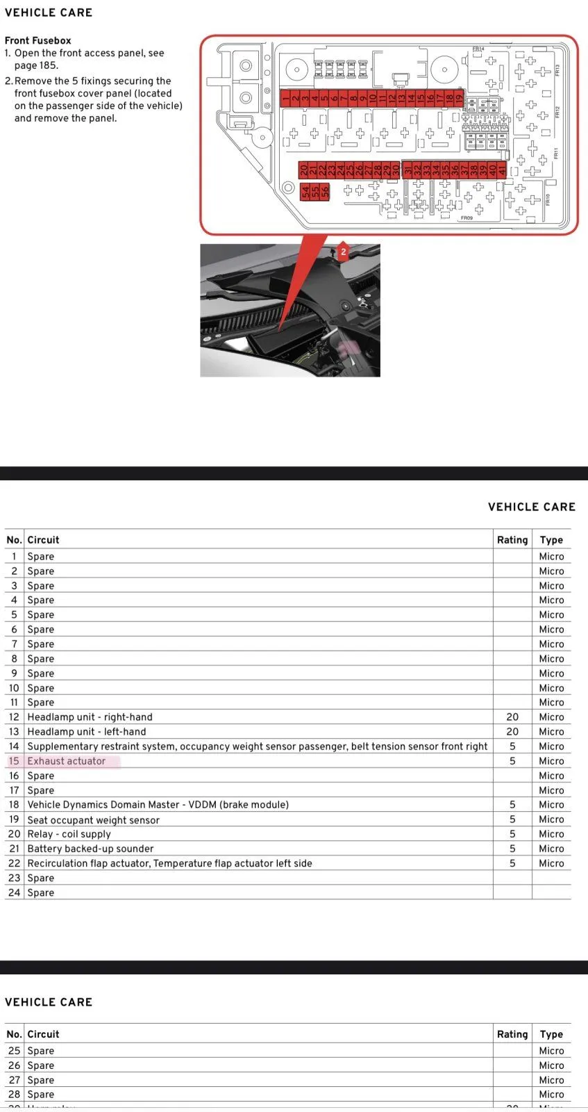

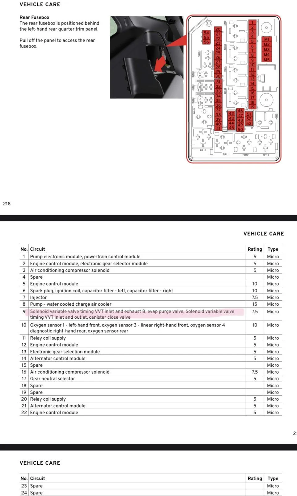

So I have found the below related fuse relays in relation to the exhaust valves control. Wonder if any has figured out a way of hacking this to have the valves permanently open without calling up warning lights?
Hi everyone,

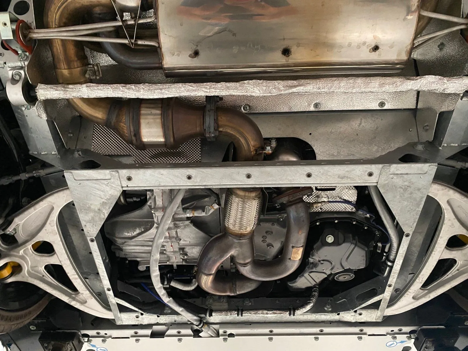

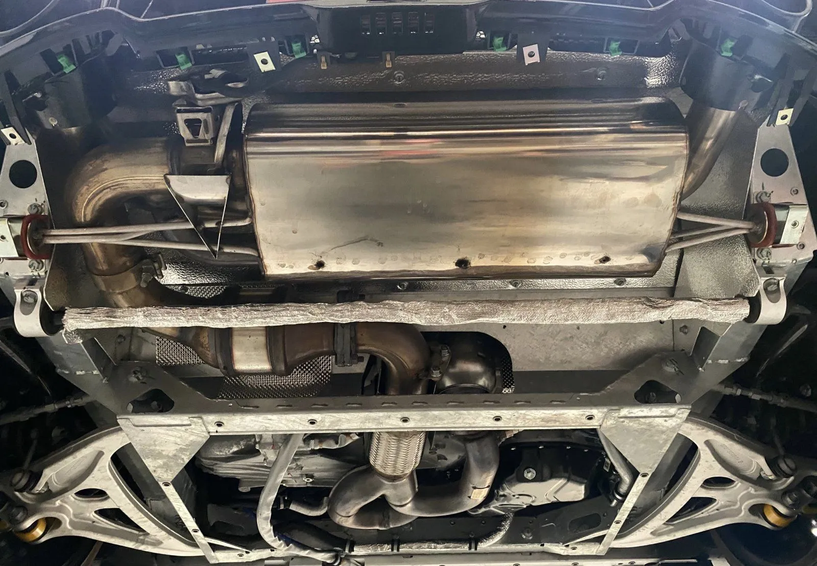

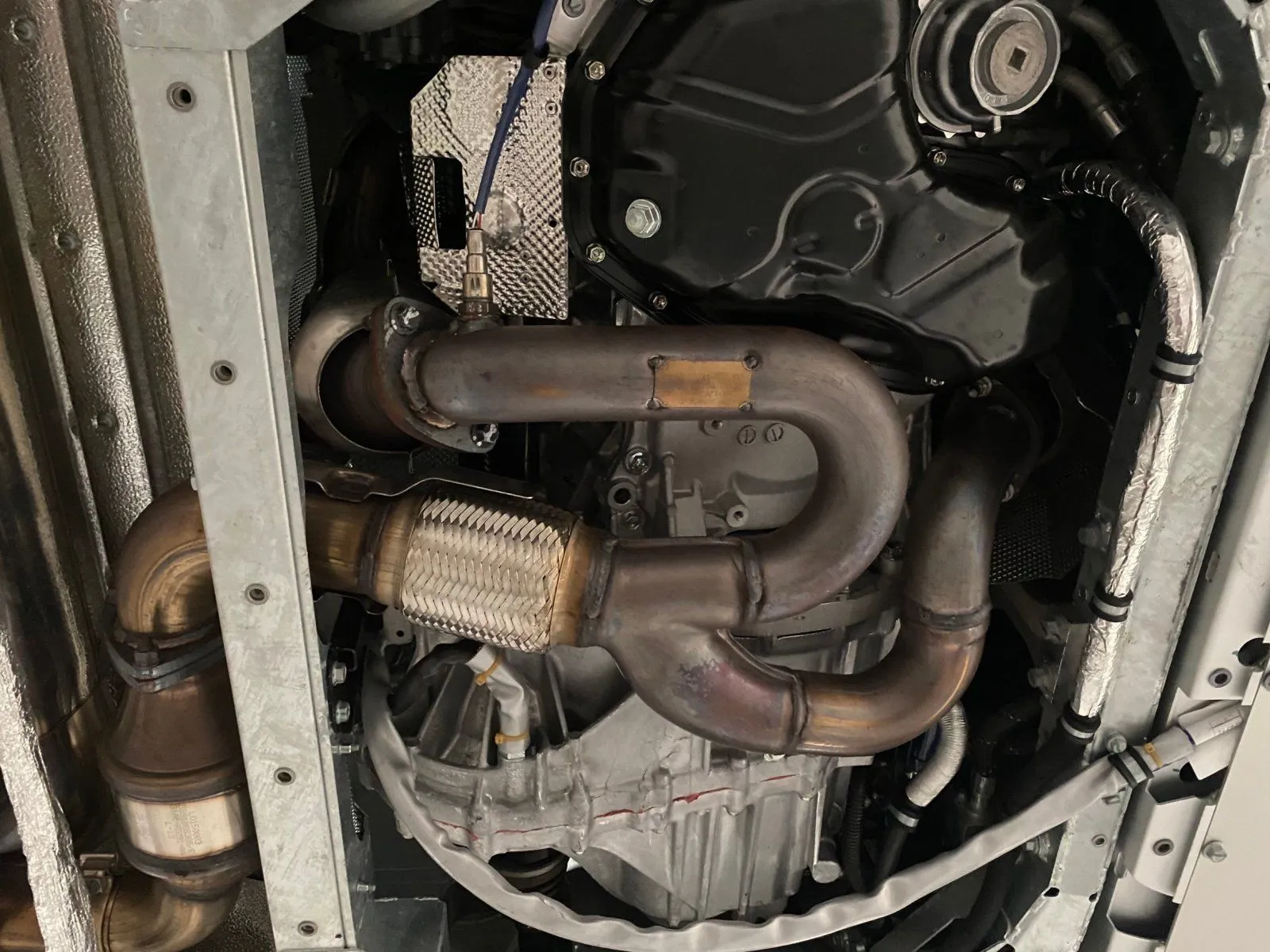

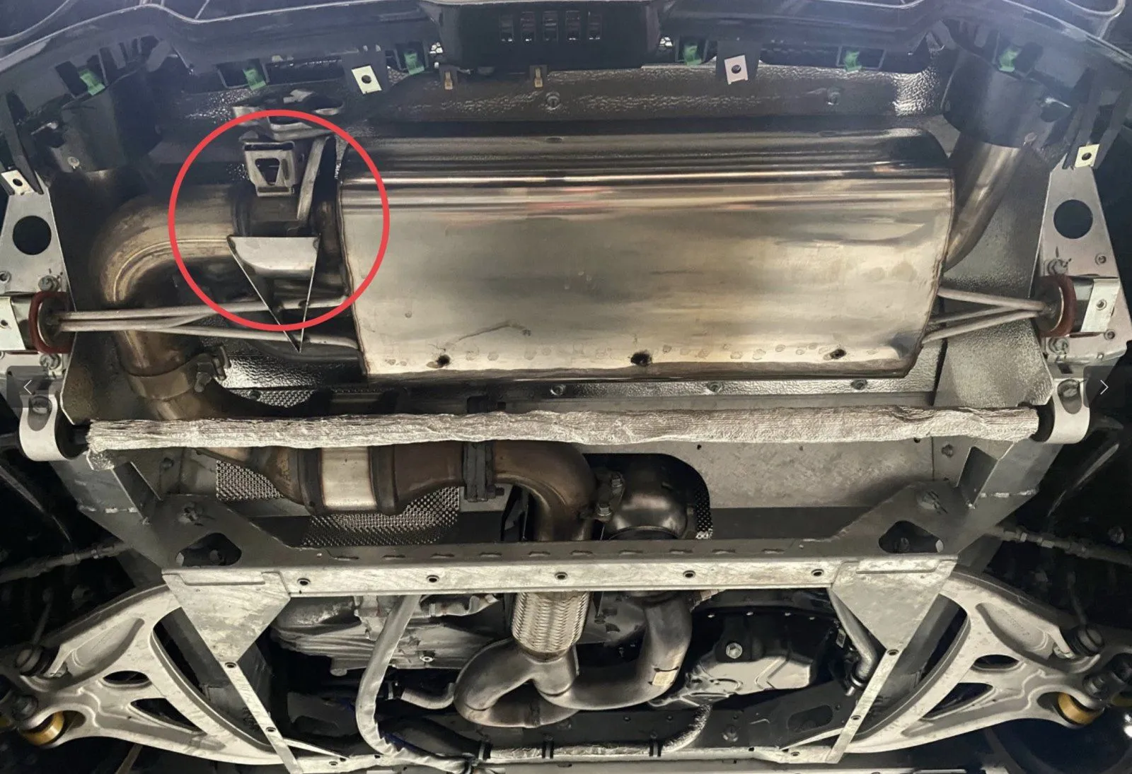

Am I seeing this correctly? Only one side of the rear dual exhaust tips are functional?Would anyone be able to point out the location of the exhaust valves please?
View attachment 22803View attachment 22804View attachment 22805

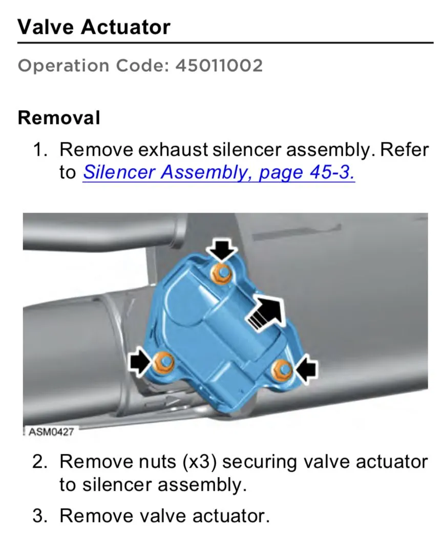

It looks like that.
Thanks, now that I know where to look, I can just see a bit of the other side up above on that other side.No, you are not seeing it correctly. The exhaust exit is not visible in these photos.

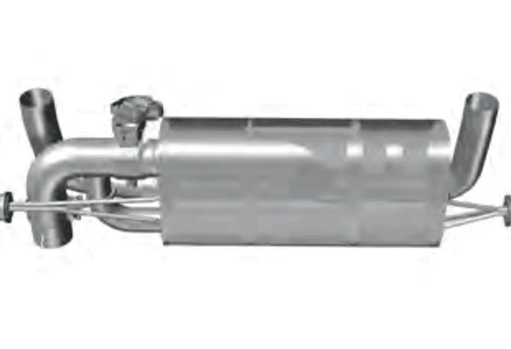

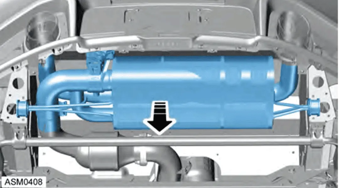

See below, the exits are higher than the inlets:
A view of the silencer assembly out of the car, for clarity:

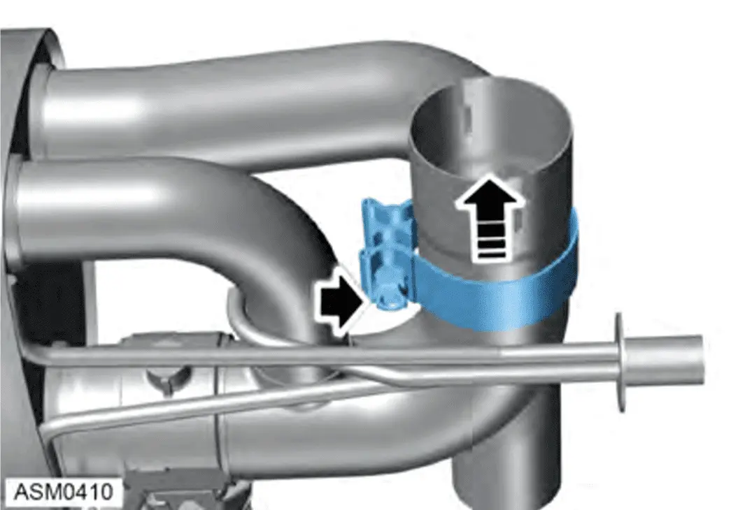

And here's a reverse view of the inlet side (left) as though looking toward the rear of the car. Exhaust valve is at the bottom left, in the inlet pipe. When closed, diverted flow passes through the smaller pipe on the way into the silencer.
Ignore the arrows printed on the image, those are part of the disassembly instructions.
