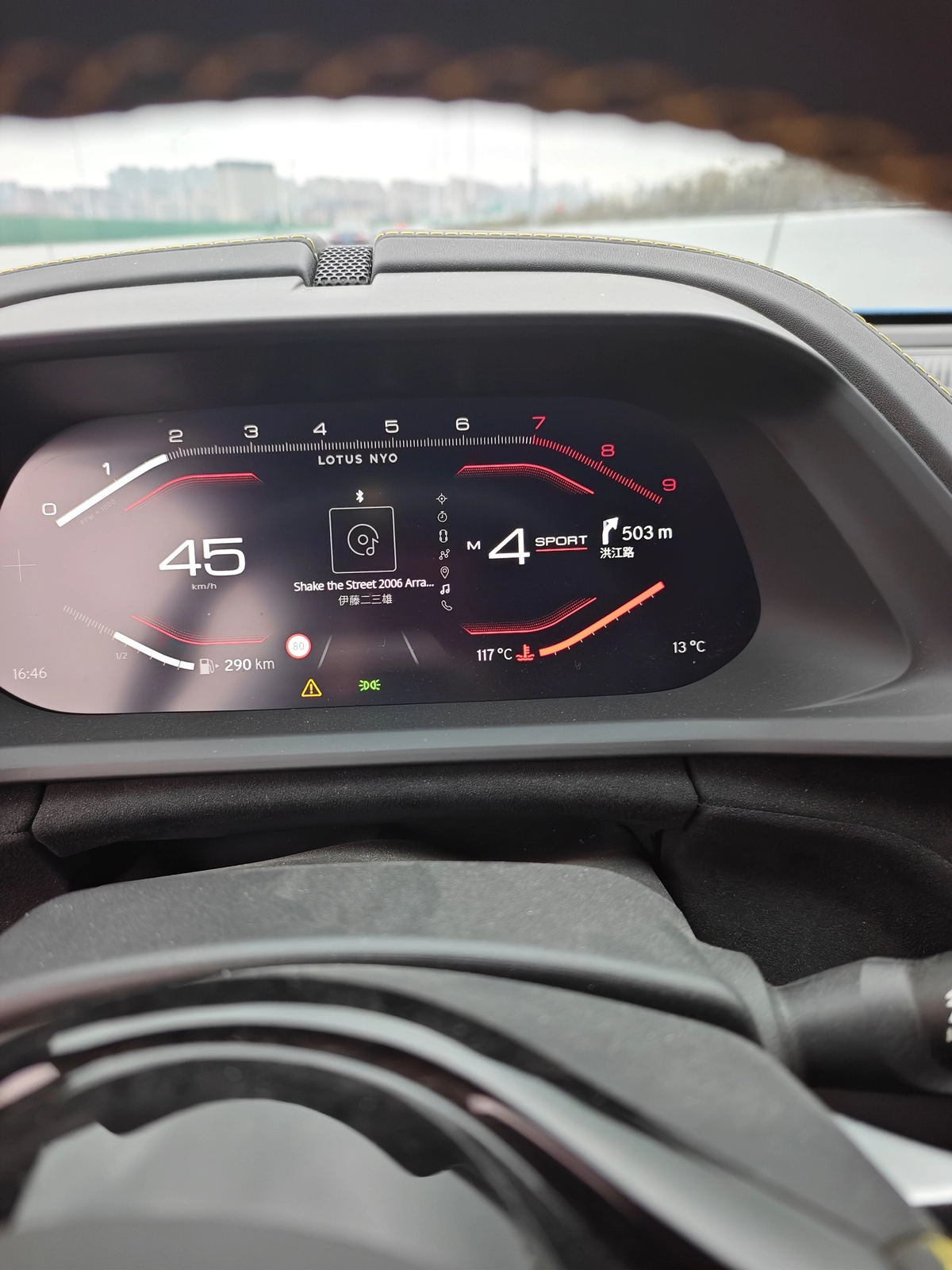

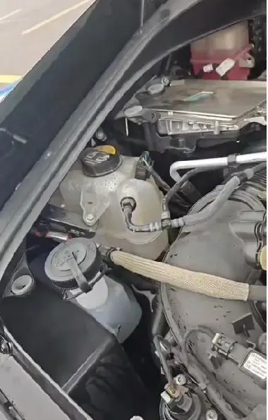

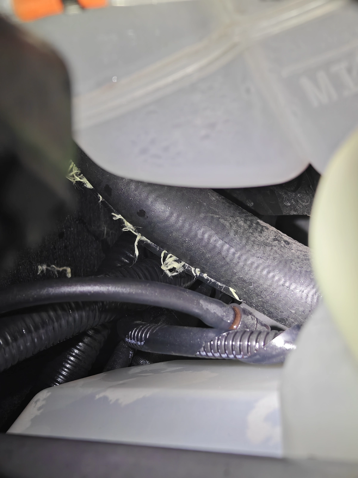

While driving my EMRIA very gently for around 6km, it suddenly displayed an overheating warning. When I pulled over, I found the antifreeze coolant had competely leaked out. Calling a tow truck ,taking the car to the LOTUS dealerfor inspection. Upon examination, it was confirmed that the cause was a BURST COOLANT HOSE. The vehicle has had 2 oil changes and 17,000km of safe driving so far.
What exactly caused this issue? Was it a material problem, a design flaw, or an assembly error ?

That's quite a catastrophic failure of the hose. It does look like a failure of the hose, rather than an assembly error (which would show by a hose coming loose for example).

Agree, though looking at the picture, and the fact the split is lengthways rather than across the hose, makes me wonder if it accidentally got slashed with a box cutter (when unpacking a bunch at the factory).
That's a very good theory, very plausible. I don't think I've ever seen hoses burst in that manner organically, but my sample size is small.
Usually it's a small split by outside radiuses or where there's trauma from clamps, chaffing, etc.

The lengthwise split is consistent with a pressured-induced failure (the stresses in a pressurized tube are twice circumferentially as compared to longitudinally). It could be due to a material defect or damage induced from handling as some have indicated.

Just had this exact failure in my, just over 12 month old, Emira i4. 30,000km on it. Just straight split in an identical manner. Had it towed to the mechanic and now waiting on the part. It is my daily so putting on some serious kms
