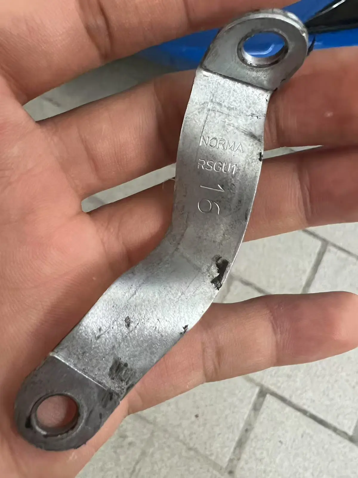

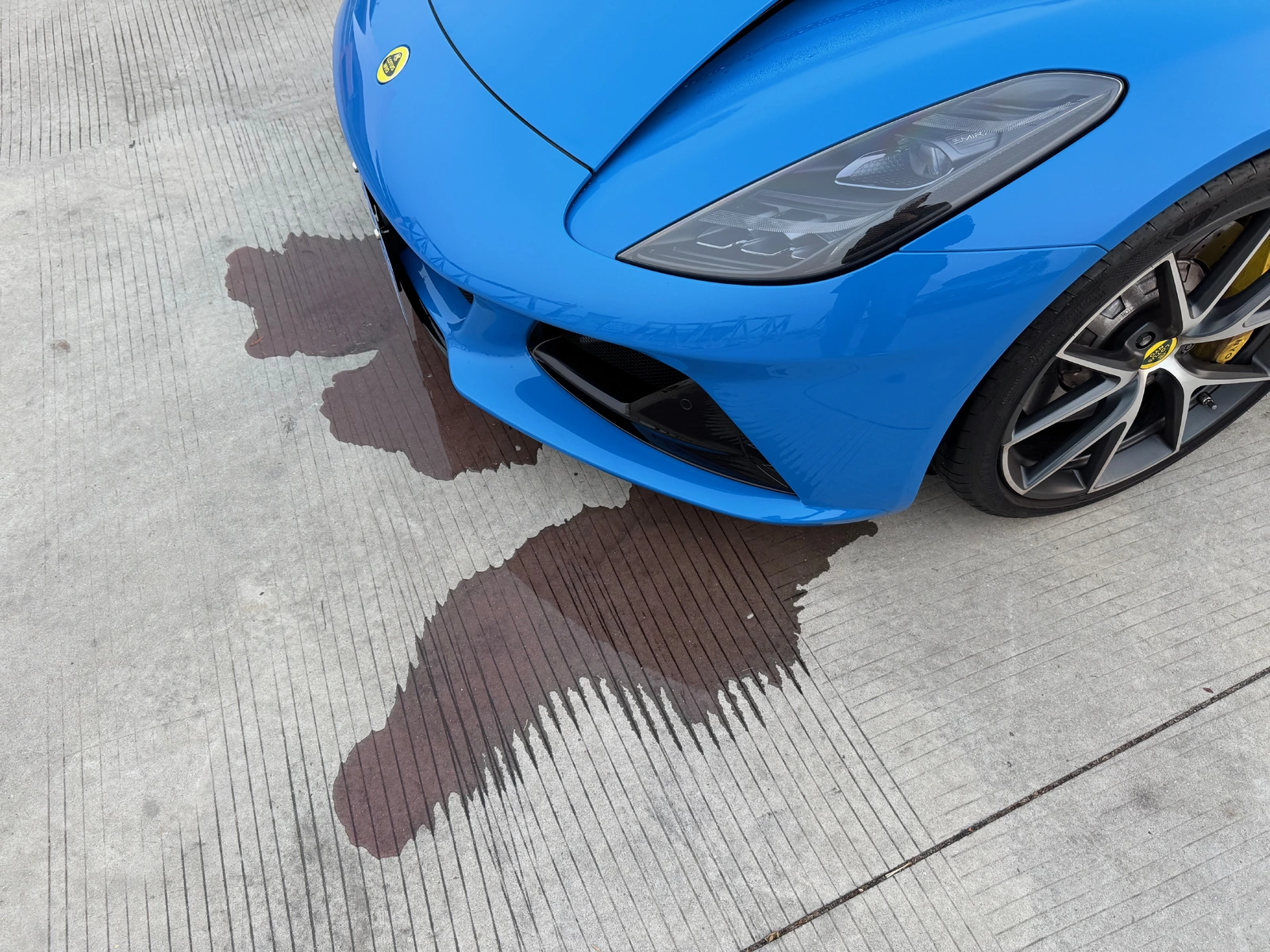

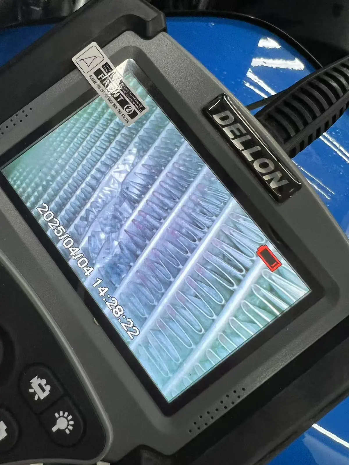

Recently, while driving my Emira, I received a 'Coolant Temperature Too High' warning. After pulling over, I noticed coolant rapidly leaking. The service center later found a loose P-clip in the front trunk (frunk). They suspect this P-clip likely caused damage to the radiator, leading to the rupture.

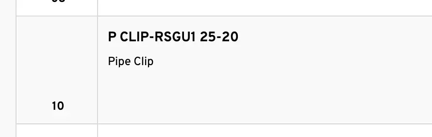

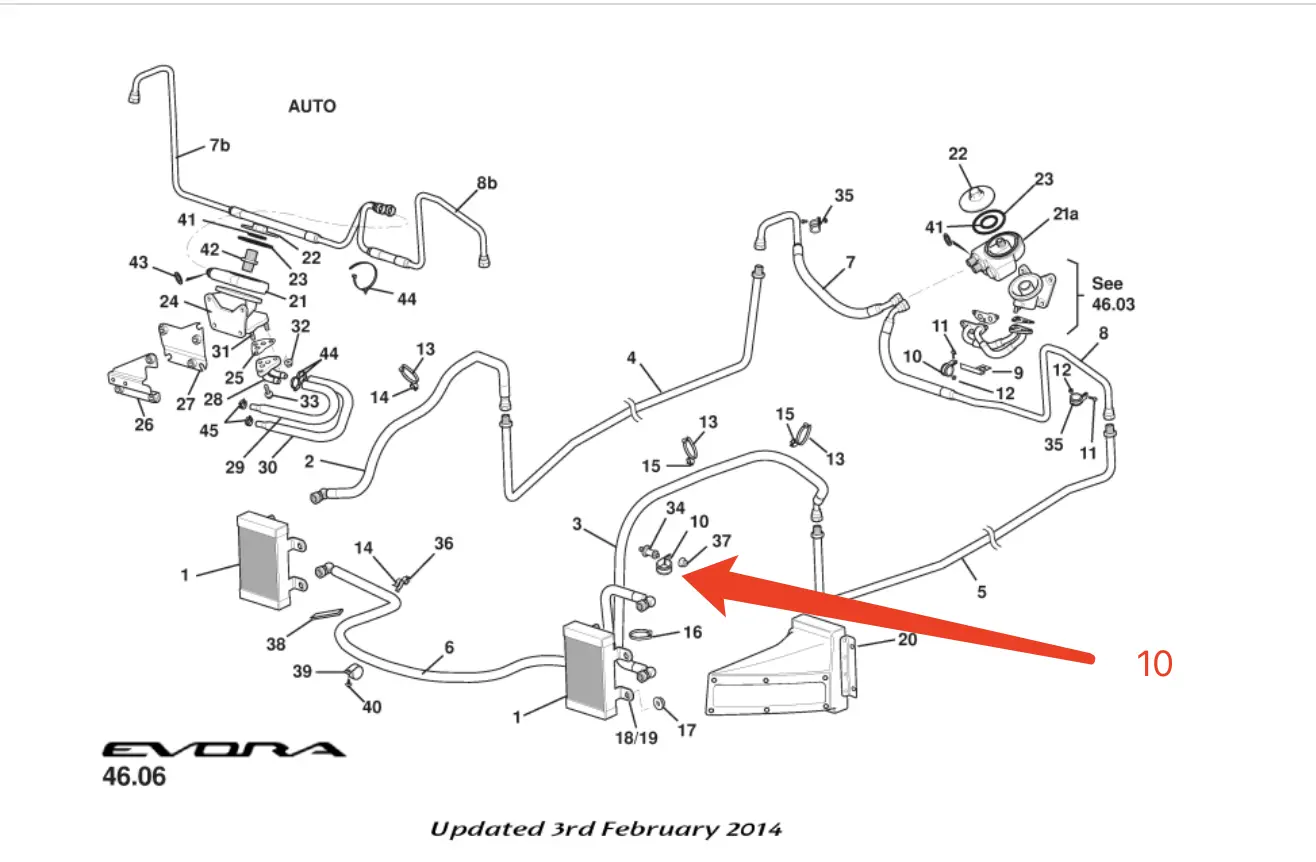

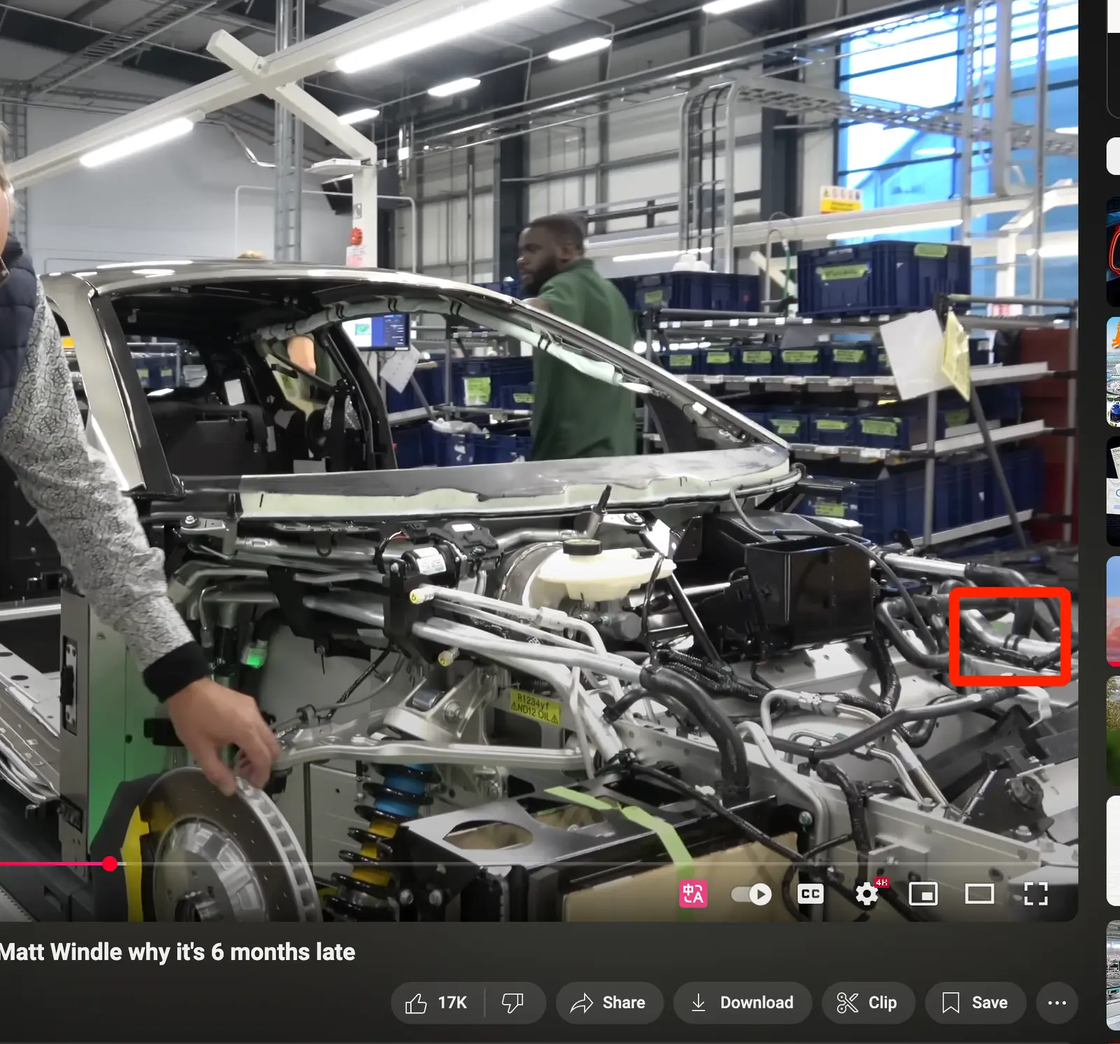

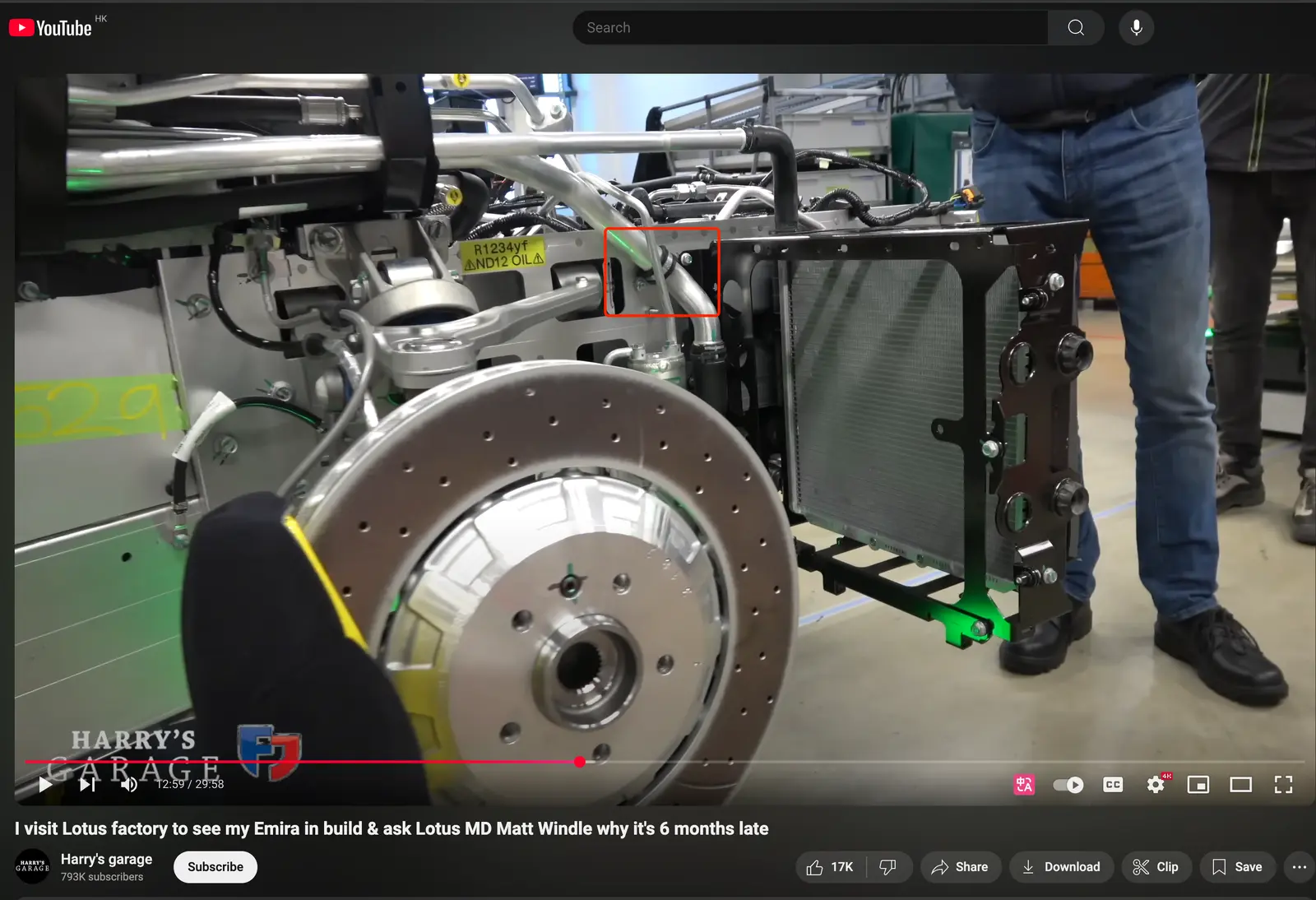

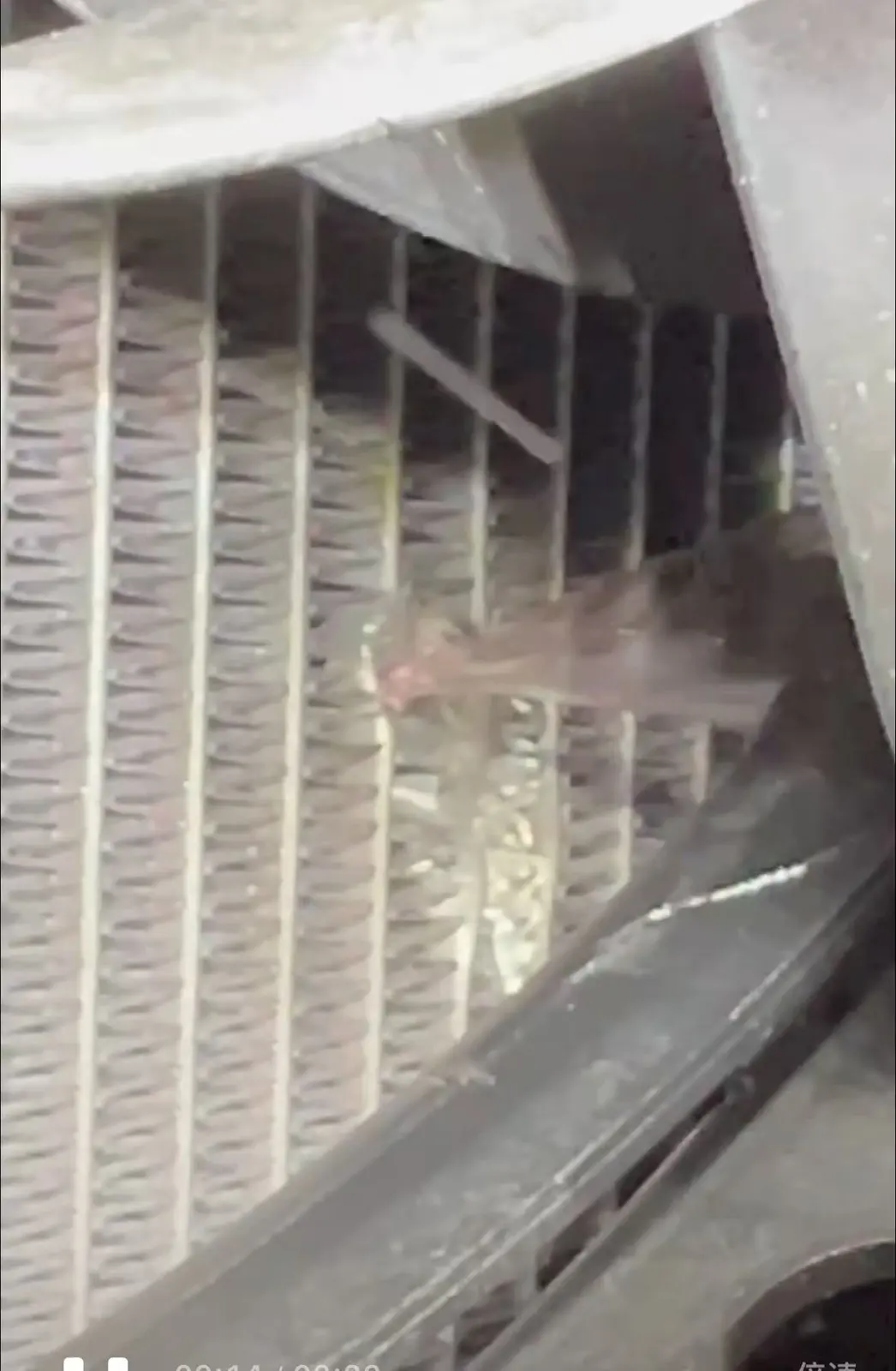

I checked Lotus Evora's service parts catalog and found a similar component Evora:Twin Oil Cooler System Engine / Transmission. And I reviewed Harry's video of visiting Lotus‘s facotry, there was a similar P Clip on both side of the Emira.
Could this P-clip be a missing part from my Emira that came loose, or was it accidentally left behind during factory assembly?
