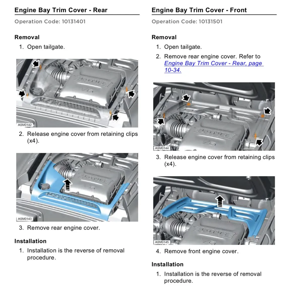

Has anyone found an easy way to remove the 3 cowls around the engine.
I've tried what the manual says,but can't seem to be able to shift them,don't want to break anything.
Hopefully an image locating the clips will give you the location and some confidence to tug a little harder.
Thankyou,far more precise location than the book
