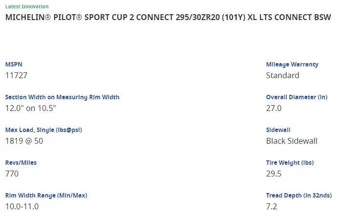

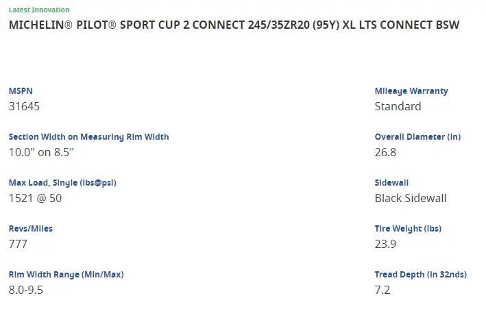

Verified Cup 2 Connect 240, in Michelin's listing as LTS marked, and matches Emira's sizes.
Front:
Rear:
Wait what?? Why would Lotus call them "Michelin Pilot Sport Cup 2" when the "Michelin Pilot Sport Cup 2 Connect 240" is a materially different product? Just the marketing people getting mad about the length of the name?
If I had known they were shipping these with the 240 tire I would have chosen that spec rather than the Goodyear.
Front:
Rear:
