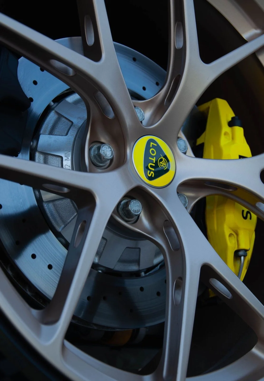

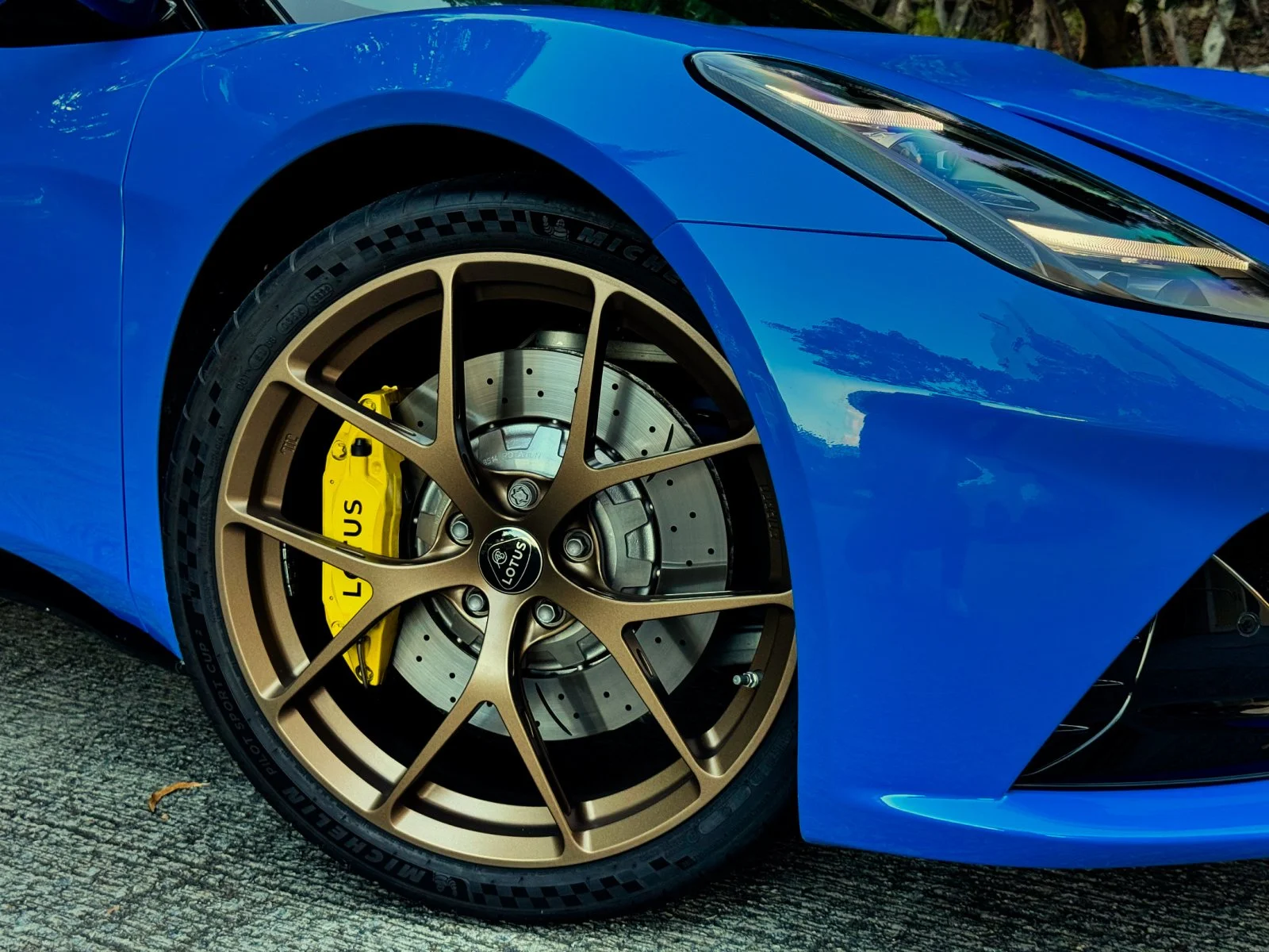

Finally got around to installing mine. My V2s in custom deep bronze.
