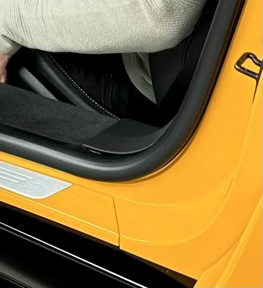

My car has a minor door seal imperfection on the driver side. Slightly different to what has bee shared so far but I'll add it in anyways. The plastic trim that goes up to where the seatbelt attaches should be under the rubber strip, but about half way down it comes out and the strip goes under the plastic causing it to be loose. I think it will be a very simple fix so I'm not worried about it just now. The actual rubber strip seems to be wrinkle free.
Driver side:
Where the seal crosses over
Passenger side
Looks like a couple of clips haven't been pushed in. Should be a very simple fix.
I tried just pushing it and it didn't go so I'll get a trim tool and run it down the rubber and I reckon that will unstick it and let me seat it fully.
One of the trim clips might not be centred in a hole, so you might possibly need to pull it off a little bit first and adjust before pushing it in.

Went down it today using a trim tool, just basically un-tucked the rubber and pushed the trim back into place. Went straight into position, the rubber looked like it had curled up a bit but after massaging it into place it all looks good. Easy fix!

Just as I suspected, easy fix. This is obviously an employee training issue (not a parts quality one).
