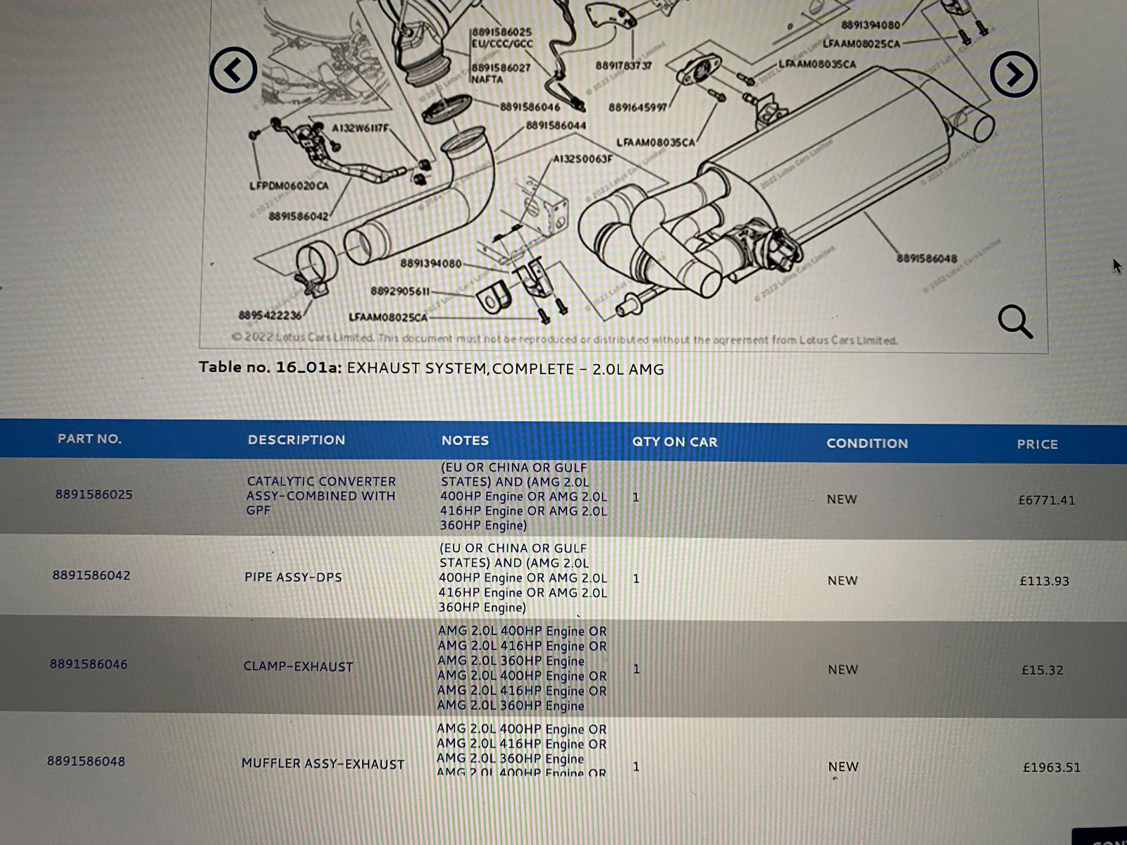

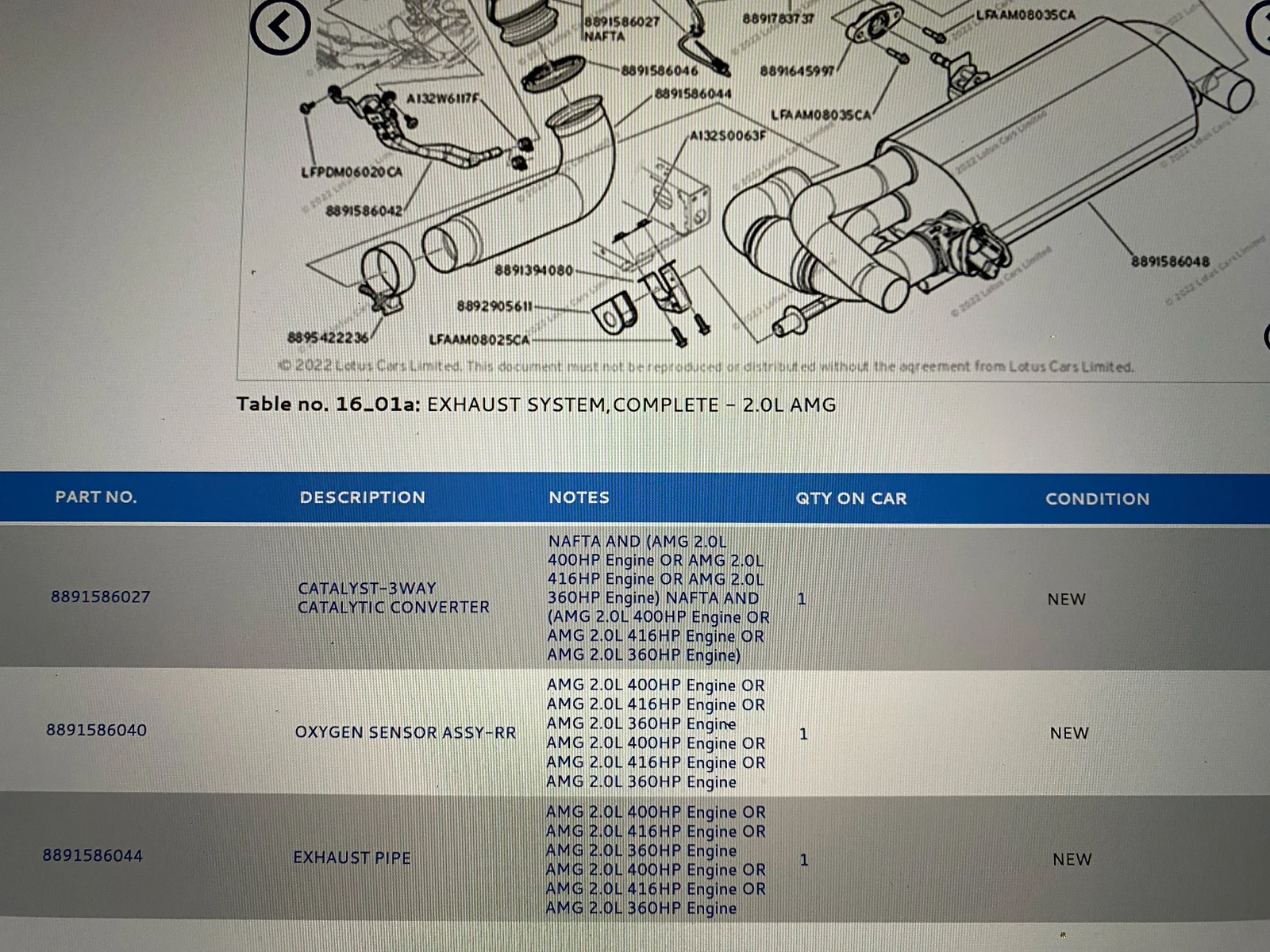

I had to google OPF (otto particulate filter). This is synonymous with GPF (glass particulate filter) and in the i4, there is no specific GPF like the v6 has.
But @Kaz changed his DP to the Aerie and his race shop think that because our i4 has such a huge honking cat, there is probably a GPF in the OEM cat. I have the GRP cat to install yet.

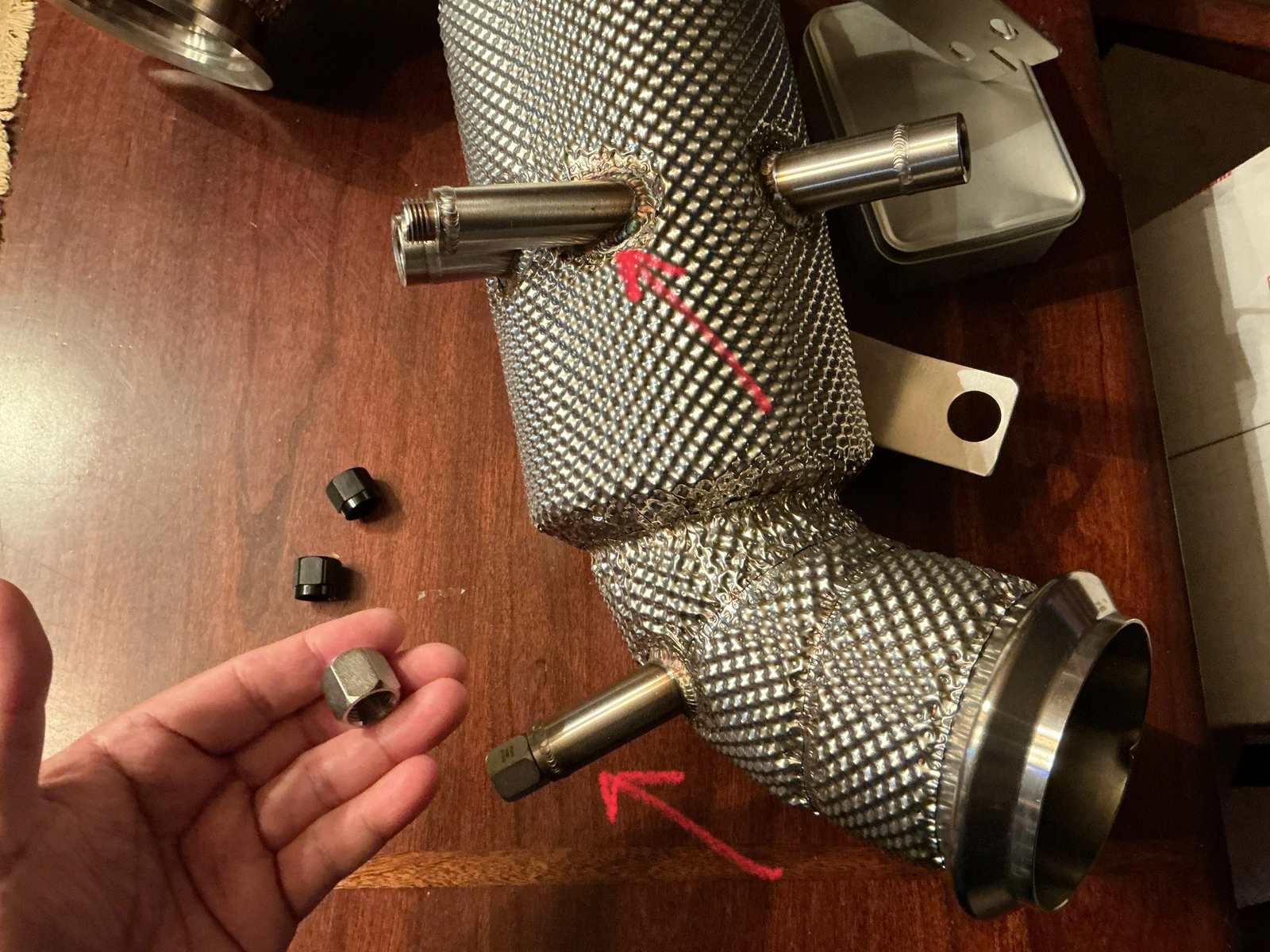

One thing you’ll have to let Mach5 know though is that the US model cats do not have the two DPS (differential pressure sensors) going to the cat so they will need to supply you with aluminum or stainless caps for these two ports.

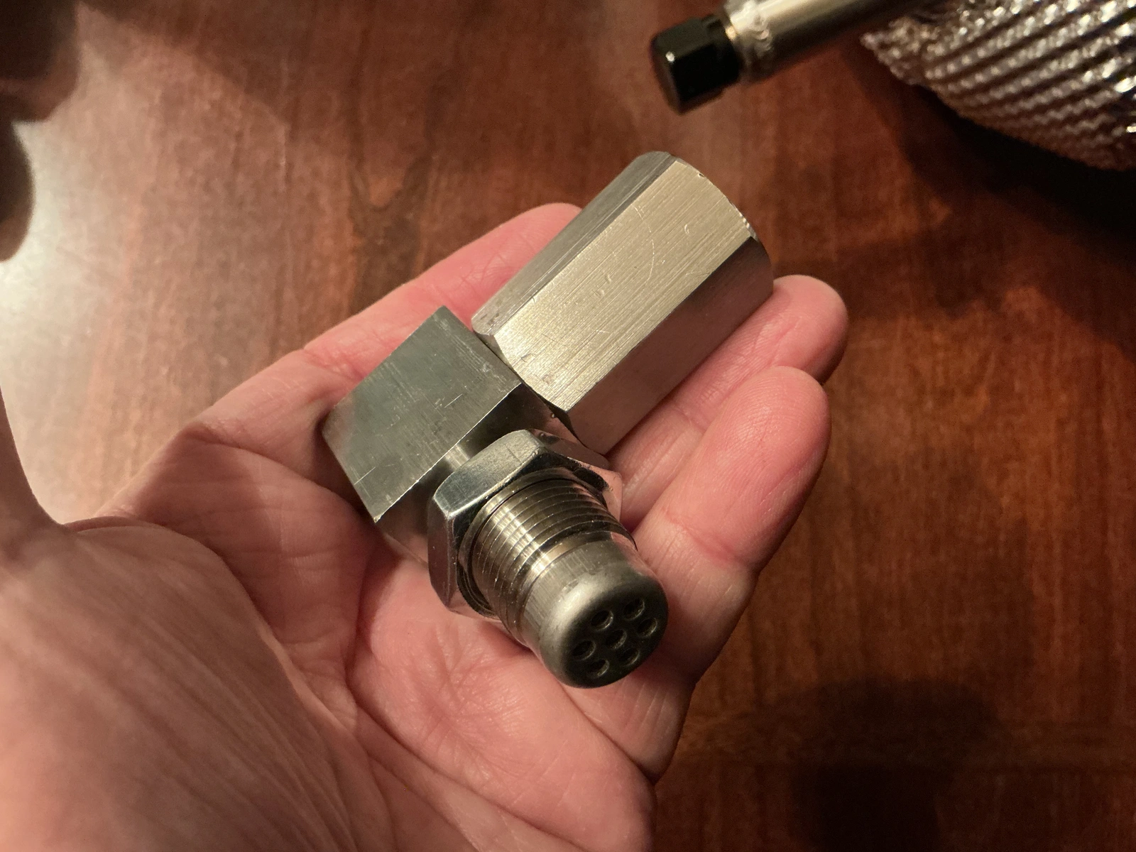

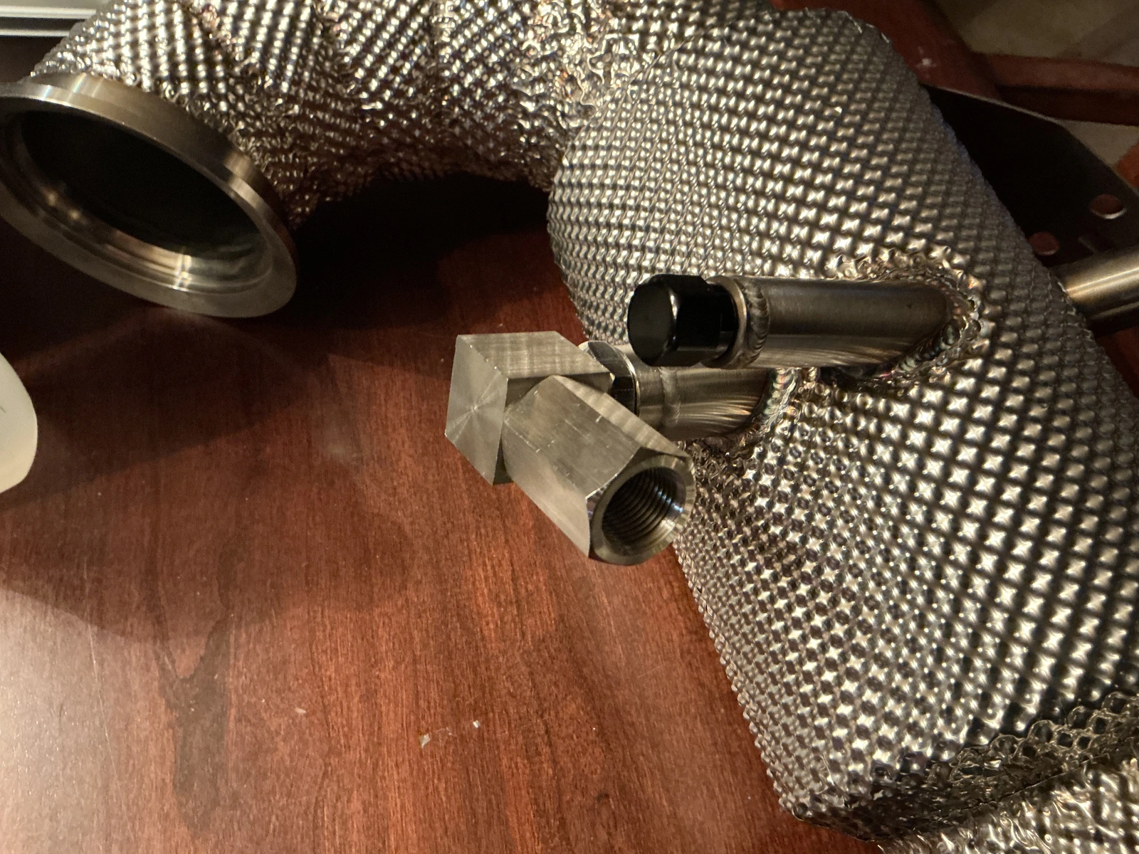

And you should probably ask Mach5 what their recommendation is if you should throw a post cat O2 sensor code after install. The Aerie cat throws codes, dont know if the GRP one will yet. But Kaz and I have 90 degree bend sensor spacers to try to eliminate any post cat O 2 sensor codes.

Thanks for the photo, I sent it to them and they have a version without those 2 pipes and claim no CEL.
