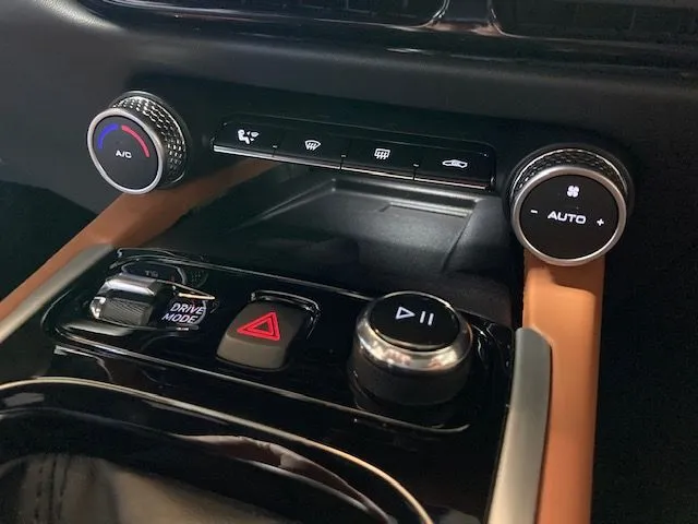

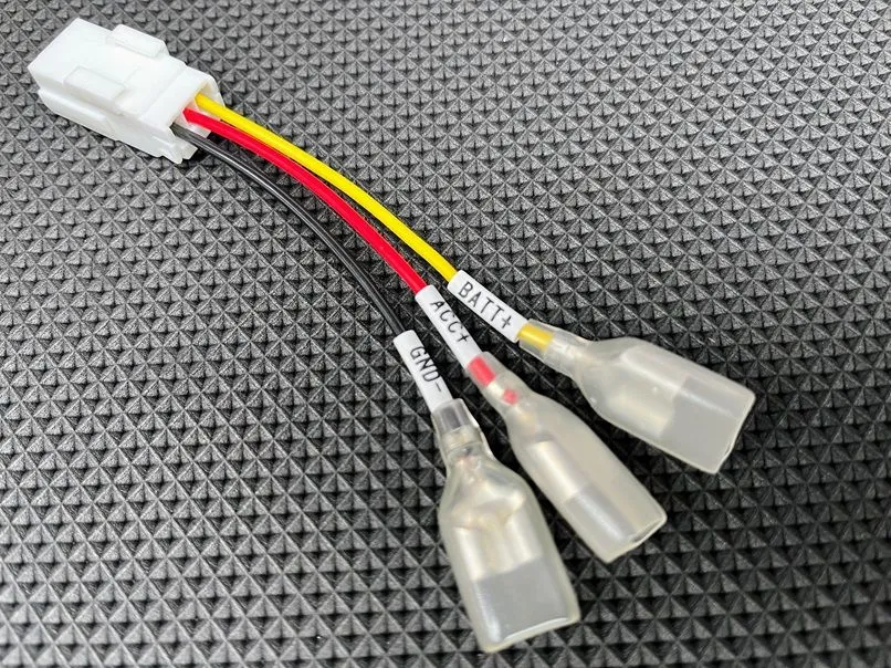

Does anyone know the model number of this connector?

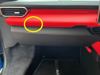

As already discovered, I believe the location of this connector exists at the back left of the glove box.
This is for right-hand drive cars.

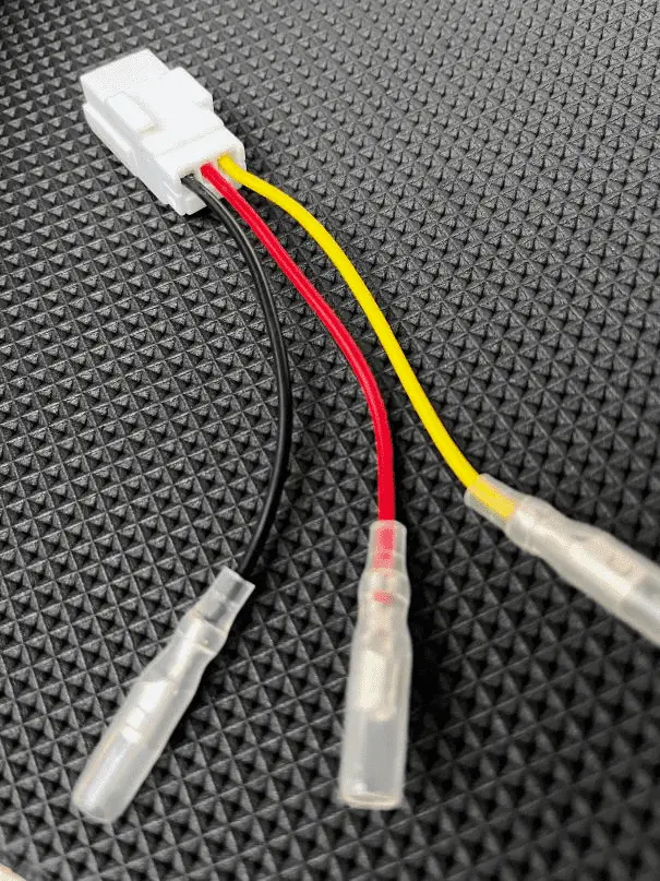

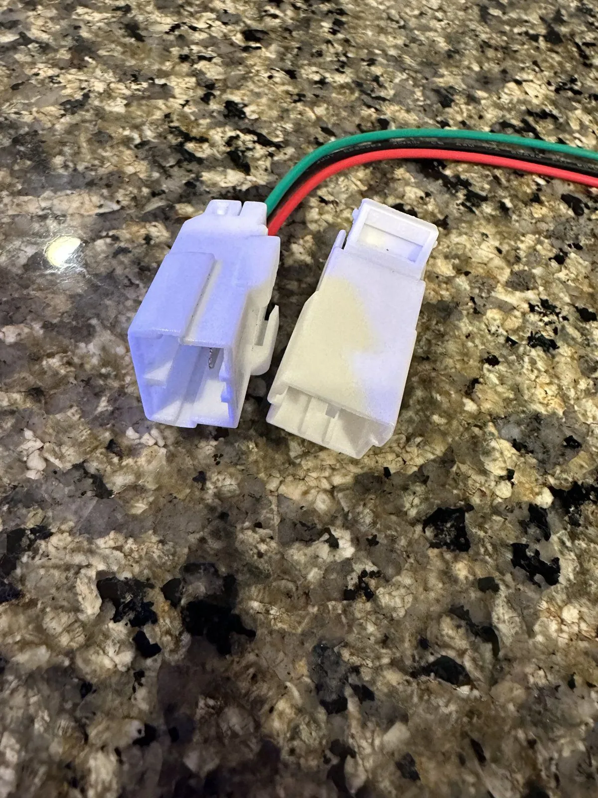

I ordered the parts off of Digikey.. I'll be the guinea pig. Dont forget to order the pins too (at bottom it lists them for different AWG wire). I bought both versions of the pins as the blades looked to be different widths.
Sounds good, I just ordered from AliExpress. I plan to use this for my radar system.
I ordered from AliExpress as well. Works as expected, used it to power a high wattage USB power source for a wireless charger.
I assume the red battery wire is always powered so it can be used for dash cam parking mode? This would eliminate the need for fuse tapping and be a much cleaner install if so! It's a shame the rearview mirror USB isn't powered when the car is off, missed opportunity there.

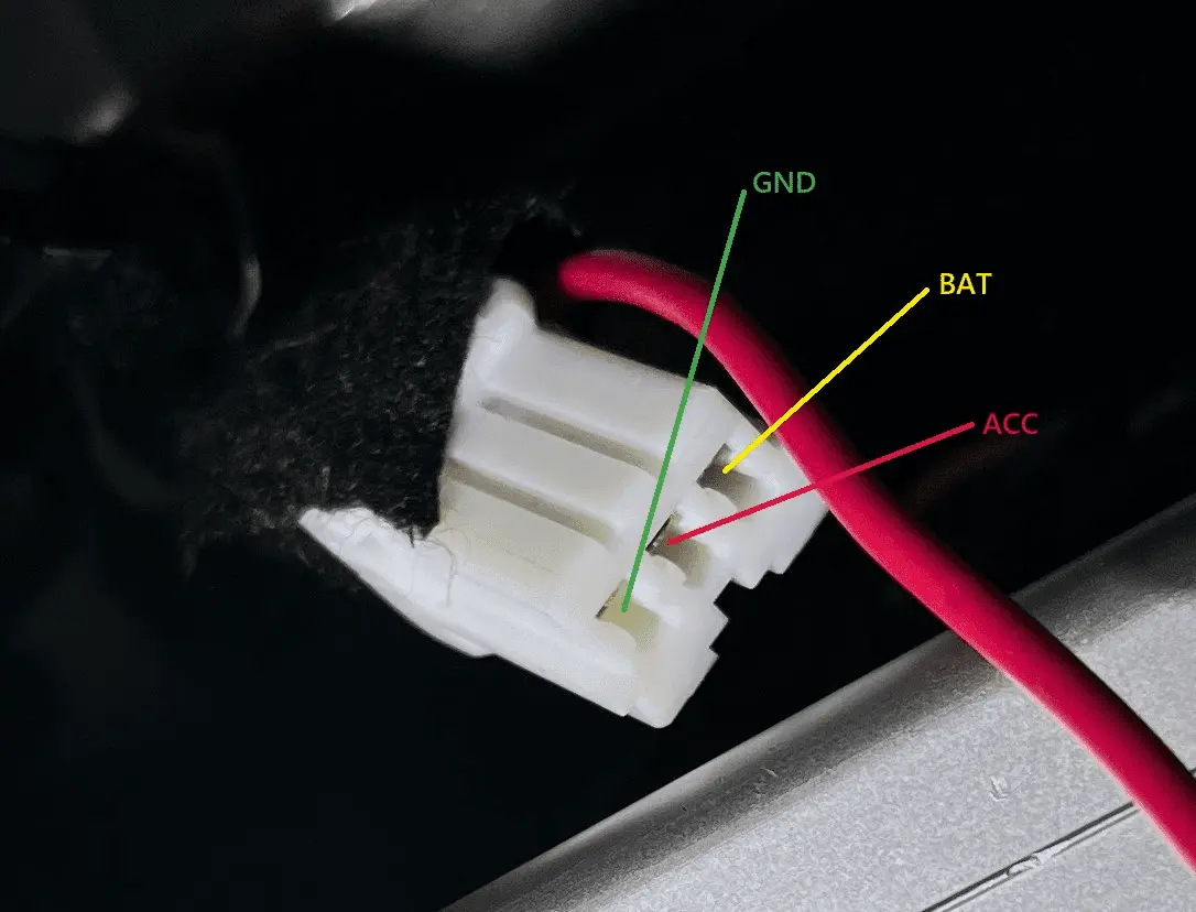

We have received the product and would like to report the results.
The connector model number 174928-2 matched.
The product website seemed to offer a choice of pre-assembled ones, but due to the actual role and color difference, I purchased the unassembled ones and assembled them.
The 3-pin connector seemed to be one for the battery, one for accessory power, and one for ground (GND).
It is smarter than taking it from the fuse box and I am personally happy with it.
Thank you Porter for telling me about the connectors!

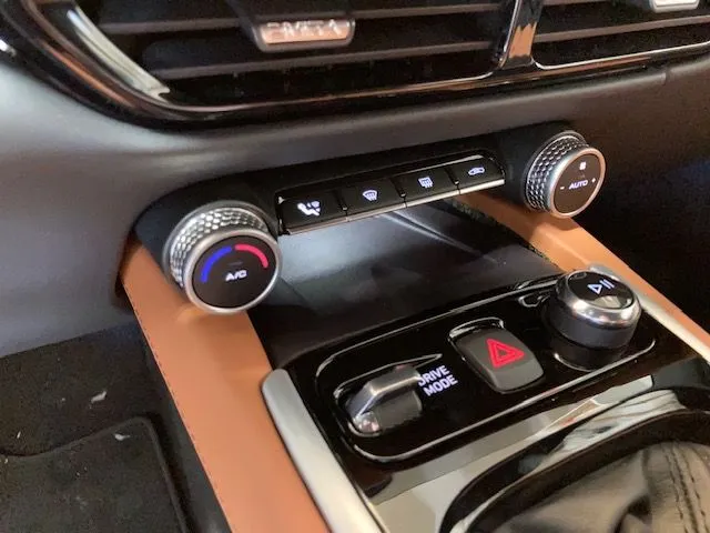

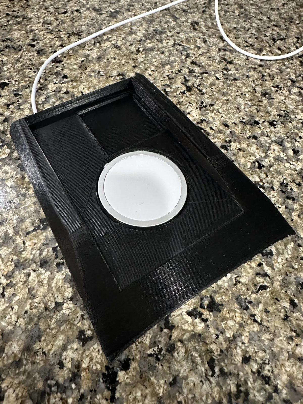

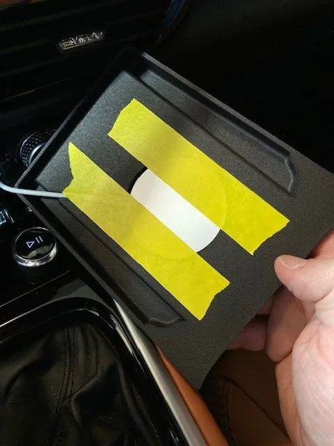

I just installed my wireless charger. Works great!!! I'm backing away from making them here as I didnt see @silent cilantro had the same idea, and he has seniority here. :) I'm still going to share some pics.
For power, I just used a usb-c to usb-a adapter and the plug below.
[edit, stay tuned.. it didn't appear to charge from the plug below. I will try the tap behind the glove box now - its likely a current issue because when I put my phone down it does ding and show its charging (lightning bolt over the battery icon), but the level didn't change after 25 minutes..] I'm hoping that its not a range issue from the phone to mag safe charger! I have a 2mm offset on the model, and a phone case that's 2mm, so perhaps 4mm is too far. Stay tuned, I'll report back. Its likely a current issue - I used a usbA-C adapter for the charger, and the usbA current spec is less than a usbC as intended. Thats got to be it..]

For those of you who are interested but don’t have a 3-D printer, the prices have come down substantially. You can get a decent one for only 200 bucks. I absolutely love mine. Creality Ender. I use it for all sorts of mini projects around the house. I’d be happy to advise on a model/software recommendation if interested.
I'd be interested in a recommendation.

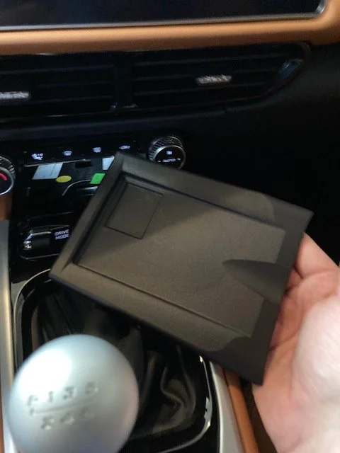

Fully supportive of @silent cilantro effort to sell these (pls see his thread), but I’d already started on my own implementation for myself. Not planning on selling these…

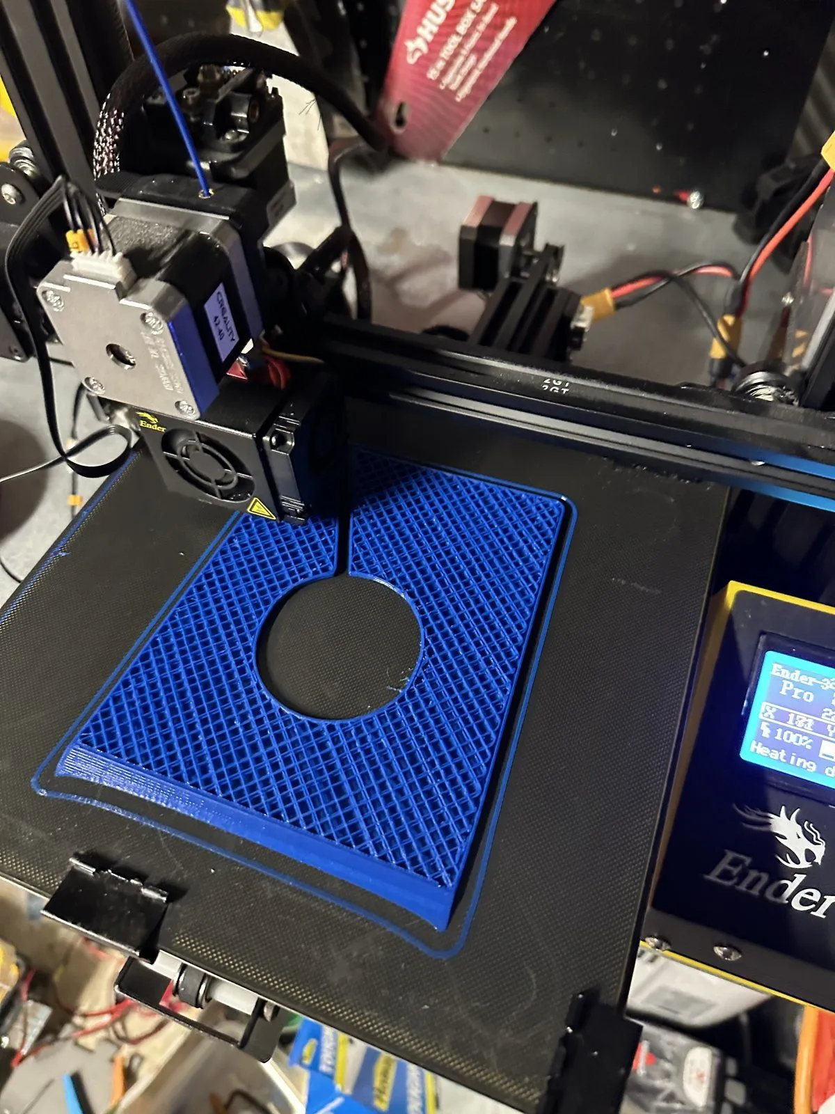

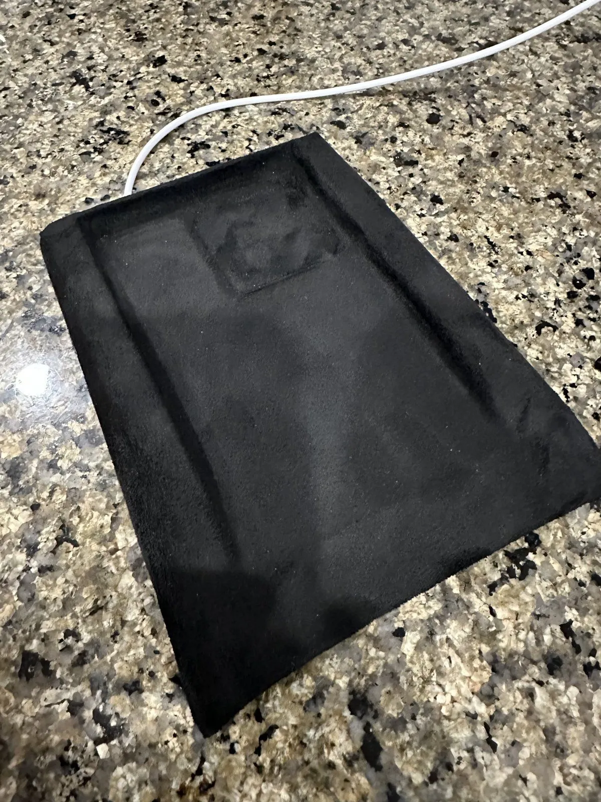

My submission. But I don’t have a car to test it on. I’ve not used my 3-D printer in a while, but projects like this remind me how fun it is, and it’s something I do with my kids.
The original design was from another forum member on thingiverse, so thanks to them, I just edited for my phone/wife.
Which material did you use? Looks like you didn't have to cut it to form into the corners..
