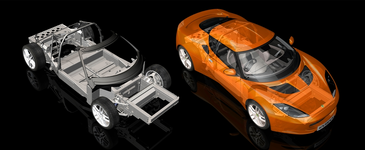

False. The roof is simply a layer of GRP (fiberglass) that goes over the roll bar and connects to the windshield header. You can remove the front and rear clams, the doors, and the rest of the body and the chassis will be as stiff as with the body. I attached a couple of photos to illustrate.

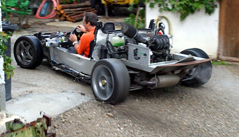

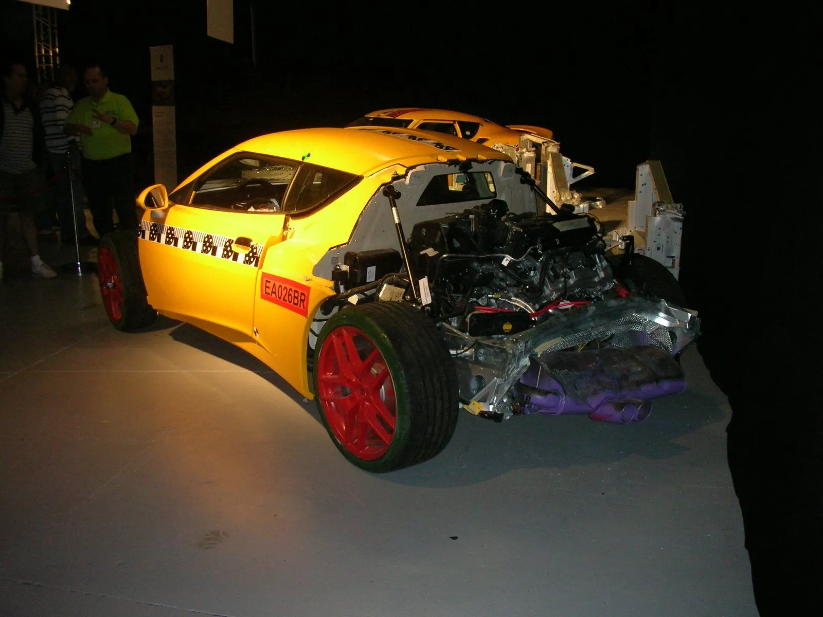

And to further illustrate this, here's a picture of an Elise (same chassis technology) with it's body removed. Also just as stiff as with its body panels and clams.

First, the order of release doesn't matter. The Elise/Exige/Evora/Emira all use a bonded, extruded aluminum tub-style chassis. The 111 chassis (Elise/Exige) is obviously smaller than the 131 chassis (Evora) but very similiar nonetheless. The Evora chassis is almost identical to the Emira chassis.
Second, the red portion you see in this photo is part of the fiberglass body being bonded to the chassis, not part of the chassis itself. The bare chassis does not have a roof (see the Evora chassis example).

Again, please reference the Evora chassis picture I posted above, the picture with the orange body next to the bare chassis. There on the left is the bare chassis with the windshield header and roll bar attached. The Elise/Exige/Evora/Emira all have a multi-point roll bar attached to the chassis, below the fiberglass body. Those black beams you see are the rearward roll bar supports.

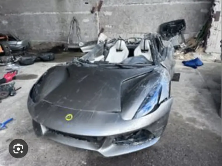

I think. Generously. Especially considering how much higher up the glass starts in the Emira, without completely redesigning the rear hatch and trunk lid. This is what you (in theory) could get away with. Seems incredibly far from worth it, and I would never imply to anyone that it's something 'totally reasonable' But, hey, if you want to encourage other people go for it.
