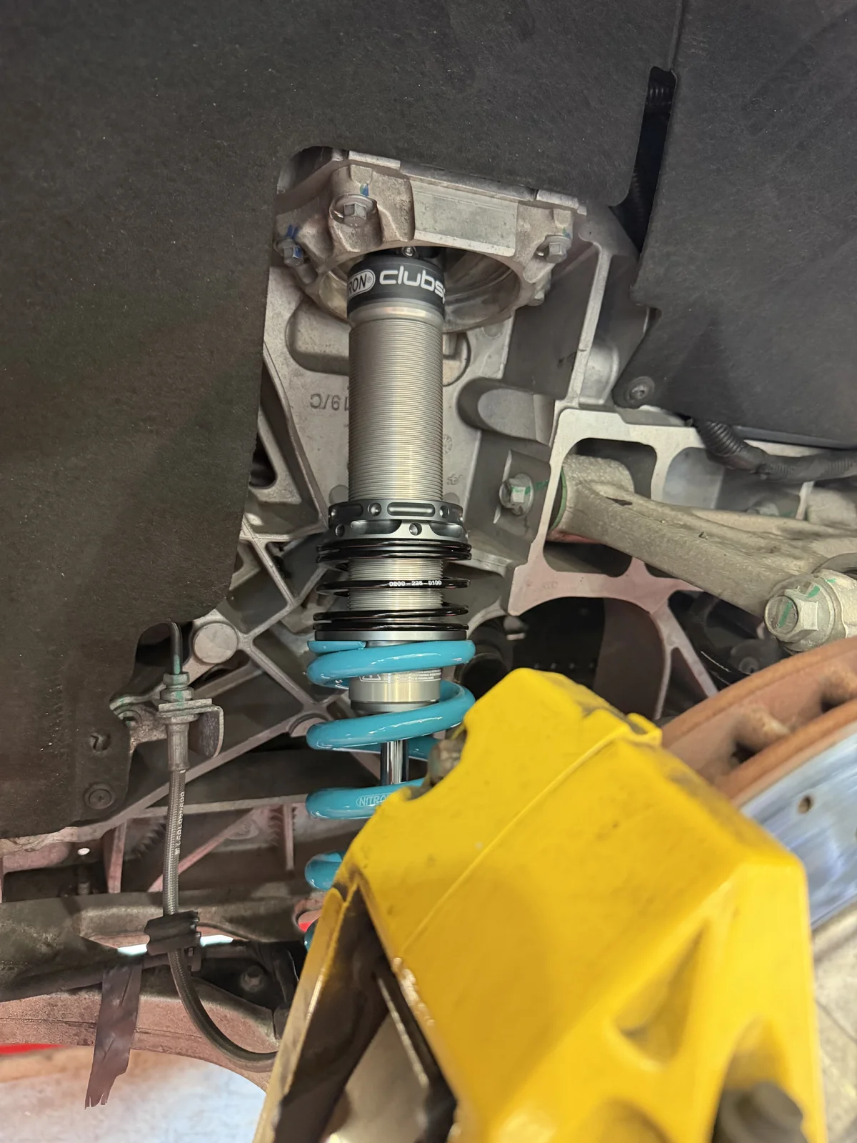

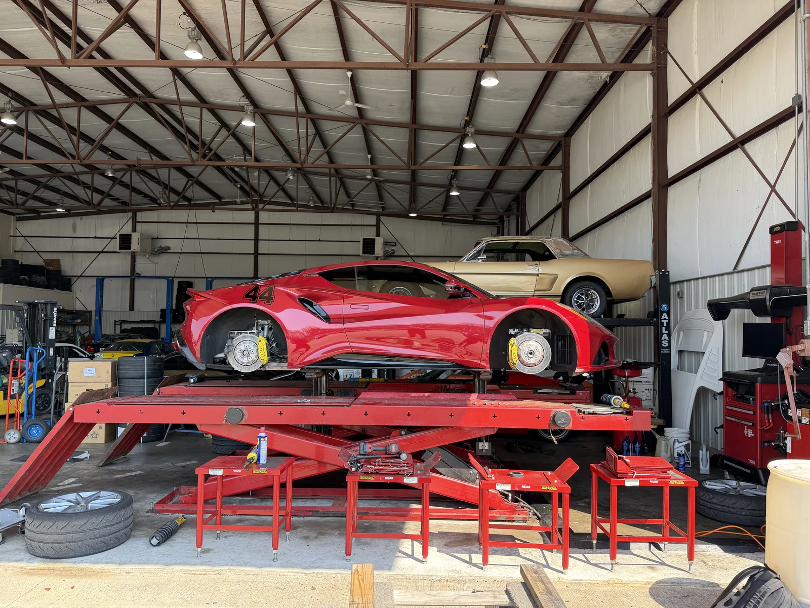

Got Nitron R1 coilovers (from GRP) installed today, ride height lowered about 12 mm. First impression was it did not negatively affect ride quality, will be on track in 2 weeks for a first shake out. FYI they are 4lbs lighter than the OEM per corner
Reactions: GRP
View attachment 79004View attachment 79005
What spring rates did yours come with?
Interesting. Rear chassis seems totally different compared to v6
The differences between the Toyota V6 and the Mercedes i4 meant different engine mounting requirements for each variant. as a result the i4 has an aluminium subframe at the rear compared to the steel one that is used on the v6.

I had these on my old Evora and they started out good, but then there was a horrible knocking sound which was attributed to them needing to be re-valved. Hopefully they have since rectified the issue.
Very little difference in actual weight between the two so I wouldn't expected much difference in spring rates.
Just Google it and the specs will come up linked to posts here.
The spring rates are in fact quite different between the i4 (stiffer) and v6 (softer). Also there’s a major difference between the touring and sports versions. Lastly, to make things even more complicated, some early versions of the v6 even had different spring rates amongst v6 touring variants built later.
Btw, all of this is on this forum.
