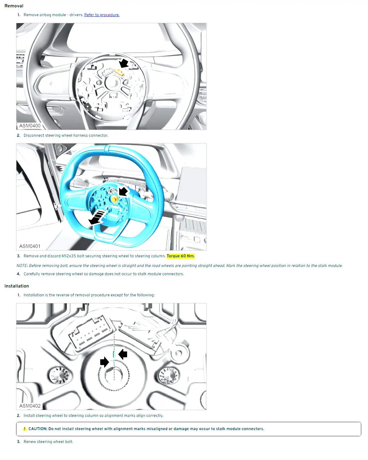

Sounds like your steering wheel has been off and put back on again probably when the road wheels were not straight.
Just have the dealer fix it - they will just need to take it off and put it back on again - this time with the wheels straight. 10 minutes work.
You could do it yourself put it takes some proper tools, a puller and a torque wrench - also having an assistant to hold the wheel whilst you torque it helps.

You don’t align your steering wheel through the steering wheel spline interface, you do so with an alignment — specifically the front toe. You also don’t need a dealership to do this, any performance car alignment should be competent enough to do this.

Pretty sure if you try it this way you will mess up the stability system. Best adjusting at the steering rack which is pretty straightforward. If you adjust each side the same amount in the same direction you won't change the alignment, only the angle the steering wheel is at when the front wheels are pointing straight ahead. ...s if your wheel is pointing to the right when driving straight your need to adjust your wheels to point more right. Try 1/8th of a turn anticlockwise on the front right and 1/8th of a turn clockwise front left.
