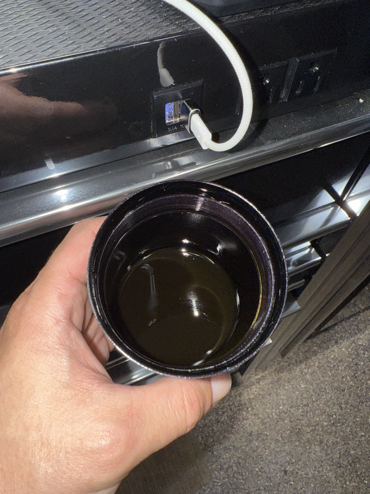

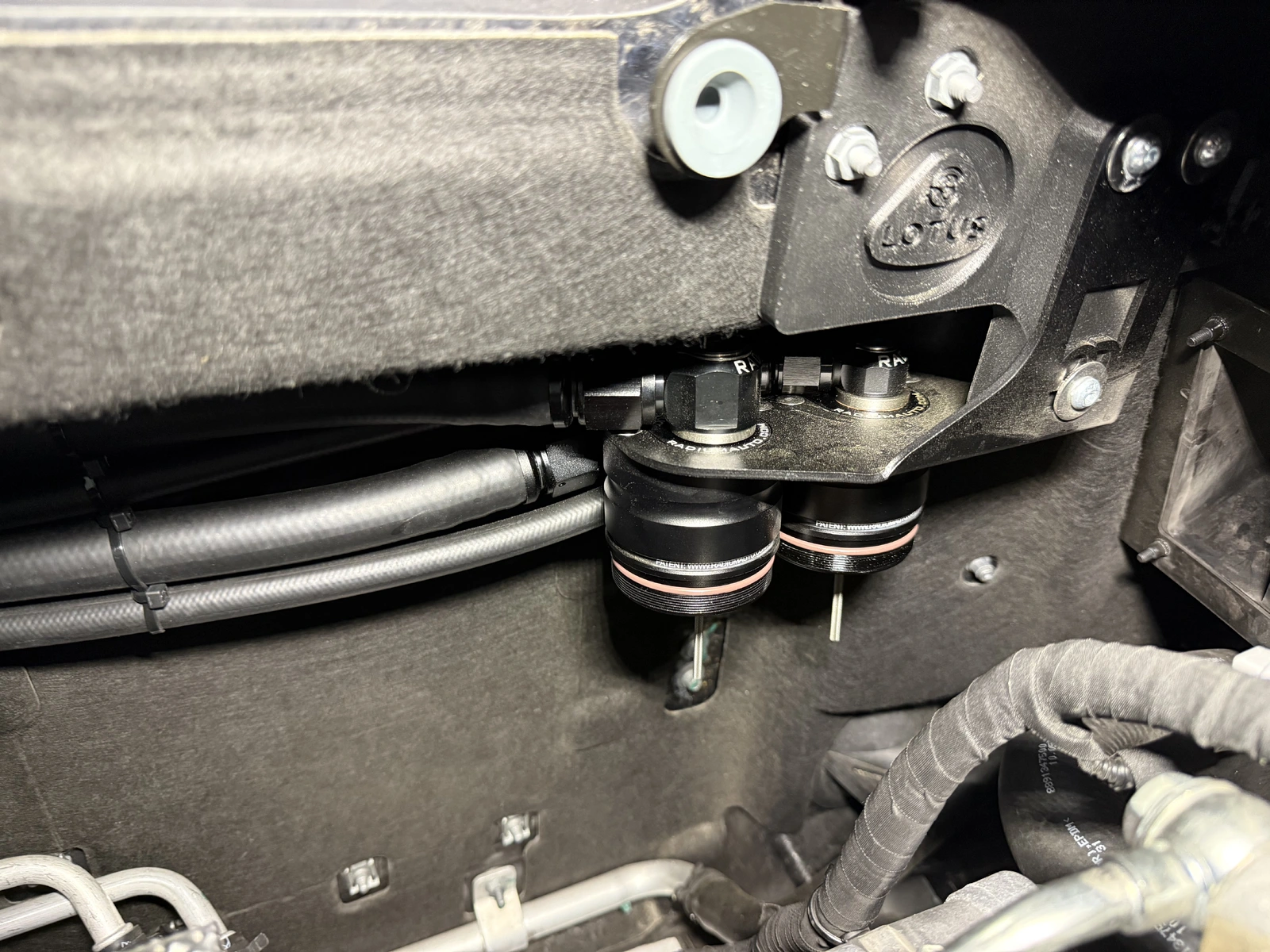

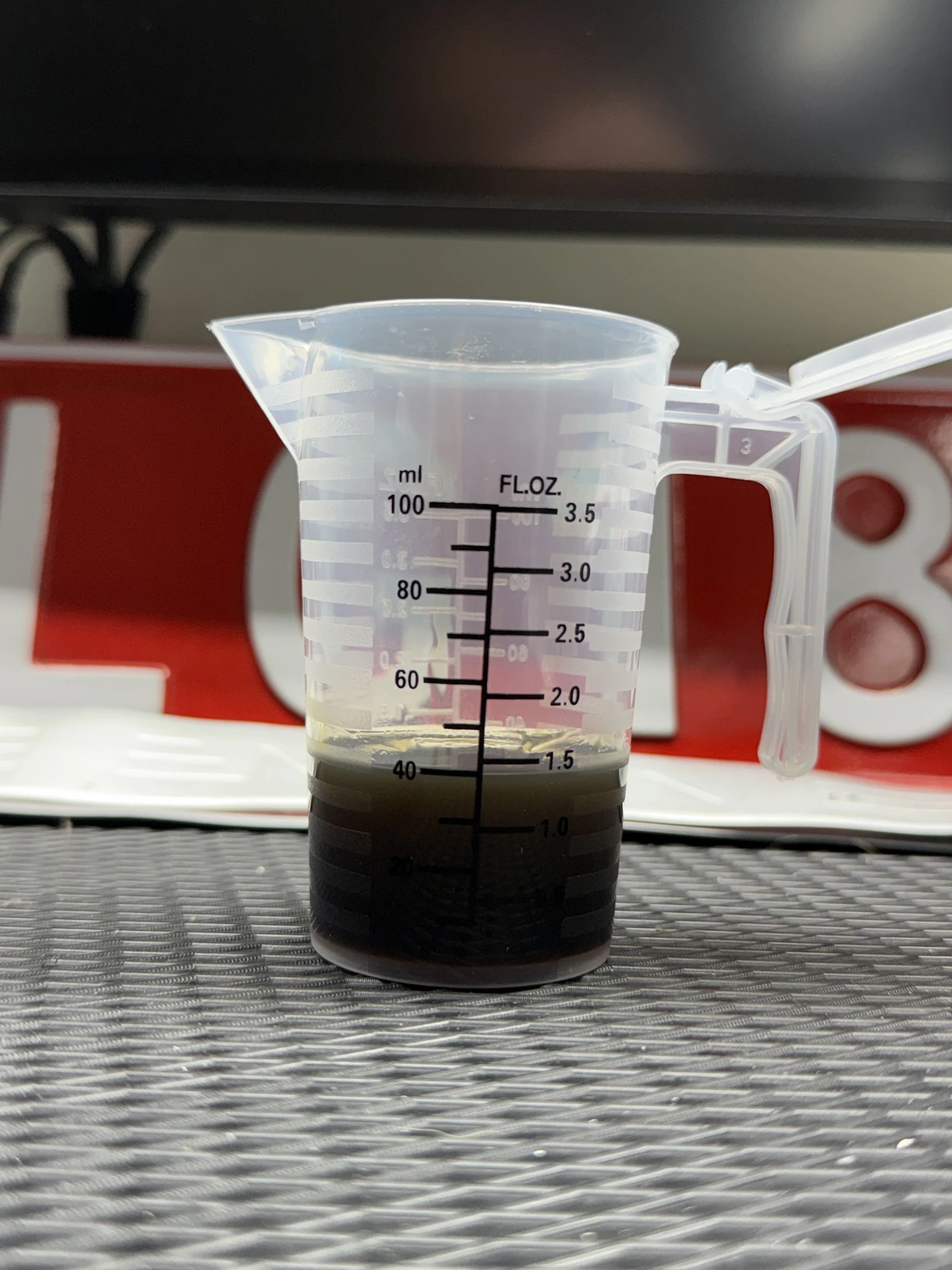

1200 mile update. Catch can on rear PCV has 40ml of oil in it. The other one is empty.
It seems the front port is just a breather without a PCV valve. It lets fresh air into the crankcase when the throttle body is closed. Even though there may be a bit of reverse flow out of that port under WOT when the PCV valve is closed and crankcase pressure is high, it doesn’t seem to be enough to collect much oil if any.
I think we can probably get away with installing a can on the rear PCV circuit only.

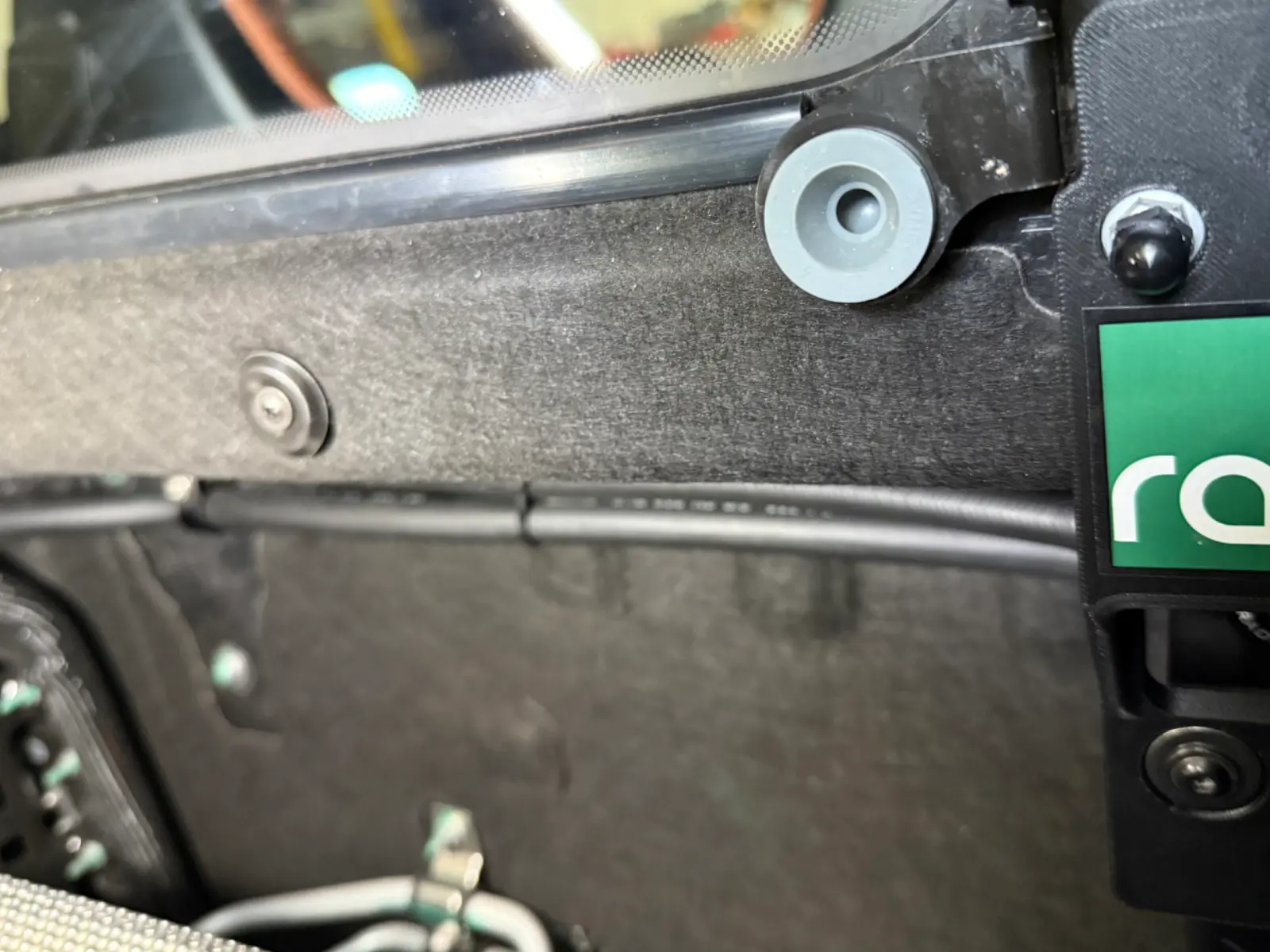

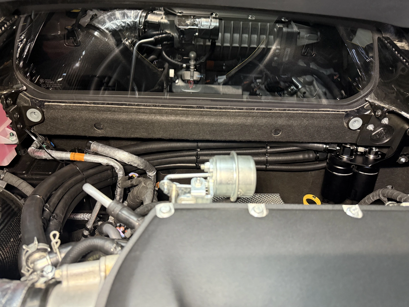

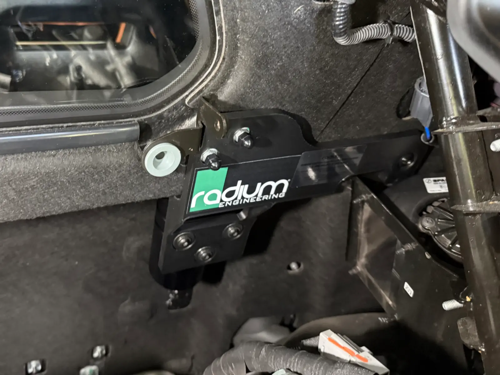

Installed my Radium Catch Can today. Many thanks to @silent cilantro for his help in designing the adapter and guiding me through the process with all the parts needed. Based on the results of his last post, I decided to install a single Radium can which I connected to the rear PCV. This is where most oil contaminants circulate and will subsequently now be caught by the catch can filtering. Using the adapter, the installation was a quick and easy DIY plus the hoses are kept discretely tucked into and against the indented ledge of the engine firewall. Below are pictures of the Catch Can model and my installation with the adapter.

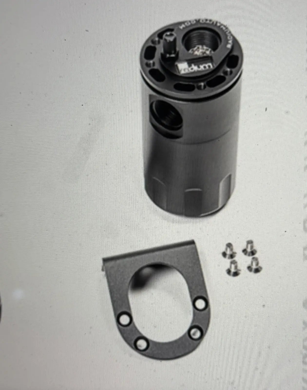

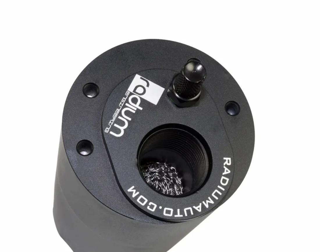

Have you guys been satisfied with radium engineering's design? Im leaning towards buying a moroso catch can simply because I cant find anywhere that radium says that their catch can actually has a filter or anything inside it, the one photo of the seperator part of it on their website seems to just show a few baffles; while the moroso has filter media and baffles.
Seems like the moroso kit for the old 4.6L mustang GT could be mounted to the left side rear of the supercharger using a bolt that im guessing locates the intercooler, would just need to get some more hoses.
radium cans have filter media at the inlet/outlets
They also have baffles built into the top section of the can
