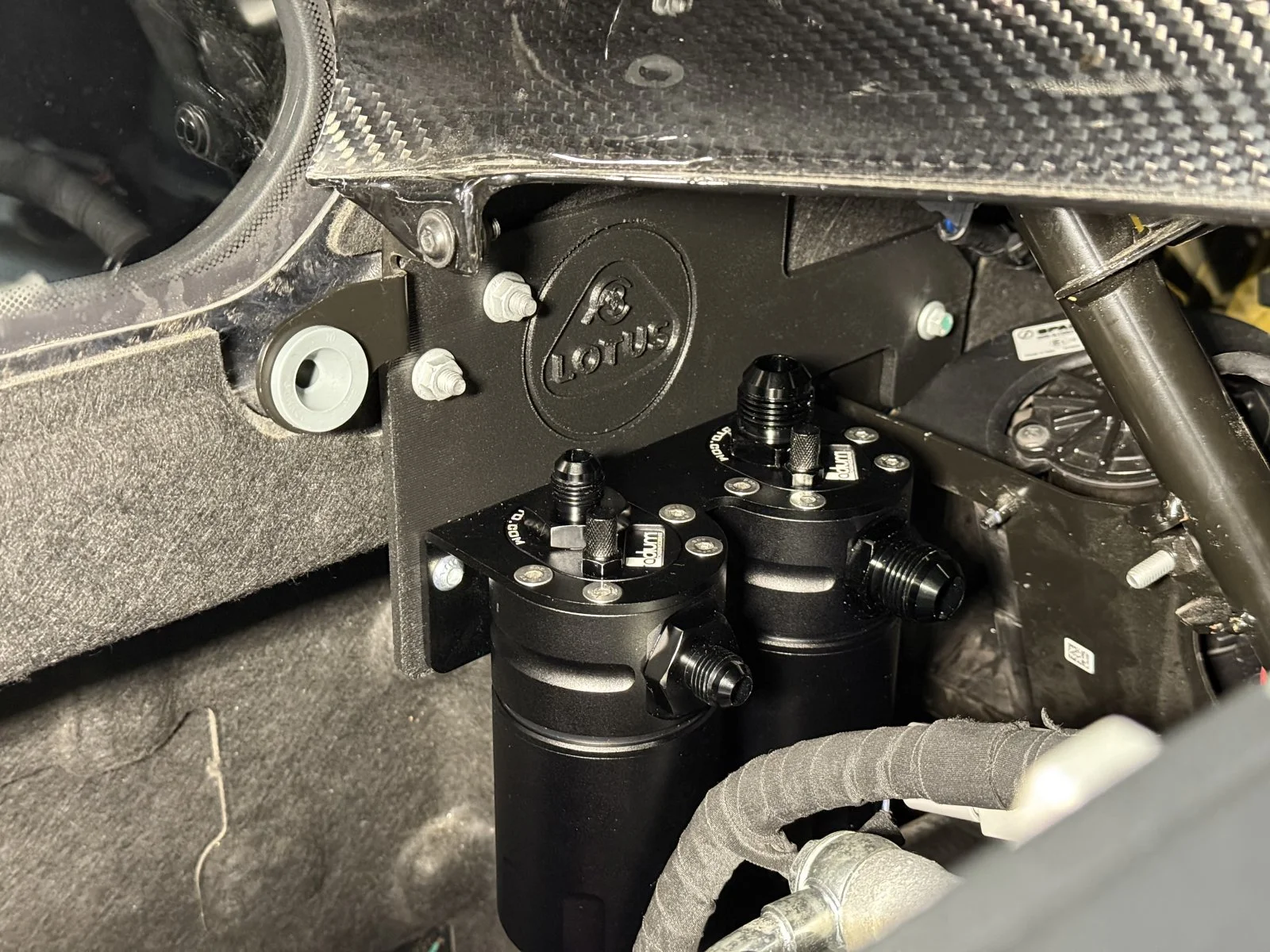

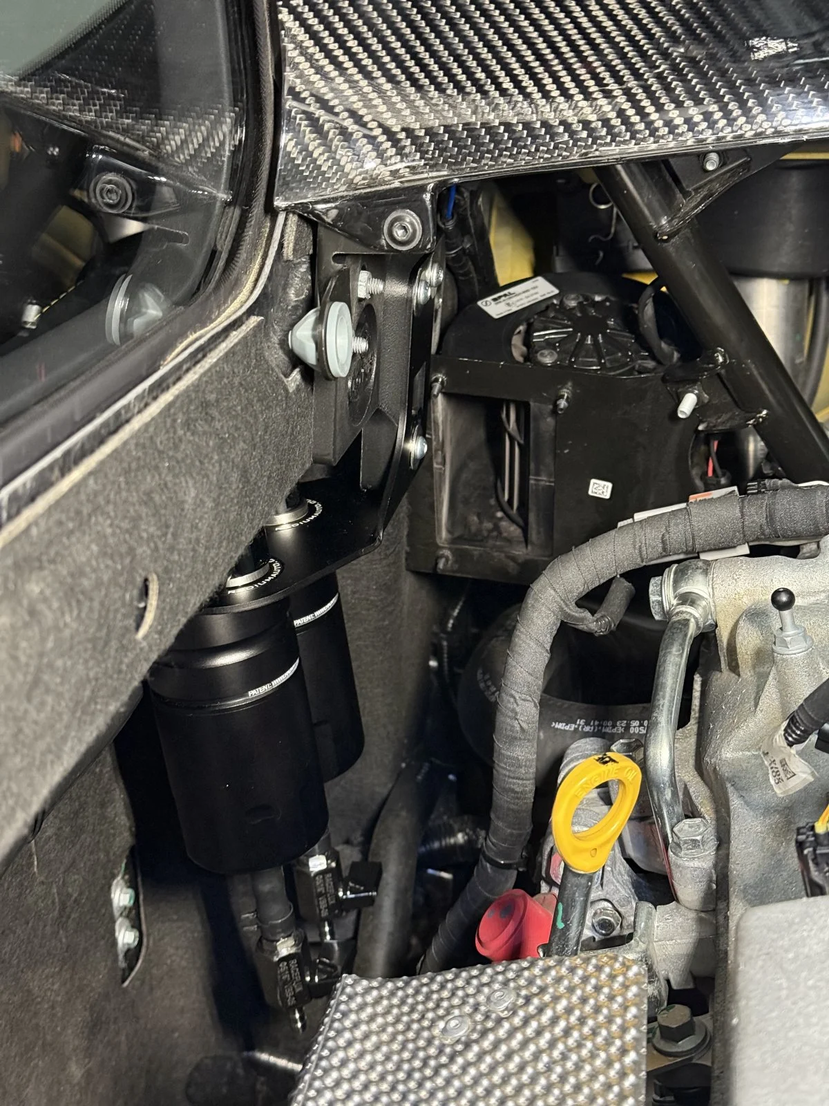

@cyanmauve I ordered the Evora kit from @GRP (thanks Greg!) But if you are planning on replicating this you are better off piecing it together as I didn't end up using any of the fittings the kit came with.

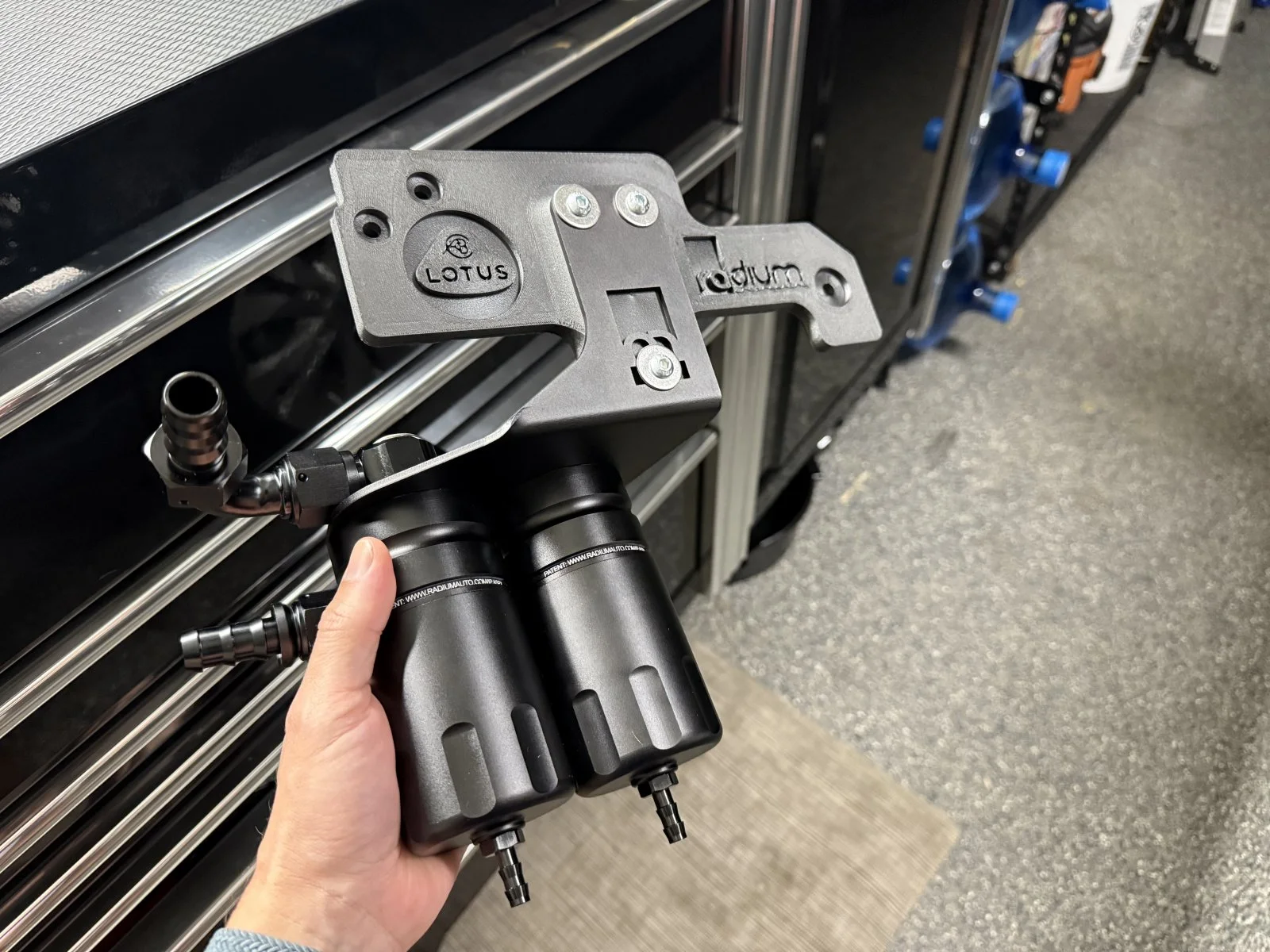

I initially made an adapter to fit the universal bracket Radium offers, but it placed the cans right in front of the outlet of the engine bay cooling fan. It's prob ok but I didn't want to block that airflow.
So I ended up making an adapter for the Evora bracket to place the cans closer to the firewall under the little ledge below the window. The cans do end up facing the front of the car and the dipsticks are unusable as they are unreachable as there isn't clearance to pull them up and out. This didn't matter to me as I'll be draining the cans every oil change.
Adapter bracket, it mounts using existing factory studs/bolt. Ignore the -10AN 90deg fitting, I did not end up using it.
Cans installed, outlet of the engine bay cooling fan is not blocked:

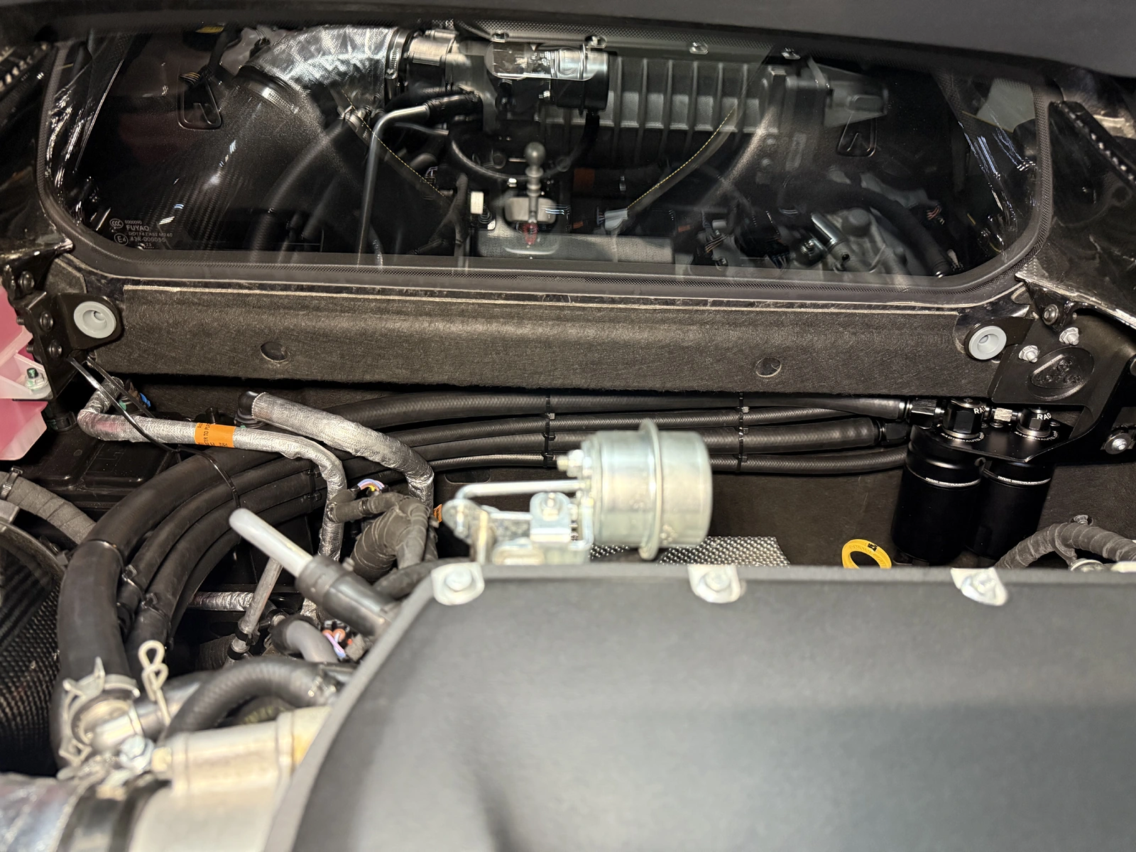

Low profile swivel banjo fittings on all ports:
Hose routing:

I initially made an adapter to fit the universal bracket Radium offers but it placed the cans right in front of the outlet of the engine bay cooling fan.
So I ended up making an adapter for the Evora bracket to place the cans closer to the firewall under the little ledge below the window. The cans do end up facing the front of the car and the dipsticks are unusable as they are unreachable and there isn't clearance to pull them up and out. This didn't matter to me as I'll be draining the cans every oil change.

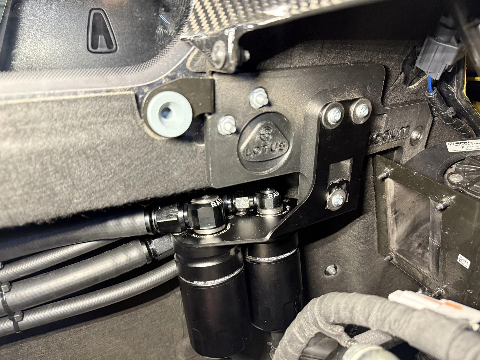

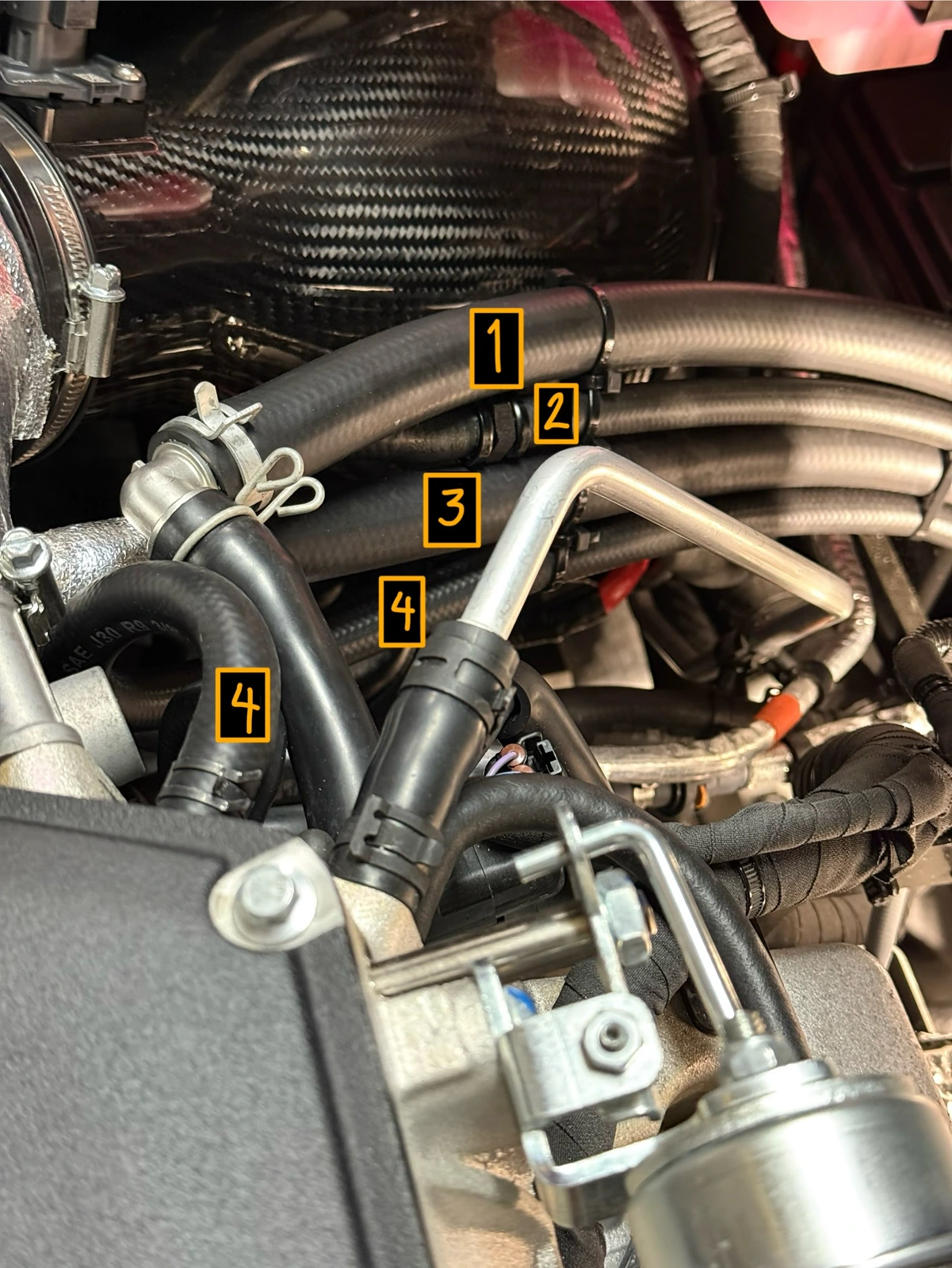

Hose routing:
1:
5/16 hose from rear PCV valve under the SC to top port of right catch can using a 5/16 to 5/16 coupler.
2:
5/8 hose from intake tube to side port of left catch can.
3:
5/16 hose from SC to side port of right catch can. The barb in the SC is 3/8, but Lotus squeezed a 5/16 hose onto it. I wasn't able to squeeze the 5/16 hose I got so I used a short piece of 3/8 hose with a 3/8 to 5/16 reducer, the OEM hose is much more pliable.
4:
5/8 hose from front PCV valve to top port of left catch can’t. I cut mine a bit too short, so it doesn’t line up with the others.
I shortened the OEM hose from the PCV valve and added a 90deg 5/8 to 5/8 elbow. I damaged this hose while removing it from the PCV valve so was forced to cut it, but it may be possible to leave it alone and use the elbow or a straight coupler in order to connect the valve to the can.
