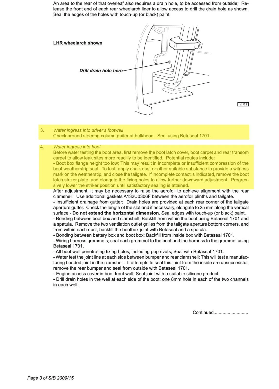

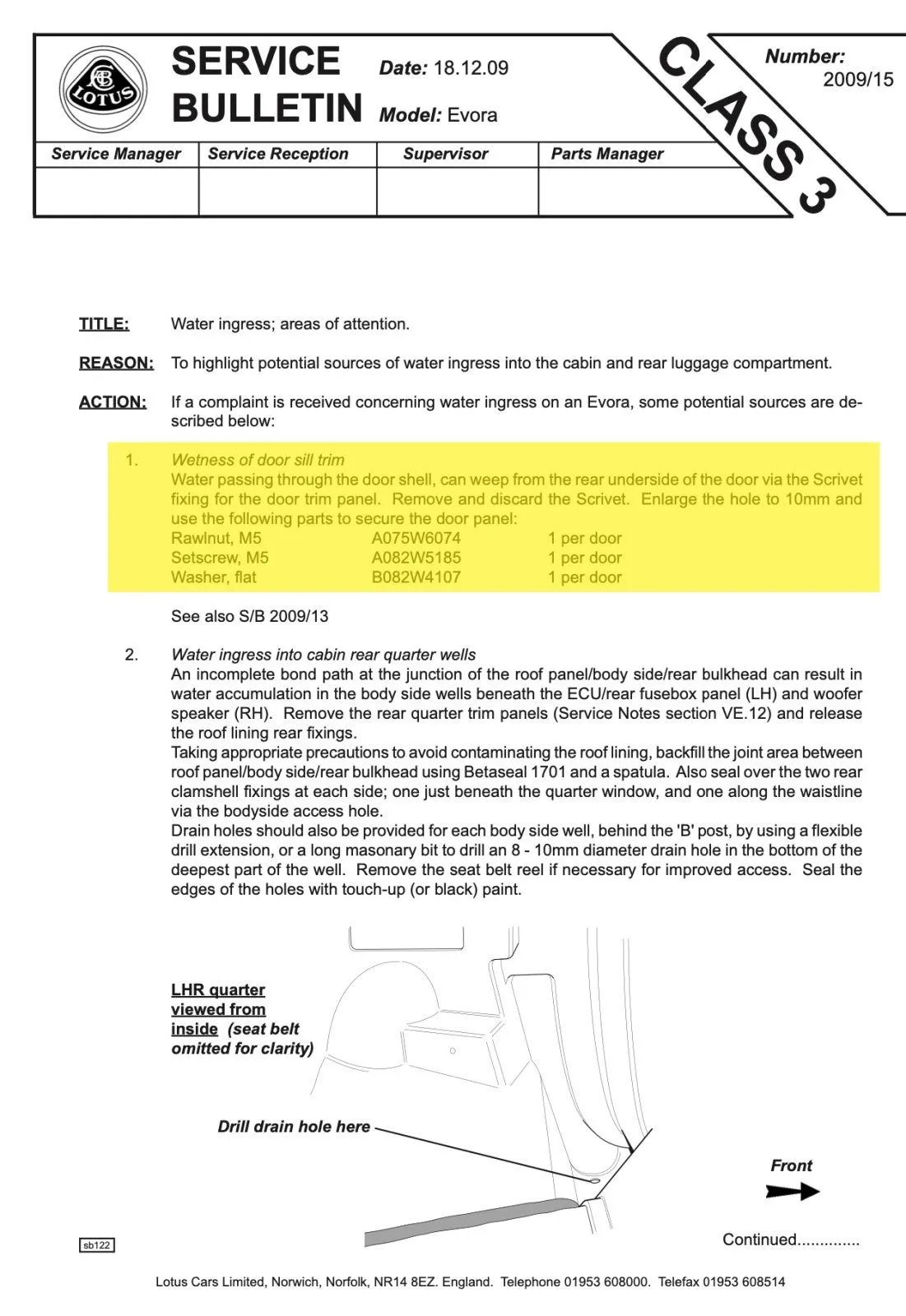

You have been very lucky my friend (no wait ,you're not my friend! :) ) hope the same happens with your new and improved Emira, check this out, and I'm quoting Lotus now, I've had 3 out of 4 on this sheet, a 14 year old problem (2009) not to mention two issues with the AC. Now I gave Lotus 2010, 2011 and maybe 2012 to fix the problem, but in 2021? that's unacceptable!! I went out of my way and paid premium to purchase Lotus Flagship car, the Evora GT....
Did you know, the only soft top car I've ever owned that didn't leak was the Elise, now, Lotus comes out with the much better and improved Evora and I have a water leak (like my friend from Cuba would say "Son for Gun!" :)
So you see Thomas, I do need a friend and a hug..... never mind that, I need some serious therapy! I'm calling Dr. Phil, you'll see me on TV with a large group of owners telling our stories, hysterically balling, making a spectacle...
I'm going to demand to my Lotus rep provides me free of charge with 2 tubes of Beta Seal 1701 just in case :)
