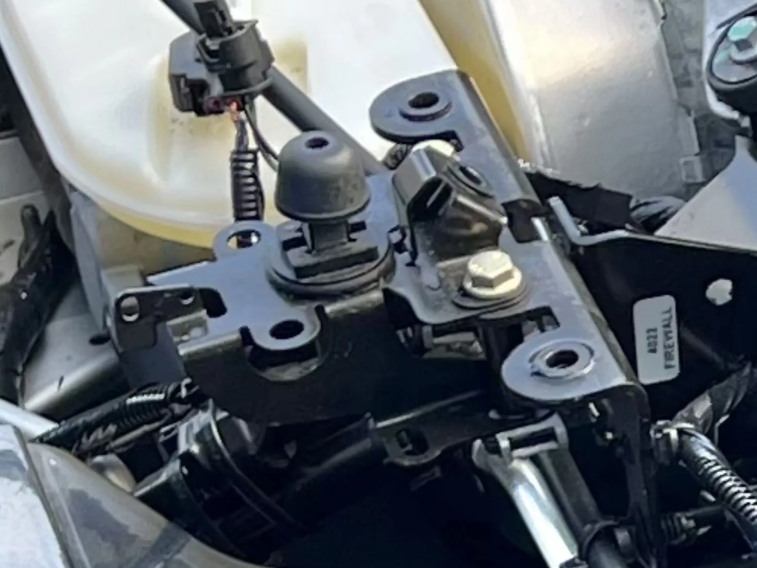

Interesting because there is no bonnet sensor. Not on mine anyway.
You can see the bracket where one might go, but there’s nothing there.
It looks like it might have been an option, or a change of plan, as there are also 3 rubber locators that serve no purpose as the bonnet is bolted in place.
Maybe your warnings are a software thing that hasn’t been deactivated?
There’s nothing in the service notes about any bonnet sensor.

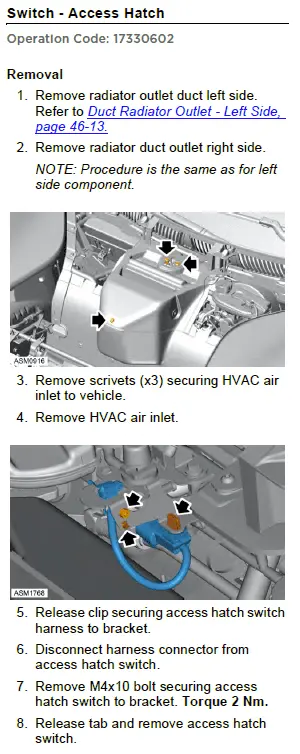

If anyone has the service manual can you check where the sensor is? (presumably there is one if there's a warning!)
KJD
Jan 10, 2022
417
1,099
London/Surrey, UK
I stand corrected. Didn’t see that in the service notes.
But, as you can plainly see from my photo, there isn’t one fitted to my car. 🤷‍♂️

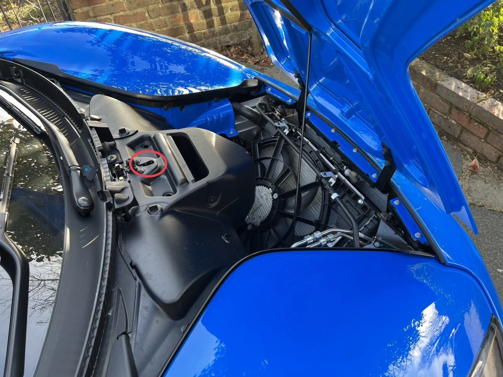

KJD
Jan 10, 2022
417
1,099
London/Surrey, UK
Here’s a closer pic of mine.
As you can see, no sensor switch.
