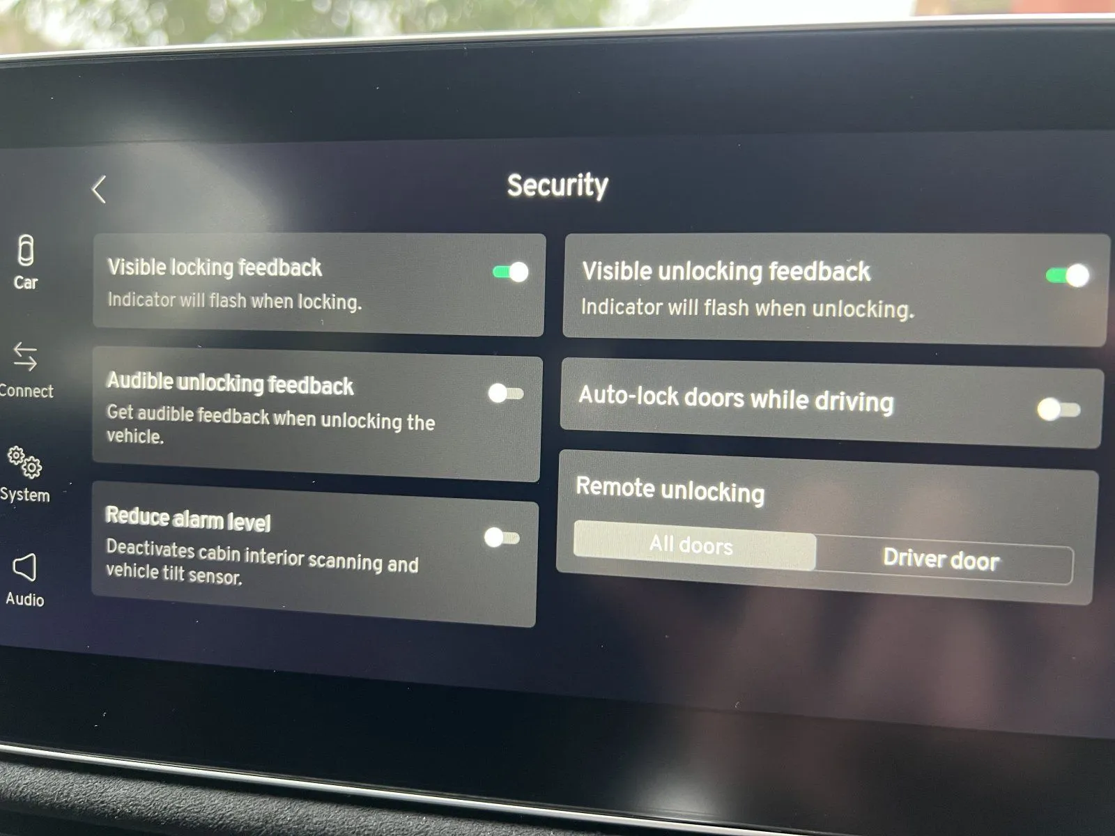

Hi,
Anyone know what this beep beep sound is?
It does this when I lock the door

Is it not just the Audible feedback for locking has been set?

It never did that in the last. Just suddenly started doing it.
Thanks, I'll try change the setting

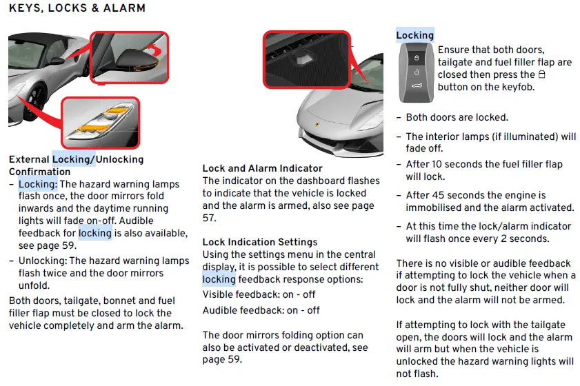

Odd one this.
I’d like mine to bleep on locking but it’s not an option in my menu, despite what the manual says.
Unlocking yes, but not locking.

Odd one this.
Exactly! But it's just a UX problem. If I turn off the audible unlocking feedback, it turns it off for locking too.

On further investigation, mine is even more odd.
If I select audible unlocking, it bleeps when locking, but not when unlocking.
Which is actually what I want. Eg: It won’t bleep if I try to lock with the boot not properly closed.
Thanks for making me take another look. 👍
