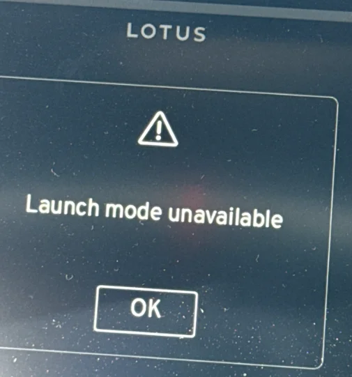

Un-F-in Unbelievable! The Milltek valve controller worked after the dealer installed the new valve controller. They used an O2 sensor from another car that was working because my delivery never came today and the check engine light came on again. They said when you remove and reuse one it may not always work. So I have to take it back next week and get the new O2 sensor installed. If it happens again I'm going to remove Milltek's Version 2 and see if codes stop coming back. I never had an issues until I installed the Milltek vlave controller. I hope I'm wrong because this sucks...And launch control doesn't work either. I'm still going to track at Lime Rock Monday and hope it doesn't go into limp mode again. What are the concerns if I run with a the O2 sensor that is not working properly because I don't want to cause any further issues?

Just praying that I won't go into limp mode on the track again on Monday. Can anyone tell me why launch control is not working?
Perhaps an I4 issue?, I didn't realize we were talking different engines - I have the V6 (man), like most early buyers.
