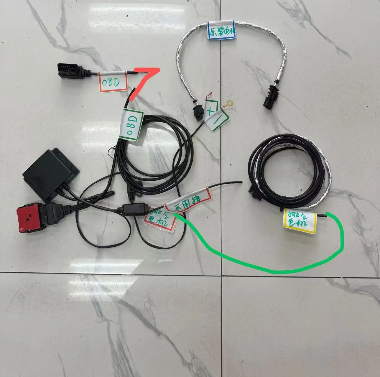

Version 1 will burn harness wire at the valve moror unless you heat wrap it, which was not in the installation instructions.
So Wrap it because you will eventually have it fry and fail.

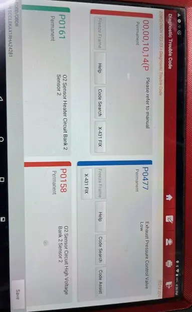

Version 2 is the way to go, but after the installation there is still a fault code and car can't rev above 4k. Then went back to stock and it is still an issue so I will take it back to dealer to see if the valve motor was or went bad. After installing Milltek originally, there was no difference in sound after clicking through buttons so I wonder if the valve motor was always bad. Anyone have a similar issue and what was the issue and result?

The Version 1 valve controller was far away. It was the wire that goes to valve motor that was fried. Milltek sent Vesrsion 2 and codes still there so I went back to stock setup and still a code and won't rev past 4k

My 02 sensor fault was in Bank 2. Please explain what happened to you and the what resolved the issue in detail so I can reference this to the dealer when I bring in my car next week, thank you

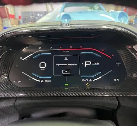

Did you get the same code and go into this limp mode as well?

My 02 sensor fault code only appeared after the Milltek valve controller was installed, as well as the 3rd cat delete.
We cleared it multiple times and it always came back. The car went into limp mode once after an autocross event, but after shutting off car and restarting, it went away. Then when I tracked the car at New Jersey motorsports park, the valve controller fault came on and both fault codes couldn't be cleared.
We checked continuity, fuse and reverted back to stock and still in the limp mode where car can't be driven above 4K RPM. After finding wire harness was burned by valve controller we installed Milltek Version 2 and still have fault codes.

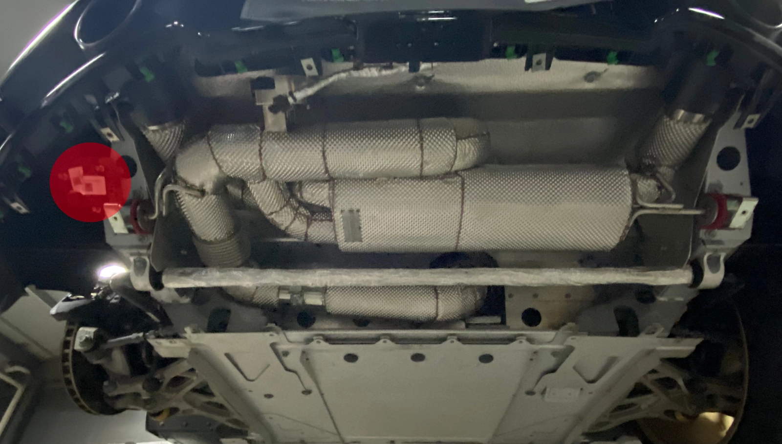

What sort of heat wrap would be suitable/recommended to protect the exhaust valve unit and milltek valve controller unit? Haven’t installed the milltek yet, but do have a Ti exhaust on an I4 and have heard of valve motors melting/failing on track.

Valve motor relocation.
