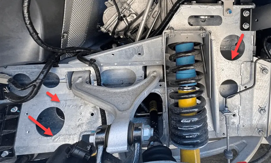

Anyone seeing rust on V6 rear subframe?
These areas (below) need to be looked at closely. That's sheet steel that's been stamped to cut out the holes, and then galvanized. There shouldn't be wrinkled surface there unless there's a weld on the opposite side that's penetrated through. Can you look inside the hole (maybe with a mirror?) to verify that the wrinkling on the surface matches the position of an expected weld?
This could be zinc solder applied to spots where the galvanizing may have been compromised due to welding. If they don't brush it flush, then it may look lumpy like this. There are signs of solder being used at the actual weld points since they look smoothed over with a caulked look.
Absolutely, I'd expect this in welded areas, or in areas on the back side of a welded junction. I just want to verify that the wrinkled finish isn't in a location that it shouldn't be.

Thank you Tom! And you nailed it exactly. I'm in a position of being skeptical of all the parties here. I'm skeptical of the supposed former employee who posted on Facebook, and I'm also quite skeptical of Lotus as a manufacturer, considering the shocking range of initial quality and QA problems they've demonstrated.
So that's why I'm asking for any current owners who have the time and inclination at some point over the next few months, to please take a look at their own rear subframes and report if they notice any worrisome corrosion or fit/finish problems.
