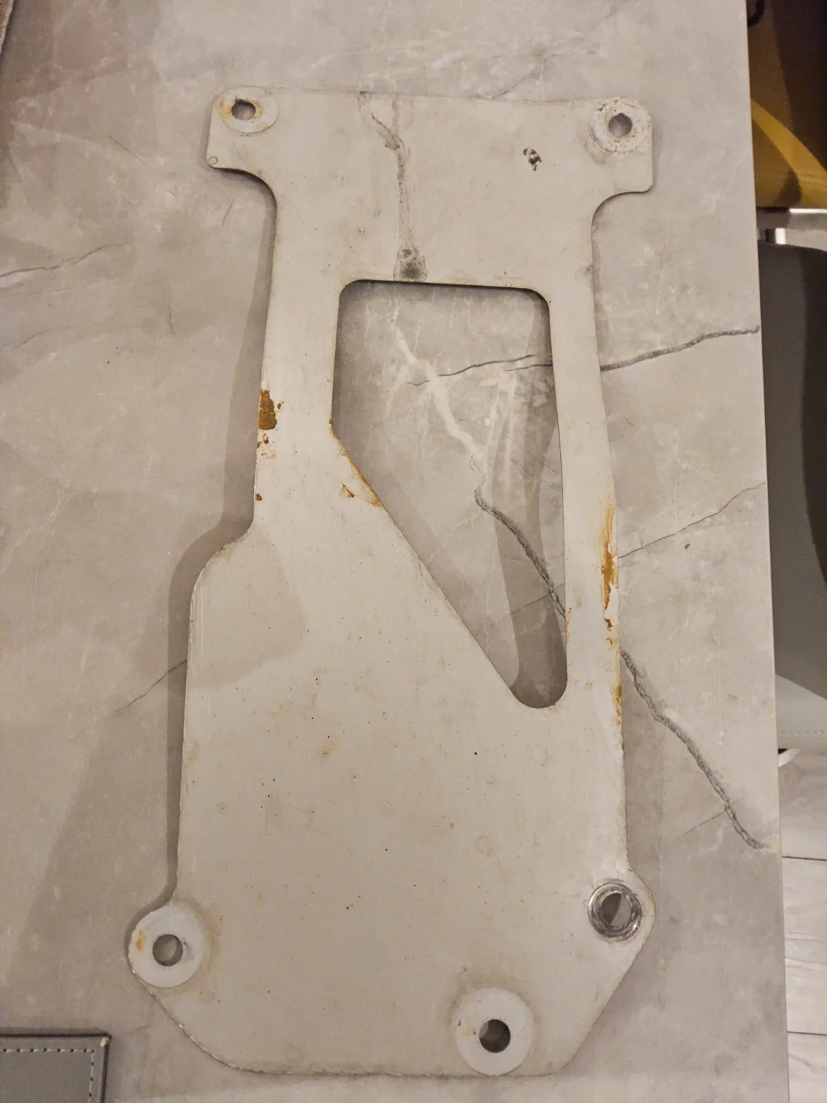

Any ideas what this is?

My Specs:
Emira V6
I noticed this was hanging down so i took it off it only had 1 bolt holding it in place any idea what it is ?

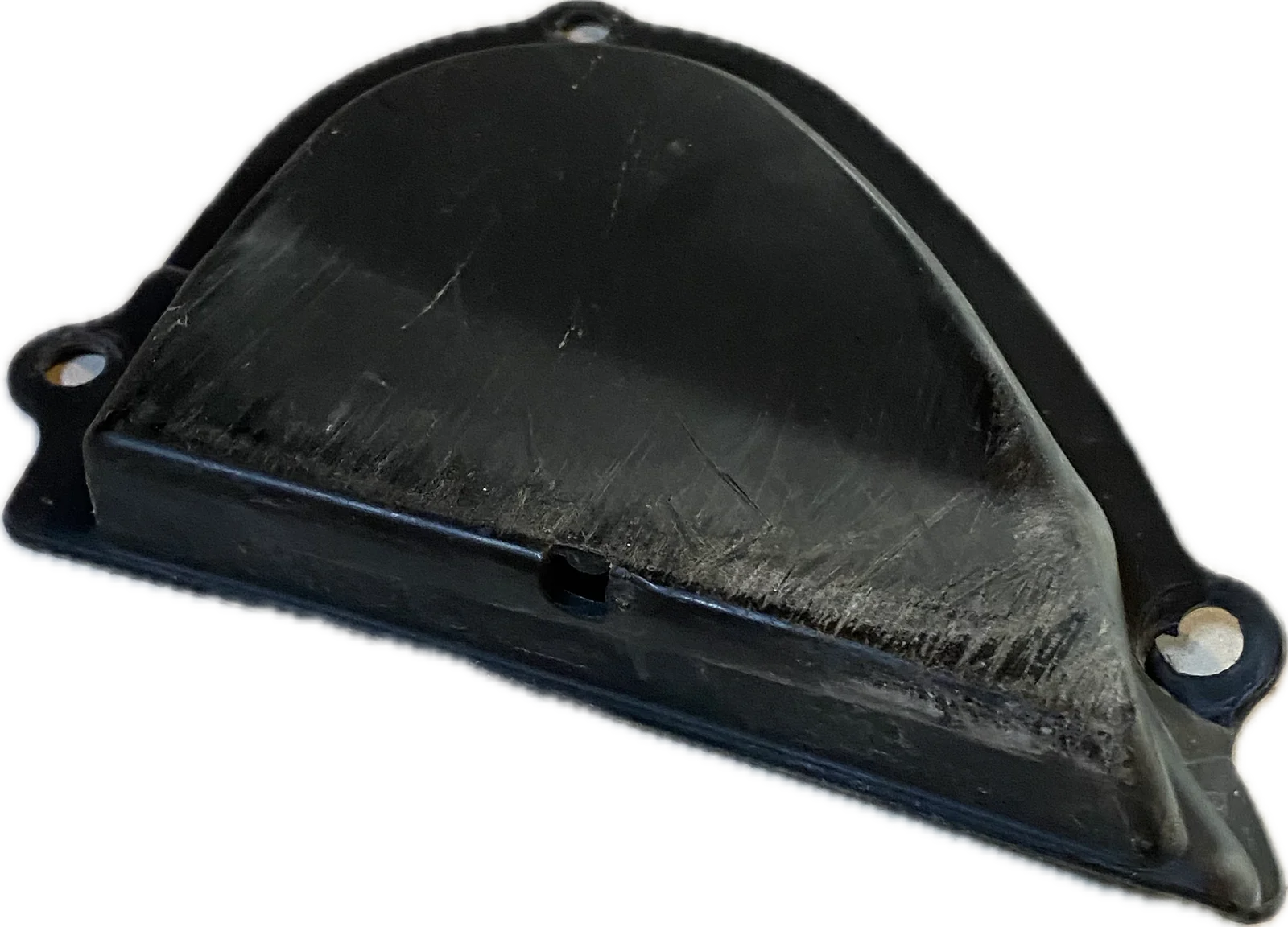

Let me guess. This thing?
It's the wind deflector in front of your tire, it's made to move air away from the tire, clean up the air flow, lower air pressure under the car and increase overall downforce. Find some new bolts and secure it.
If that’s what he’s talking about . Not sure there’s much else that could be hanging down unless he’s got much bigger problems, lol.
This piece of Aluminium

Oooh. Looks like part of the undertray. I’d be bolting that back in for aerodynamics and to keep stones, etc. out.
Hmmm. It does appear to go over top of existing sections. Maybe for added strength. I’ll defer to someone more knowledgeable on the exact function of that piece.

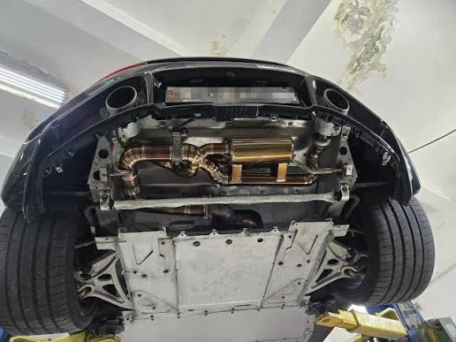

This is part of the lower shield, you remove these to adjust your rear camber and toe. Likely you either got an alignment, oil change, or exhaust installation recently where someone removed it, didn't tighten the bolts correctly and the bolt backed out.
Yep had an exhaust fitted !
