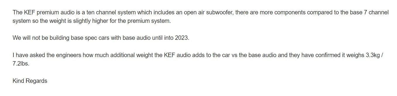

Any idea which version is lightest weight ?
Here's an interesting bit of info. It looks like the standard factory sound system has 7 speakers, and the KEF has 10, and weighs 7.2 lbs more than the base system. This is from Lotus.

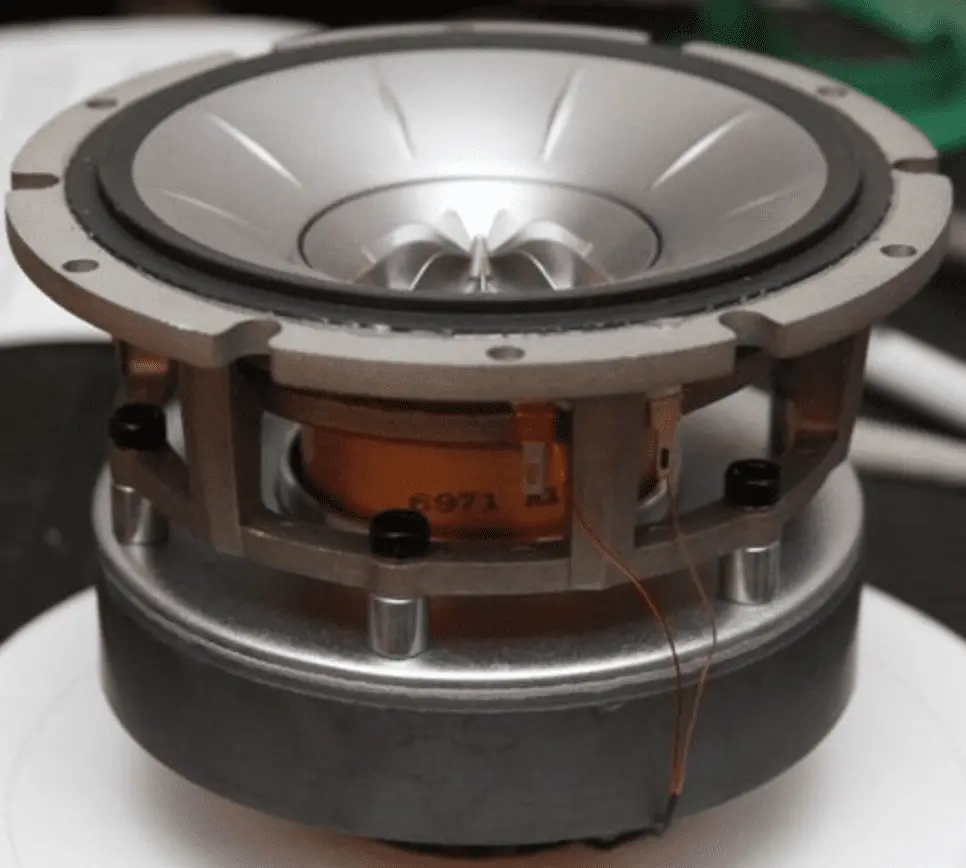

First the Uni-Qs do not have a built-in passive crossover. There are no filters fitted at all to them and a Uni-Q has one pair of connectors for tweeter and one for midrange. Of course KEF could build passive crossovers nonetheless and drive each Uni-Q with one amp channel. The Japanese document clearly states which drivers are used AND where they are built in. They say three Uni-Qs (counted as six speakers), two woofers and two subwoofer chassis for the fresh air sub. This means that there are definitely no tweeters in the a-pillars, which would be nonesense anyways because two tweeters per side is usually a very bad idea.
there are two possible ways of amping: using passive crossovers for the Uni-Qs and drive each Uni-Q with one channel plus every woofer and every subwoofer with one channel. This would lead to seven channels used in total. The other possibility is to drive every tweeter and every midrange individually as one channel and filter them active via DSP. There would be two channels left. One for the woofers used parallel and filtered with a DSP bandpass (or lowpass) filter, and one for the subwoofers parallel with a lowpass filter. Probably they will choose the first way with passive crossover filtering plus some DSP equalizing on the Uni-Qs, because the (sub-)woofers require the most power and the amp probably has the same amount of power for every channel, so one distinct channel per (sub-)woofer seems more logic, if you only have eight channels for ten drivers.
there are two possible ways of amping: using passive crossovers for the Uni-Qs and drive each Uni-Q with one channel plus every woofer and every subwoofer with one channel. This would lead to seven channels used in total. The other possibility is to drive every tweeter and every midrange individually as one channel and filter them active via DSP. There would be two channels left. One for the woofers used parallel and a DSP bandpass (or lowpass) filter, and one for the subwoofers parallel with a lowpass filter. Probably the will chose the first way with passive filtering on the Uni-Qs, because the (sub-)woofers require the most power and the amp probably has the same amount of power for every channel.
I found no information stating that a UniQ speaker unit has two sets of terminals. Do you have any data on this?
I had lots of them in my hands and figured out passive and active crossovers for them for private projects ;) Fitting crossovers to them makes no sense, because KEF is using the same Uni-Q drivers in different speakers with different baffles. The crossover has to compensate for that. Another thing is that in a LS50 for example, the Uni-Q is used as a midwoofer which requires a low pass filter. In a bigger speaker they have dedicated woofers and therefore require a bandpass filter on the Uni-Q midwoofer. It has to be flexible.
Fair enough! I couldn’t find a photo of one with two terminals showing hence my comment above!
Maybe I can find a spare one at my parents house and take a pic. I also only find pictures of Uni-Qs for ceiling mounting and they obviously have a crossover fitted to make them easy to install 😅
