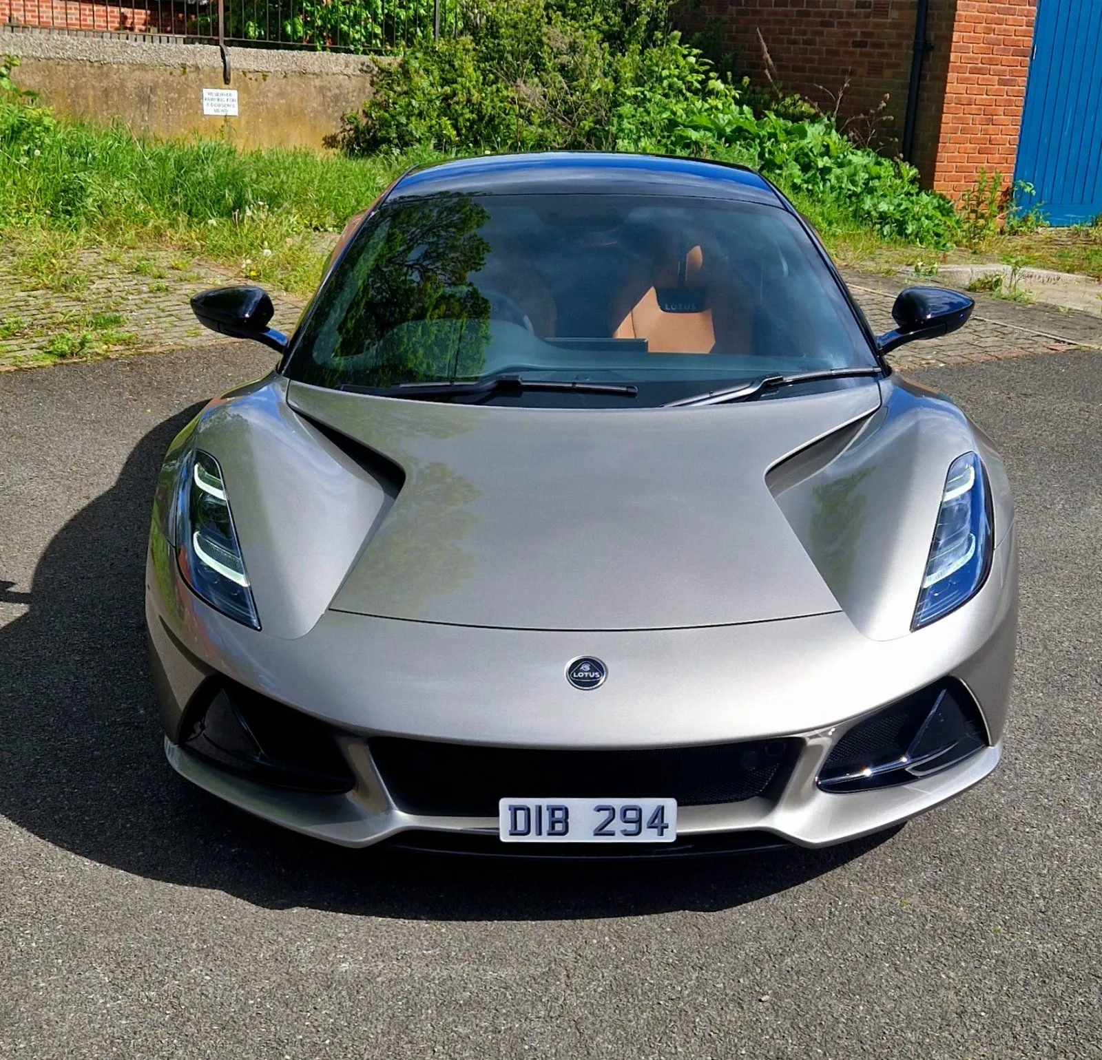

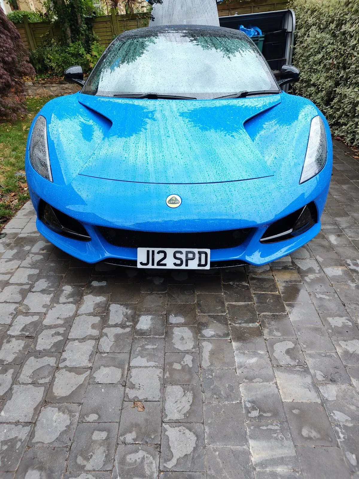

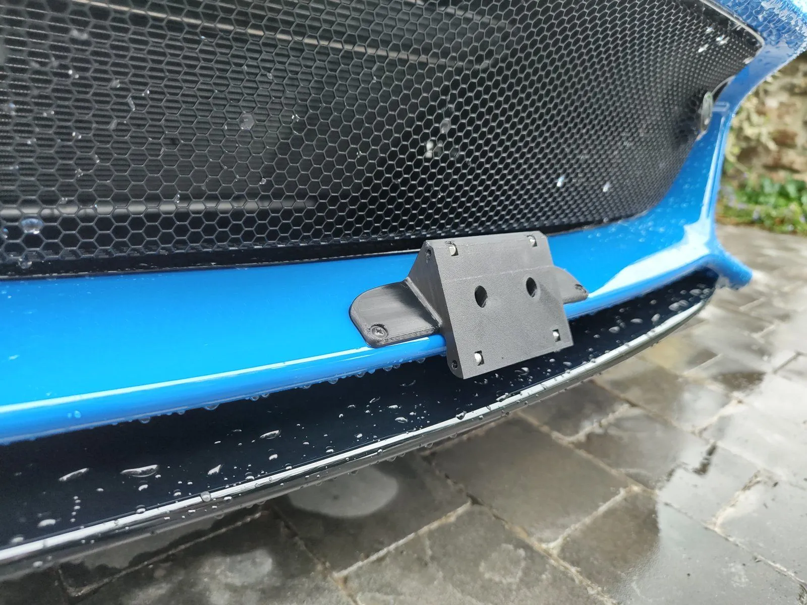

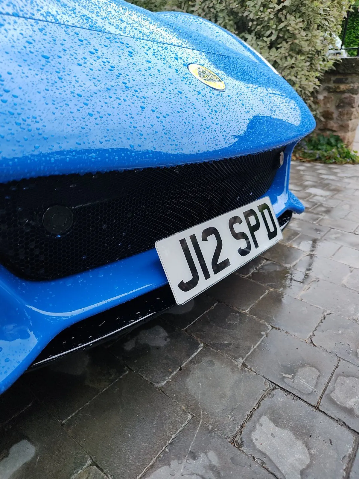

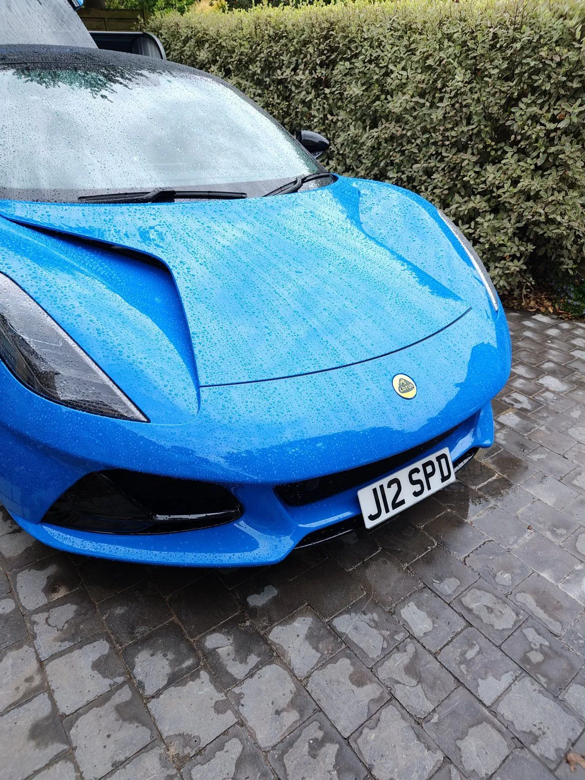

So for a while now I've been pondering about mounting the front number plate at a slightly leaned back angle, rather than on the original plinth that came with the car. Wondering if that might lessen the impact of the front plate.
I have a 3d printer to hand so set out to design and build something to try out my idea and see how it looks.
This is the result

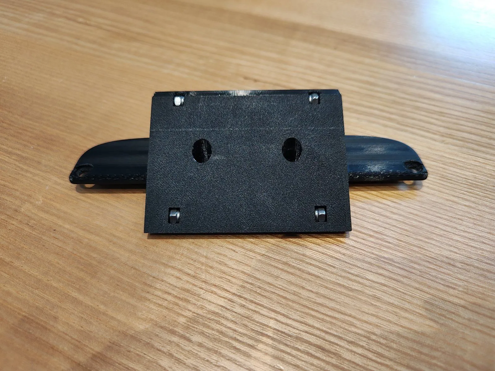

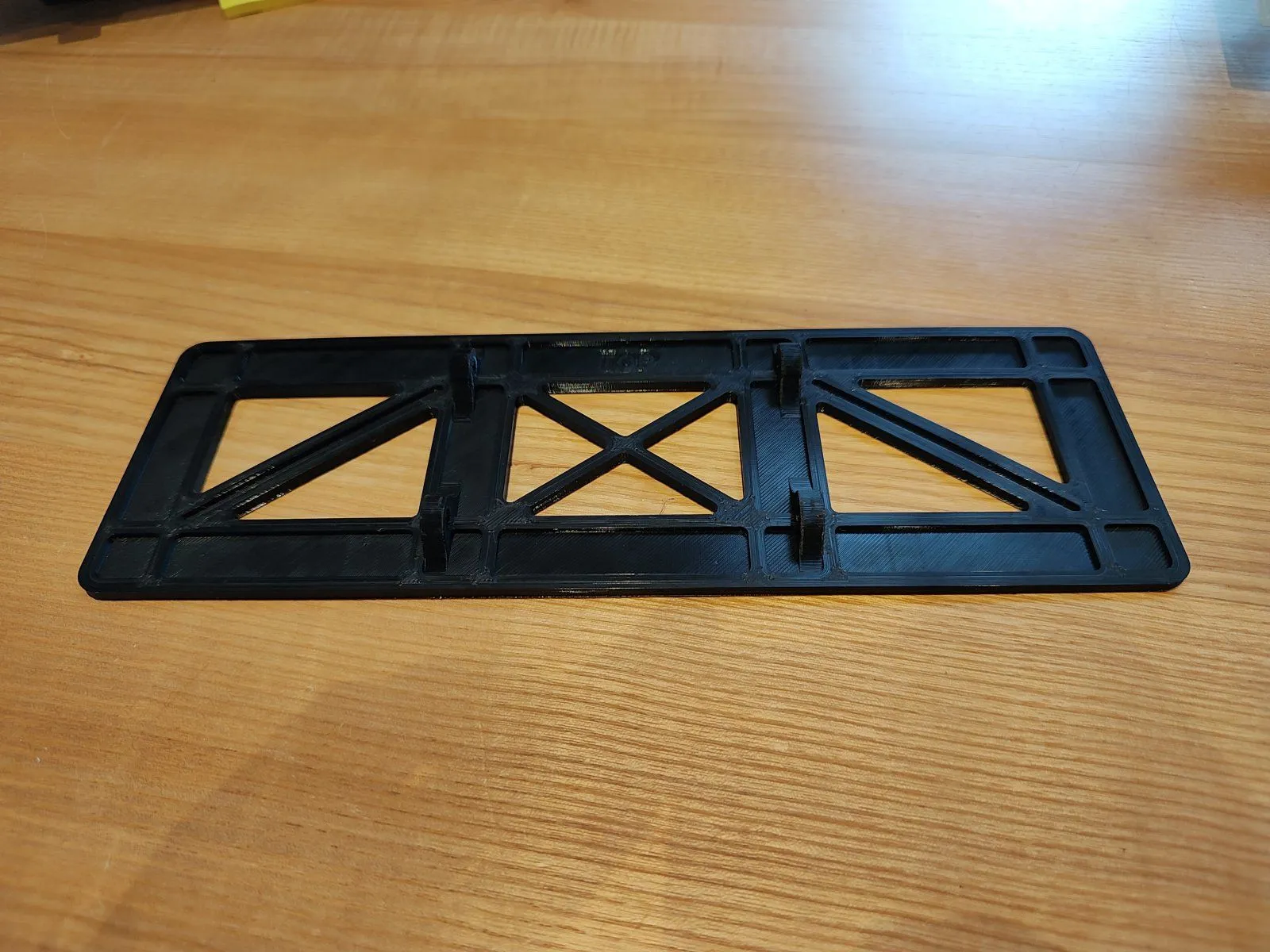

After a few trial runs, I managed to get a pretty good result for a new mount to go on the car, and, with some TPU to hand also printed a gasket for it to soften the plastic against the paintwork (or PPF in my case)
To this, then attaches the actual number plate mount itself, which was printed as a separate piece and screwed onto the sides of the mount piece using some M4s and nyloc nuts.
I made it in 2 pieces one to make it easier to print, and 2 so that you can make sure you line up the plate on the plinth correctly, much easier when not on the car!
I think I quite like the look of this, but have had mixed opinions from others, my partner commented it looks like it's fallen off 😅
I'm curious, has anyone else been thinking about doing the same? What do people think?
I plan to live with it like this for a bit and see how I feel, initially I think it's great, but it may wear off and I may go back to vertical 🤔
Oh and btw, this adds 180g of lightness compared to the original mount 😉

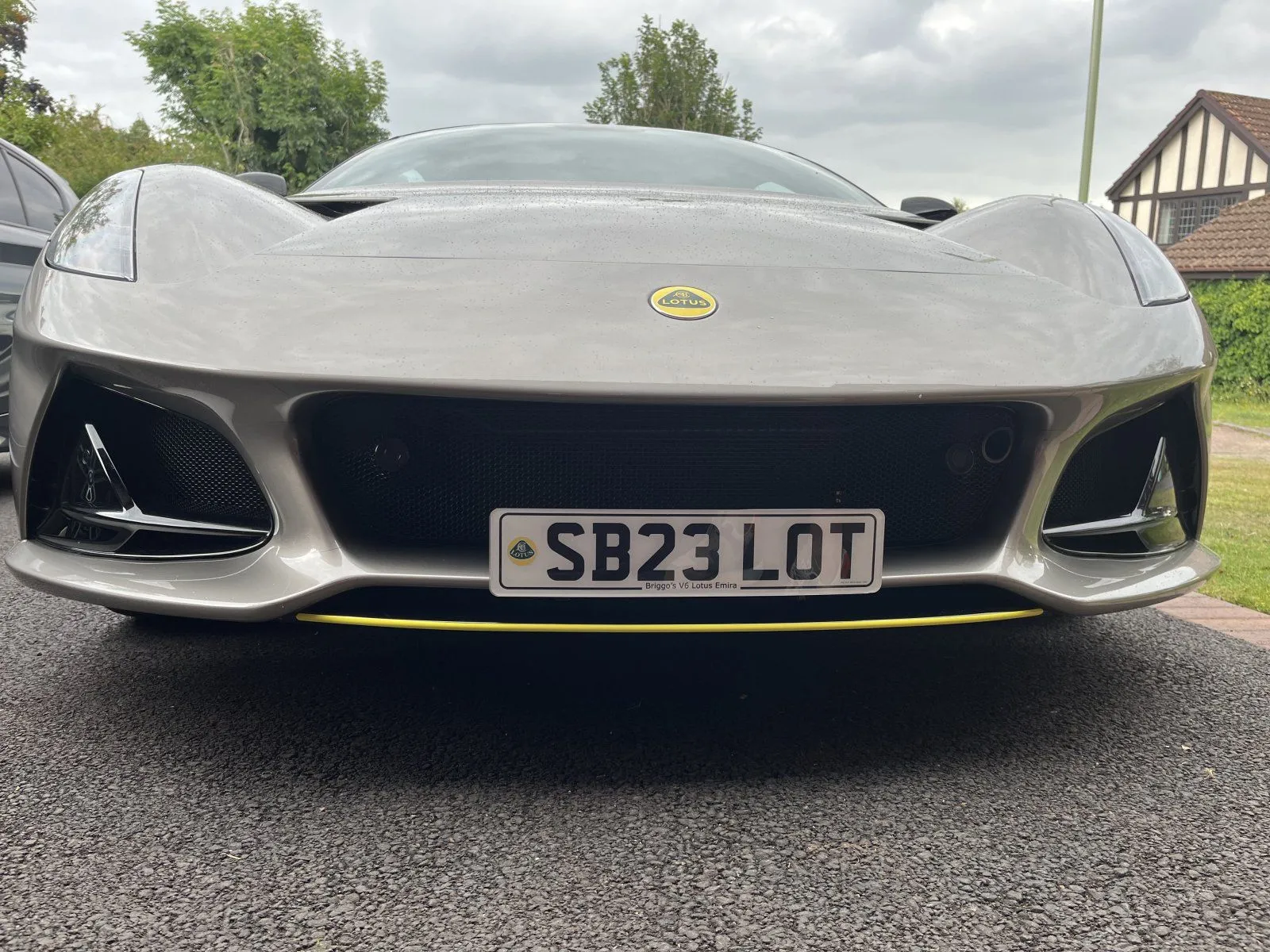

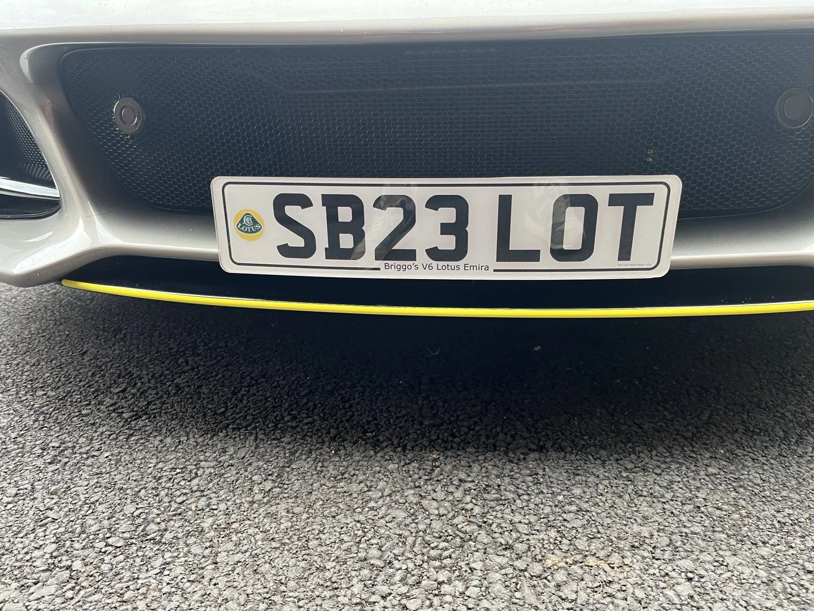

I added a smaller front plate (16” x 3.5”) which looks much better! Had to trim a bit off each end of the backing plate to accommodate!

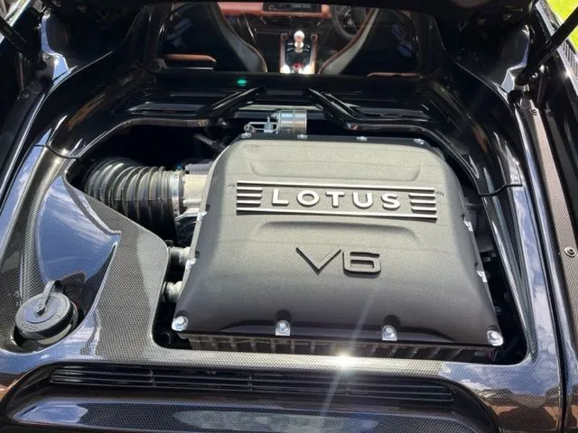

And here are the pictures of the carbon dipped engine surround

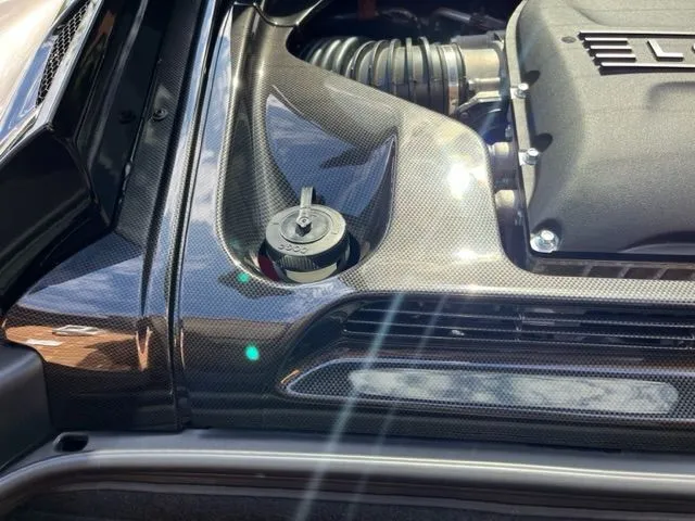

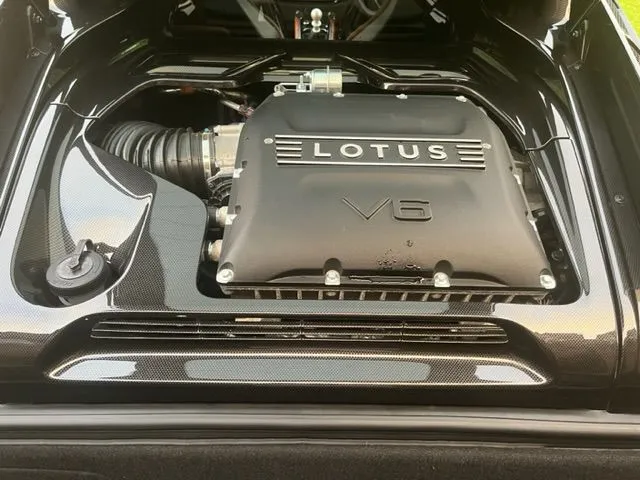

UPDATE - engine surround now carbon dipped and refitted. Very happy with the result!
How is the dripping holding up with all that heat? Looks great! where did you get this done? I see you can get Carbon parts now.
Would like to find someone local to hydro dip mine. Anyone know a shop in the St. Louis area?
The parts are already very light not sure I would save a lot of weight by buying actual carbon. I do like the look.
