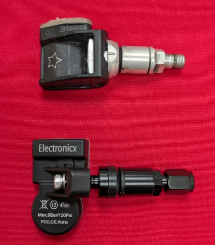

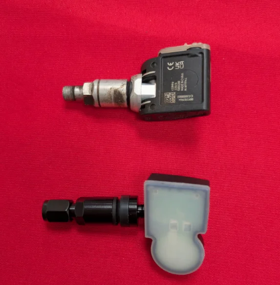

I saw these sets of TPMS on eBay the whole set of 4 are £75 - about the price of a single OEM TPMS from a dealer. So I figured they were worth testing as I was changing my tyres anyway.
They are sold as coded for the Emira. You can also chose the colour of the valve stem possibly to match your wheels - a little bonus.
They are quite different to the OEM ones. But appear to be well made - probably better made than the OEM ones, with metal valve stems and metal valve caps. The brand is Electrqnicx - really pushing that sensational spelling there - but this is a German firm which tends to suggest these are of German manufacture. They come in a German labelled box but with English instructions.
I had them fitted and they are working with no issues - the Emira picked them up after about 10 minutes driving - also inflating front wheels they picked up the changed pressures again after 10 minutes of driving. No recoding needed. Obviously I can't vouch for how long the internal batteries will last but for the price seem to be decent.
Here's a link to them on eBay --> https://www.ebay.co.uk/itm/286783007237
Front and back pictures - OEM TPMS top and Electrqnicx TPMS bottom.
