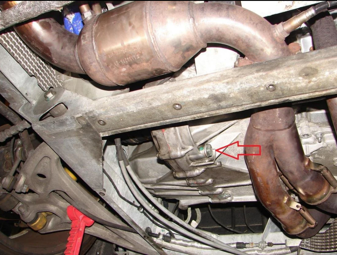

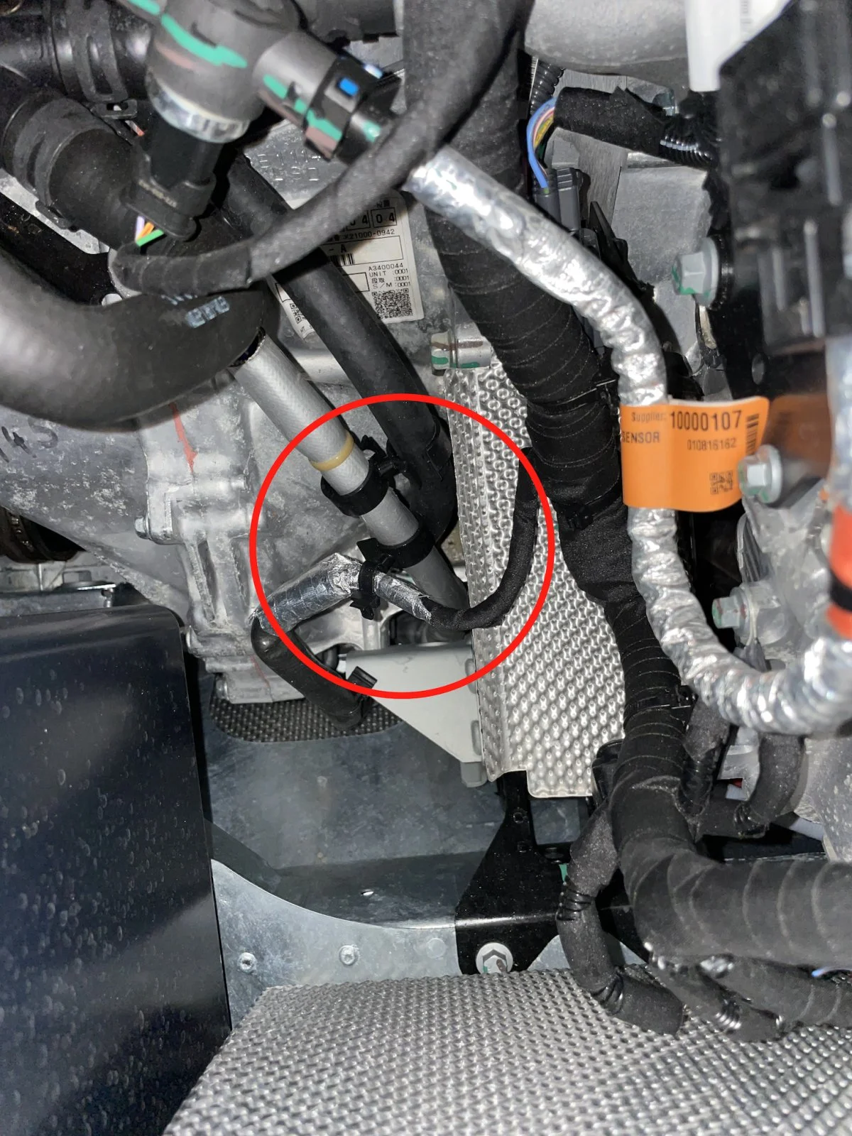

I'm pretty sure what I have will do that. I just need to find out how to replace the oil! Since it's the same trans that Evoras had, are there any Evora owners who know where the drain plug and refill hole is? Maybe I can pose this question on Lotustalk, there are a lot of Exige and Evora owners on that forum.
Drain plug from an Evora:
Fill port is at the top:
This thread has info on fluid replacement in an Evora, the procedure calls for activation of the trans cooler pump using Lotus software, it’s prob the same for the Emira. Not sure how to do that without it. Maybe just run the car for a few minutes?

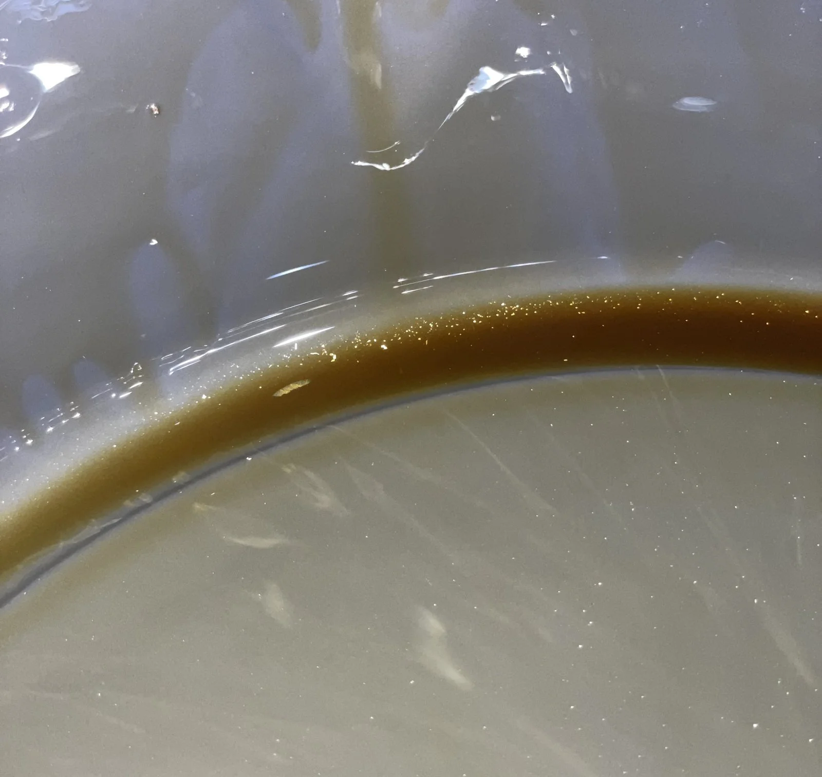

If anybody thinks changing the oil at the 1,000 mile mark isn't necessary, here's the oil from my car. This is what's left after almost all the oil was drained out of the drain pan after it drained out of the car. This is zoomed in of course, but those tiny flecks of metal aren't gold.
For the prospectors!
Anyone keeping the first engine oil in for 10,000 mi is insane.

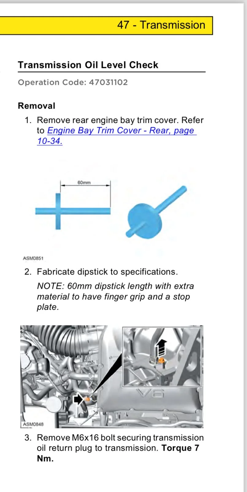

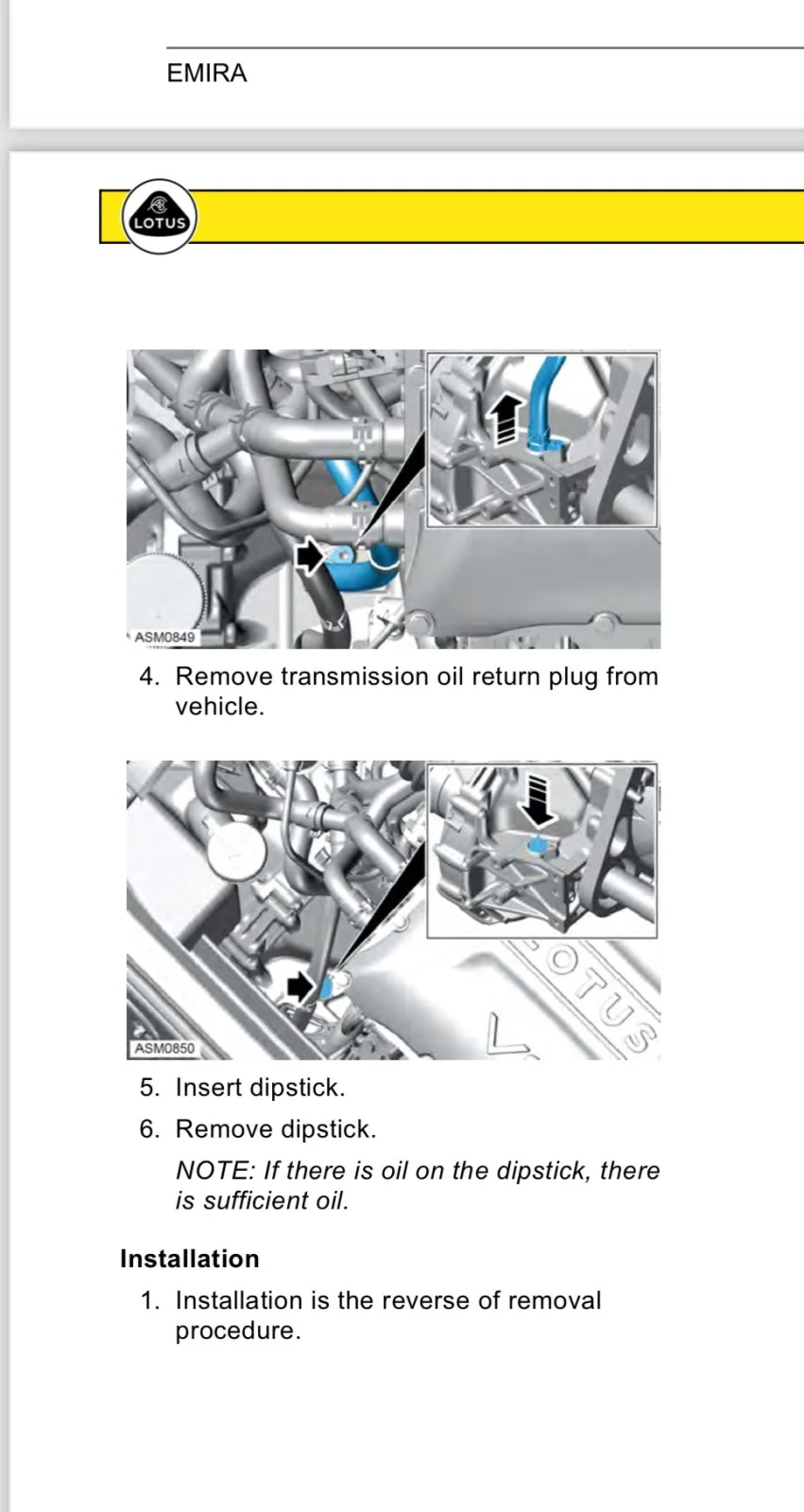

I was going to change the trans oil and put the Archoil in that too, but I just cannot see where the fill hole is. I've looked at the manual, the pictures others have shown of an Evora, and I don't see that. I stuck my phone in down there and took a picture hoping to see things better, but this is what I got. The area in the red circle is supposed to be where the fill hole is, but this looks like a mess. The trans is on the left side of the red circle, the engine is on the right. Even if by some chance the fill hole bolt is under those hoses, and I was able to remove it, I don't see me being able to get oil in there and thread the bolt back in.
What I've decided to do, is let the dealership do it. I need to get that water proof cover for the resistor in the front of the car, and I think there's one or two software updates the car needs, so I'll just plan a trip to Salt Lake City and have the dealer do the trans oil change at the same time. I already have the oil (Redline MTL GL4 75W80) and Archoil I need, and the crush washer for the drain plug should arrive tomorrow, so it's just down to the labor.

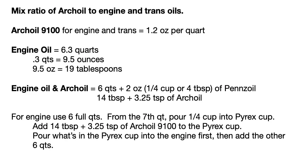

After contacting Archoil and telling them what I had and wanted to do, they said to add 1.2 ounces per quart for both the engine and the trans oils. I went to the store and bought a Pyrex mixing cup, and a set of metal tablespoon/teaspoon mixing spoons for cooking to get the measurements. Here's a snapshot of what I worked out to get the mix precisely.

I thought about an oil analysis, but I may be doing 2 more dyno runs, so the cost of this testing process is starting to add up. I'm going to ask the dyno guy if he'll give me a break on the cost of 2 more runs, because I want to do one with the difference of just the Archoil added, and then one with a titanium exhaust which I'm pretty much sure I'm going to get. I want to be able to isolate the actual difference each change makes before adding something else.
Based on what I've read about the Archoil, and my understanding of what the friction reduction will do, I'm guessing somewhere around 5-8 hp to the rear wheels will be freed up; especially if I can get the transaxle done too. Just from the difference I've already noticed with the engine, I expect the trans will be much quieter too once I can get the oil changed.

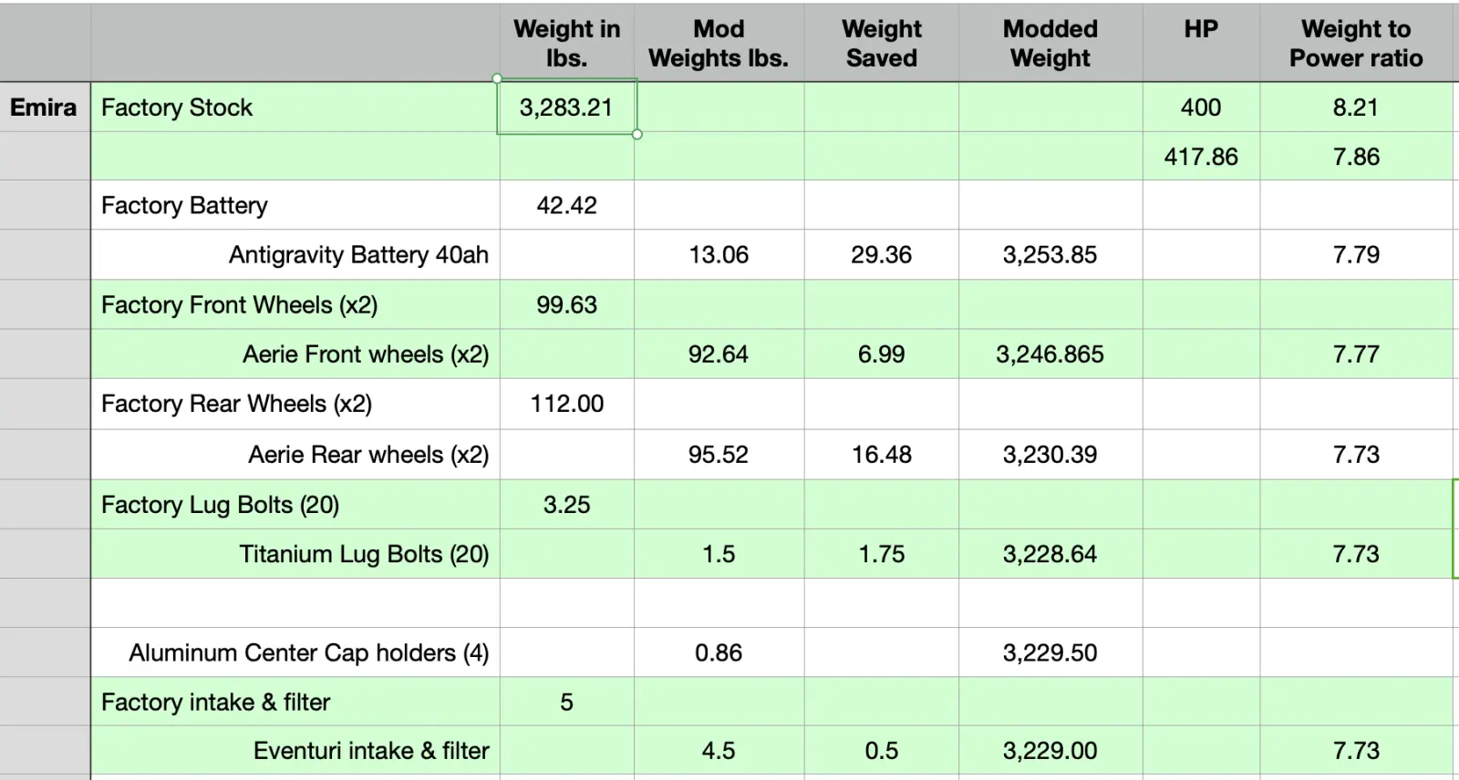

Okay, just got back weighing the car. I went to the place I originally went to where it said the car weighed 3,240 lbs., and after removing 23 lbs with the Aerie wheels, and also titanium lug bolts, I was expecting somewhere around 3217. I put it on the scale, and it said 3,240; exactly the same as before. So now I'm questioning the accuracy of this scale. I started calling around, trying to find a performance/speed shop that can do corner balancing, which would mean they have a race scale, and nobody does. I even called the Porsche dealer who said they don't do anything like that, which really surprised me.
Finally, the last place I call which was a tuner shop, the guy said he didn't know of anyone that had a scale, but he said the guys they get that want tunes for their performance cars, even dragsters, say they go to the local dump and get their cars weighed there. The dump will say they don't do that, give you a weight ticket to go around and get the gate to lift so you can leave, and there's a weight stamped on the ticket, and they don't charge you, so that's what I did! After getting the ticket, I came home and weighed myself with everything extra I had with me (keys, wallet, watch, cell phone, etc.) and after subtracting all that, the car weighs 3,229 lbs. This is with a full tank of gas.
Forget that first weight of 3,240 lbs I posted earlier in my thread. I'm just abandoning that as being inaccurate and unreliable. Based on what I got today, here's the revisions for the original stock weight, and the new W/P ratios. I'm now estimating the original weight was 3,283.21 lbs which seems more familiar to weights I remember reading from other sources. I was able to calculate this knowing what the weights were for the mods on this list, and adding them up with today's weight of 3,229 lbs.

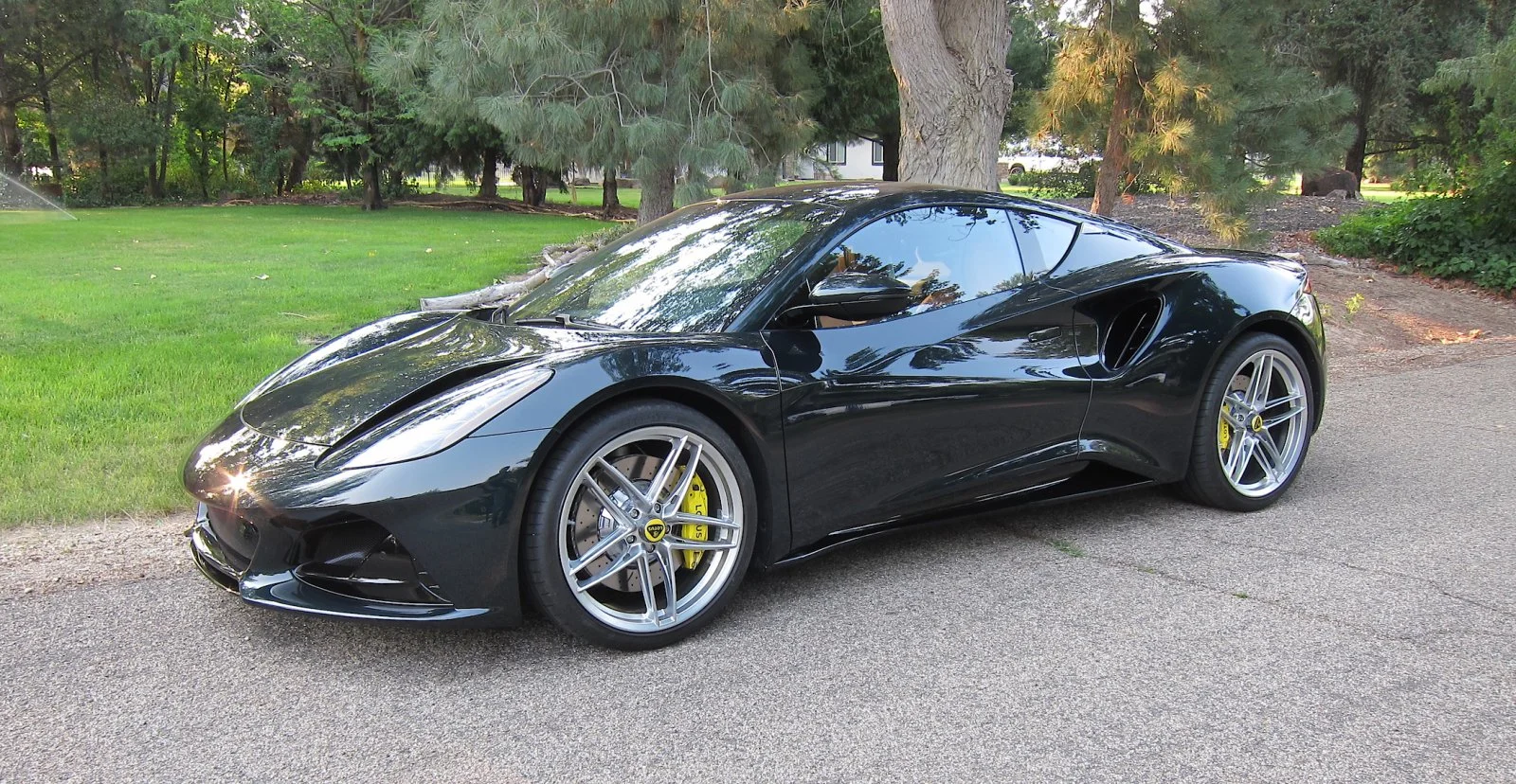

I also stopped to get some photos, but unfortunately we still have smoke in the air from all the fires around the Pacific Northwest. As a result, the light is a gray yellowish color which is not the best light for photos. At any rate, here's a couple shots that show the new wheels I had @Aerie make for me. I think they turned out pretty good!

Thanks to the atmospherics, it's now Shadow Grey
Love those @Aerie wheels. They look very Ferrari but not quite which is great on such a sleek car.
