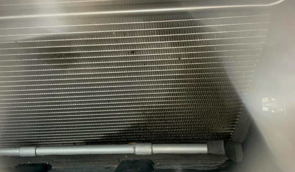

Has anyone experienced their AC Condenser leaking onto the front middle radiator? I've contacted Lotus this morning in the UK and they believe according to this image that that's the issue however made comment:
" I have spoken to the technician regarding the issue and the ‘leak’ looks like is coming from the A/C condenser.
The technician has asked if your aircon works fine specifically on the maximum cold setting.
If it works fine and is very cold then there is most likely no issue but I would advise monitoring it.
If the aircon is not cold then there would be a leak in the condenser.
We also cannot guarantee if that would be covered by warranty until we investigate it."
Now I would assume that even if it 'works' that the leak is not correct and a fix is required under warranty?
Dec 2022, 2300 miles.
