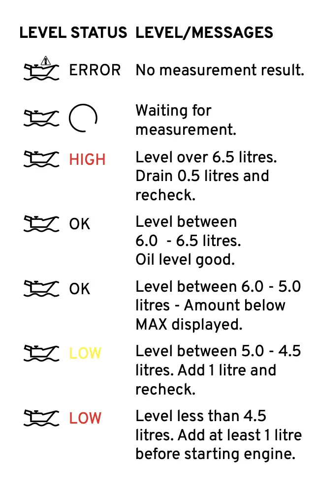

Notification, I4 has no accessible dipstick, if at all?
Critical to understand the exact message you're seeing.
These all mean different things.
I'll tell you my i4 came with a status of "OK 0.3 Quart below MAX".
The owners manual can be confusing because they reference liter but the USA cars display quarts.
If your car is showing "LOW" then definitely add that oil.

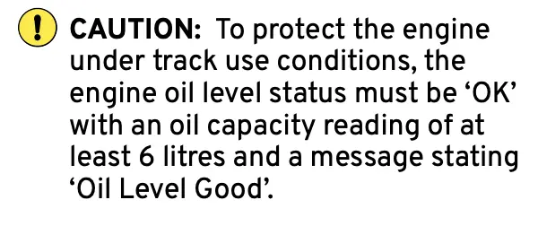

Additionally if you're going to drive your car hard in motorsports...
