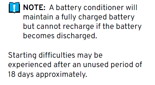

You say after over night on the tender the problem goes away... just as a wildcard guess, try putting the battery on an actual battery charger, not a tender, and give it a full actual charge instead of a maintenance trickle charge. See if that fixes it.
Good advice for all late-model year cars not driven daily. I learned this from the Emira manual, which helped me find my other cars kept on maintainers still needed a good deal of charging.
Yeah, thanks f
Thanks for the advice, I do drive the car daily. I just keep it on a tender every night in case I go out of town or otherwise have an unexpected period of not driving the car. I’ve seen that the car is sensitive to battery state so just try to keep ahead of it with the charger. I don’t think it’s ever gotten low, unless it did during initial shipping/delivery before I owned it.
I’ll check the battery again to be safe, but I believe the dealer has checked it as well. Strangely enough the car didn’t actually come with that Ctek charger. I’m using a Noco Genius 5. Not sure if it has the function you’re describing.
I took the car out yesterday and the light was gone, so can’t help but think it’s either a) some sort of momentary issue with the sensor that the car is sensitive to, or b) a software issue.
The Noco G5 is just a trickle charger, so no, not a battery charger.
