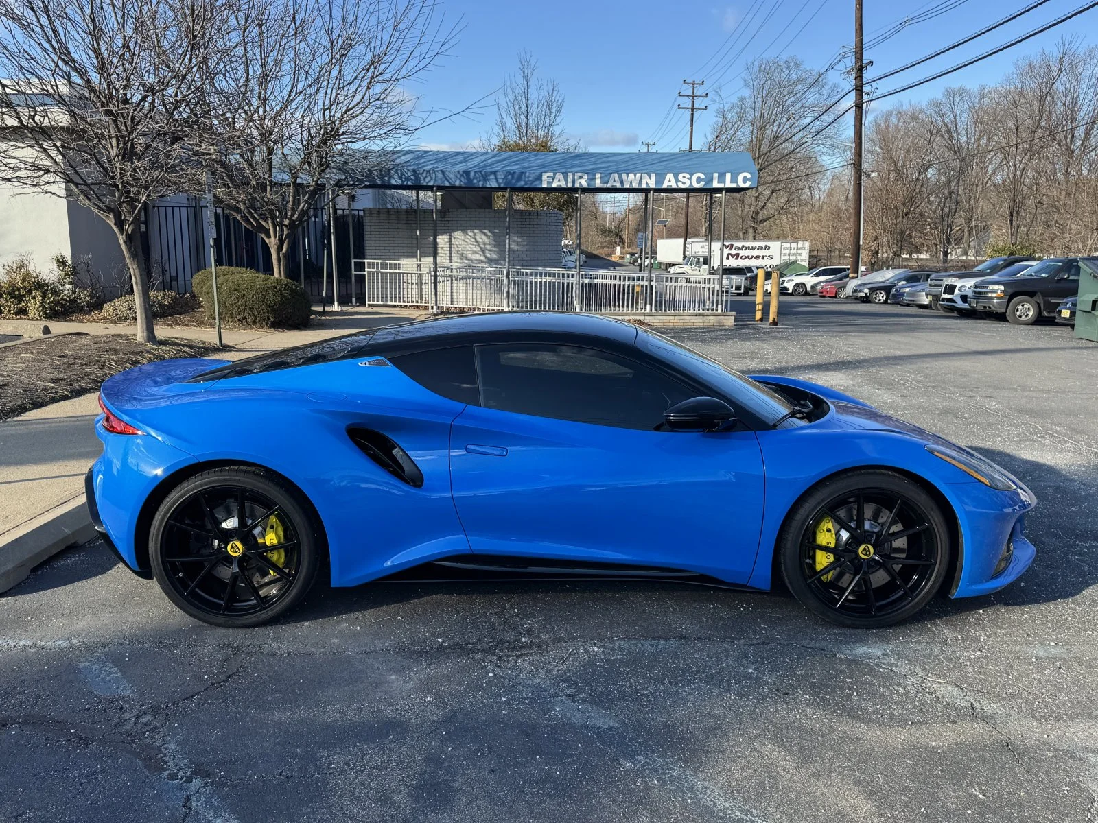

Update:
I dropped my car off last Thursday and picked it up today (8 days at the dealer).
Dealer called me last Thursday afternoon saying he had never seen that code or message before (code P223d). Contacted Lotus for support. They instructed him to replace O2 sensor.
He said there are no recalls on my car (built September 2024).
I asked him why would washing the car cause this problem and if it can happen again? He said he’s not sure why it happened but doesn’t think it’s going to happen anymore. We will see.
The weather is cold and crappy here in NJ but boy did I miss driving this car. I love it! Can’t wait for better days and to finish breaking it in. Almost there!
