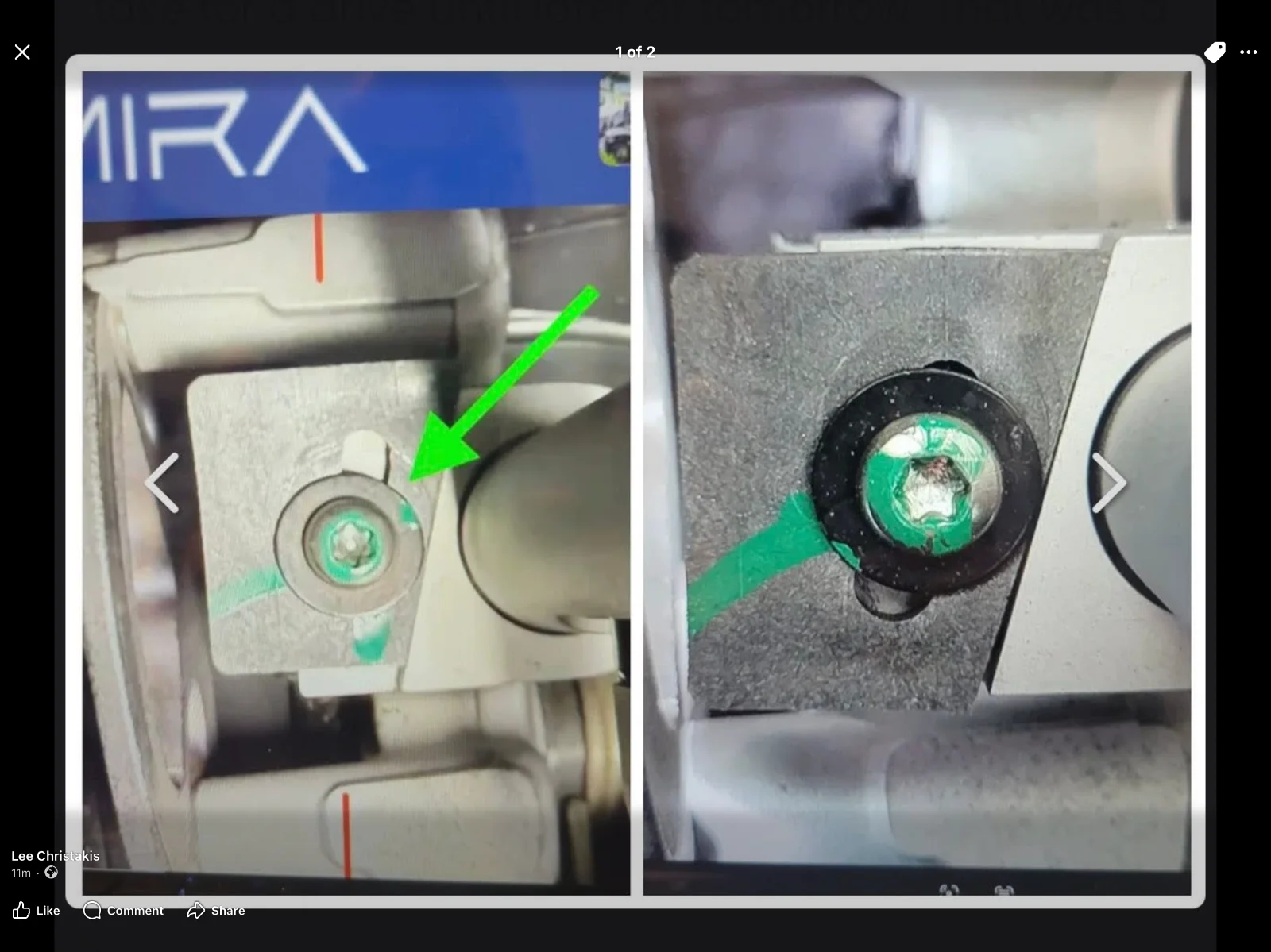

Jeez, warranty runs out on the 6th January and the gearbox refuses to engage 1st, 2nd and reverse!
Has anyone had a similar issue, if so what was the solution? V6 manual.
The gears you’ve mentioned are the ones that a lot of people have had issues with and can be fixed by adjusting a plate under the shifter boot. I’d ring a Lotus garage first and get the issue registered ASAP before your warranty runs out. You can then decide to have a look yourself (the adjustment is pretty easy) or get a Lotus healer to look at it.

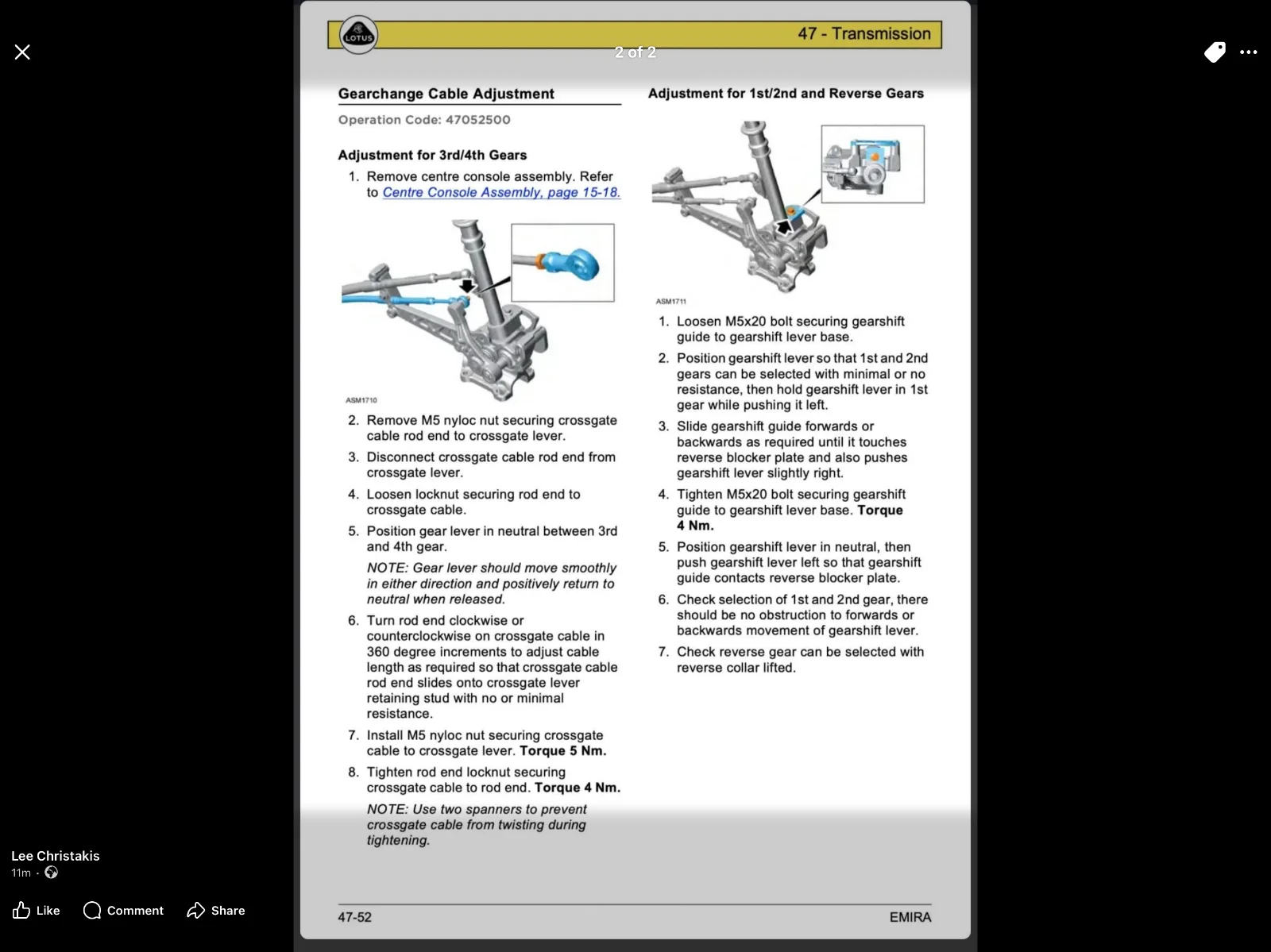

Do you have a link to how its done?
Thanks, I looked at that and missed it.
Do you have to remove all this out? Are those screenshots off Instagram?
I didn’t need to do it for mine as a Lotus tech did it when my gearbox was replaced. I know a few people on here have done it, so I’ll let them comment.

Looks like it could be a simple task to get to the bolt in question.
