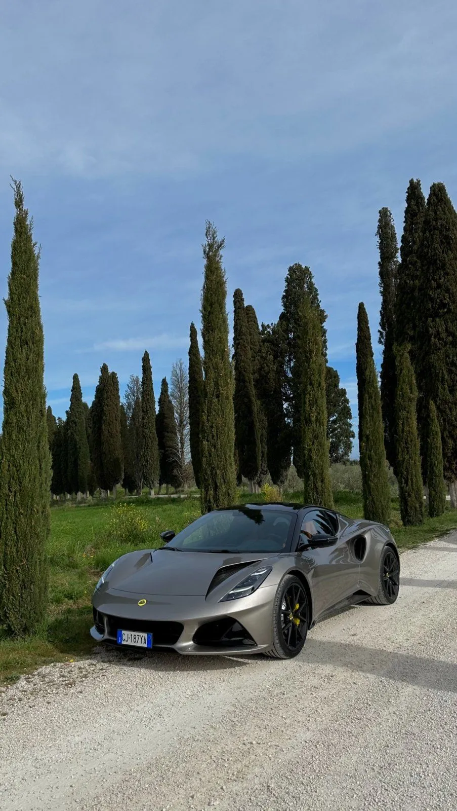

Thanks in advance for all the helpers! and added a picture of the beauty just for good measure haha
