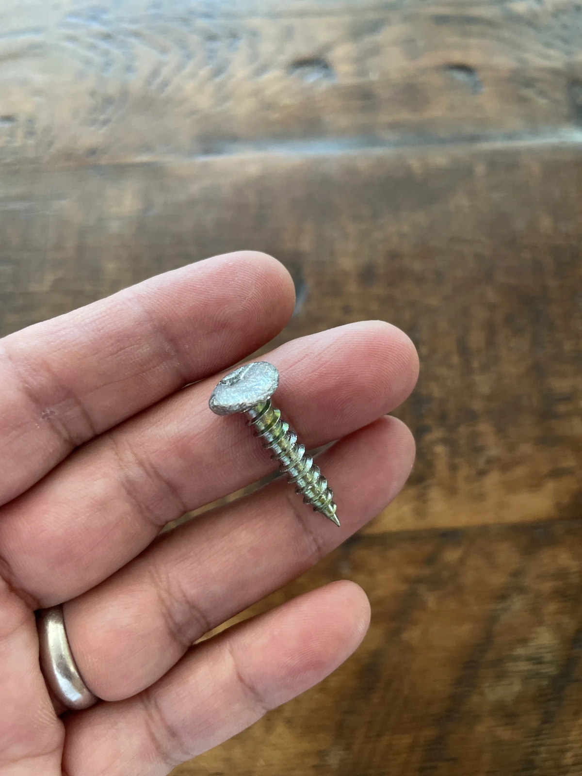

After my enjoyable cruise I come home to find a completely flat tire. Nail in the center of the tread.
Normally I take it and get a patch. But since I can’t drive it I’m thinking of finding a mobile tire repair and just do a tire plug without removing the tire at all. I’ve never had an issue with a tire plug. Maybe then get a patch later if I ever planned on taking it to the track.

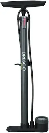

I just looked it up and it looks like you can inflate the tire using the tire compressor without using the sealant. Thank you for the tip!
