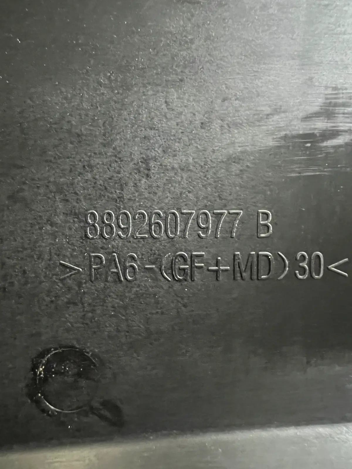

Yep. See part number here. You can give that part number to your dealer and they’ll order it for like $40. Or just order it from bell & covill in the UK.

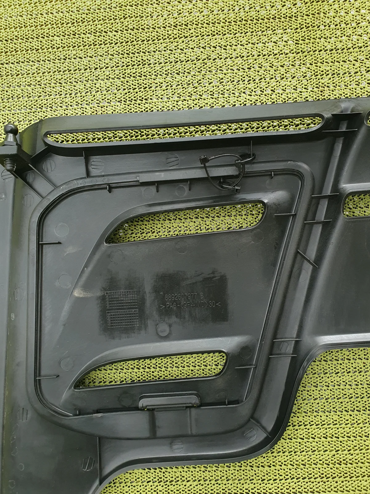

So interestingly enough in my stuff included with the car is a clear zip tie in a bag. Anyone know what that is for. I'm thinking it may be to attach this panel.

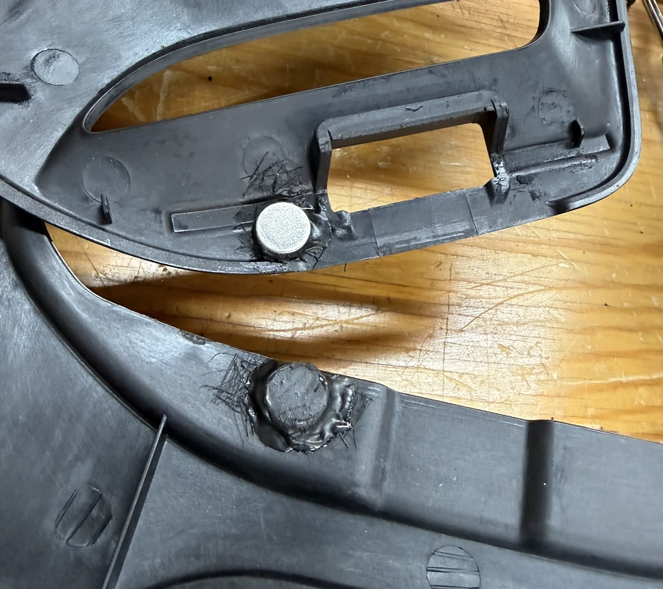

I broke the clip that latches the cover in place. Not a very good design when it relies on a thin plastic area to bend (without breaking). I put a zip tie to hold it in place, but since you can see that through the engine glass, I didn't like that solution. I came up with a bunch of complicated ways to fix it, then came up with a simple way. Epoxy a small round magnet to the underside of the removable panel, and also the underside of the main piece. The small rare earth magnets are strong enough to work though the plastic on the main piece, so nothing shows.

If you are going to do this, put the magnet on the hatch cover first and let the epoxy set. Then tape the cover in place and put the other magnet on. You'll see that the 2nd magnet will align with the first one by the attractive force. The magnetic attraction is enough to hold the cover in place, and it sort of also self-aligns.
